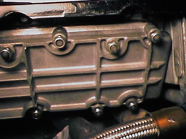

You could always put paint marks on TDC and at the timing advance mark by using the opening on the engine tin over the flywheel while using a mirror to check the pulley with the engine off. Then use those for checking the timing in the future.
You need to shave down the ribs on the turbo covers to clear the rear suspension ears if you upgrade to them. I'm enclosing a picture to show the shaved ribs.
BTW, I see you're in Chicagoland as well. We have some great 914-6 shops here in Illinois.Attached Image

George, Thanks for the picture. I didn't even think about the clearance issue with the 930 valve covers. I'd love to hear who you'd recommend for 914 work locally. Let me know.

There have been some other answers on here, but basically the 'turbo' covers with the ribs/fins will hit the suspension mounts and won't clear the studs when trying to remove them.
Some people have swapped out the upper studs for bolts, others have milled all the ribs down. Doing the entire cover is not necessary, there is only a section around 2 of the stud holes that needs to be done (have pictures of what I did around somewhere...). Just trying to head off a surprise for you.
