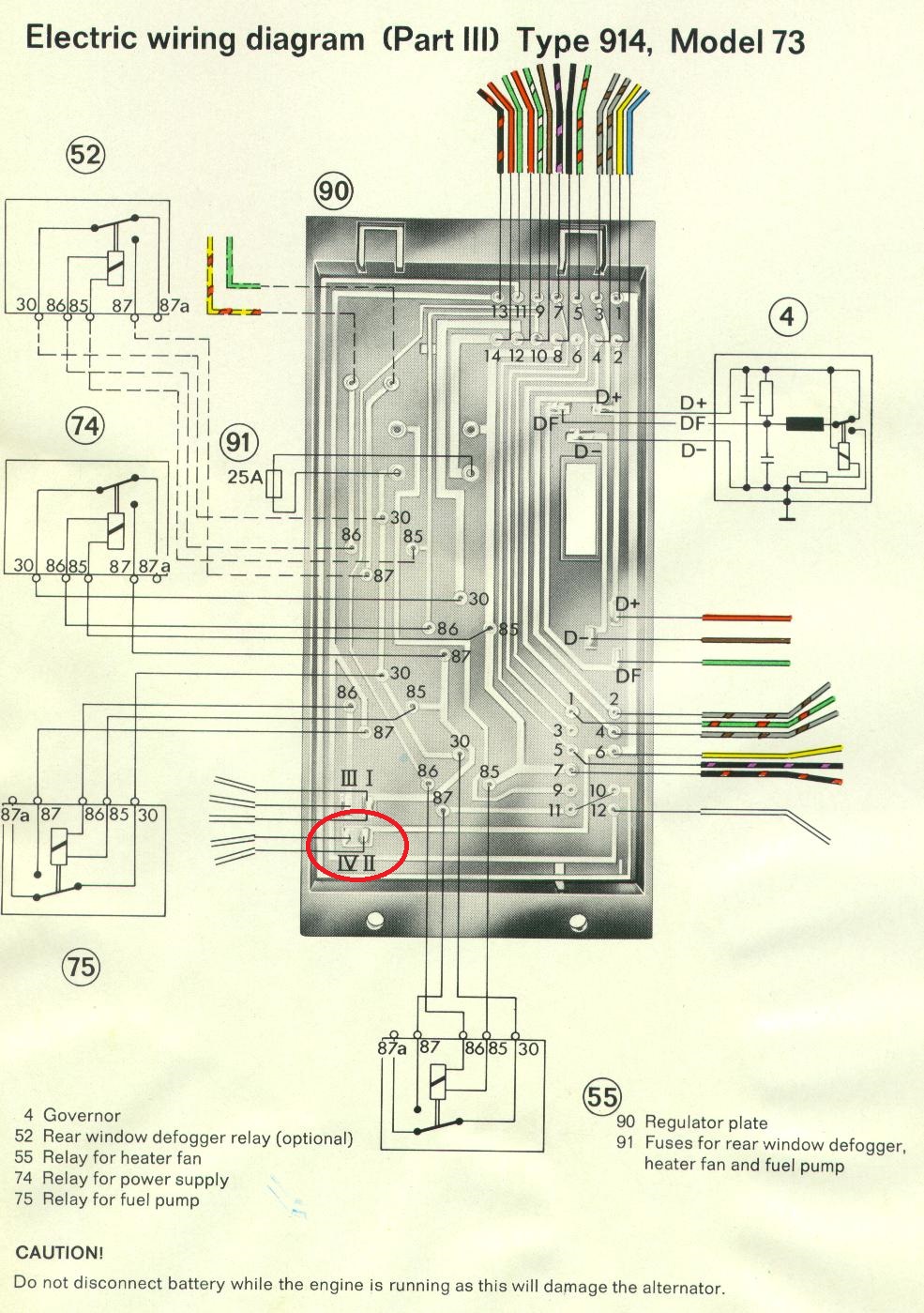

The black with purple stripe wire came to this plug on the relay board. You can also see the gray wire I spliced into it and ran over to the coil.
(IMG:http://www.914world.com/bbs2/uploads_offsite/i304.photobucket.com-11380-1486526983.1.jpg)
(IMG:http://www.914world.com/bbs2/uploads_offsite/i304.photobucket.com-11380-1486526984.2.jpg)

The black/purple stripe wire should enter on the 14 pin connector at pin 7. It continues thru the relay board and exits pin 5 of the 12 pin connector.
You should check the 12 pin connector on the relay board, if you take a peek you will see a black/purple stripe wire. Follow it, see where it goes.

QUOTE(timothy_nd28 @ Feb 7 2017, 09:24 PM) *
Is the 12 pin the one closer to the firewall? That is the one that I spliced on to and ran to the coil.
If not, I will look to see if I find a black/purple wire on the other connector and see where it goes. It definitely wasn't on the coil.
