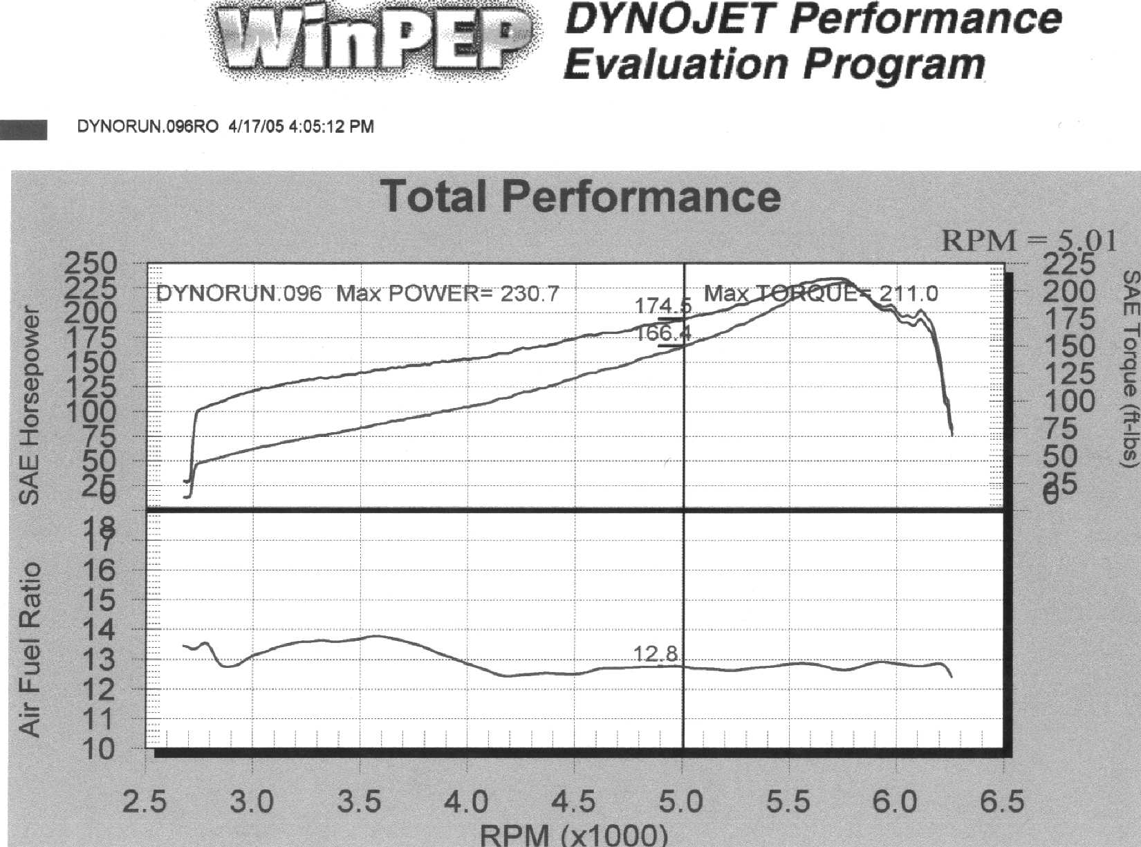

Here is the dyno sheet for the 2054cc engine with carbs.

2054 with FI

The only change was the Carb was replace with the programable FI System.

No Type 1, just showing how with FI you get more power with the same engine.

a T-1 making 230HP???? am i missing something?

No Type1's make alot more power than type4 due to exhaust ports.
This is a daily driver 66 bug.

HOLY COW....don't they max out to 2056 or something.....it's on somebody's site....

turbo?

It doesnt look like a turbo powerband to me. Turbos tend to be less linear. But what do I know, im just a kid.

i would bet that is a 10 k mile engine, i wonder what kind of case strengthing is done on a mag case to hadle that much power.
that motor must be at least 11 : 1 compression

Yeah, I agree with scott. Its probably a drag motor or something running on race gas. Who else would dyno a bug motor? (IMG:http://www.914world.com/bbs2/html/emoticons/biggrin.gif) (IMG:http://www.914world.com/bbs2/html/emoticons/hide.gif)
edit: whoops, didnt see it was a daily driver. power to the nazi road oilers!

I'm willing to bet the difference wouldn't be as substantial on a stock or near stock motor......still a nice improvement.....figure $50 per horsepower if the FI cost $1500.....
no one is saying FI cannot give more HP, but you cannot claim 20-30% across the board on all applications.....
