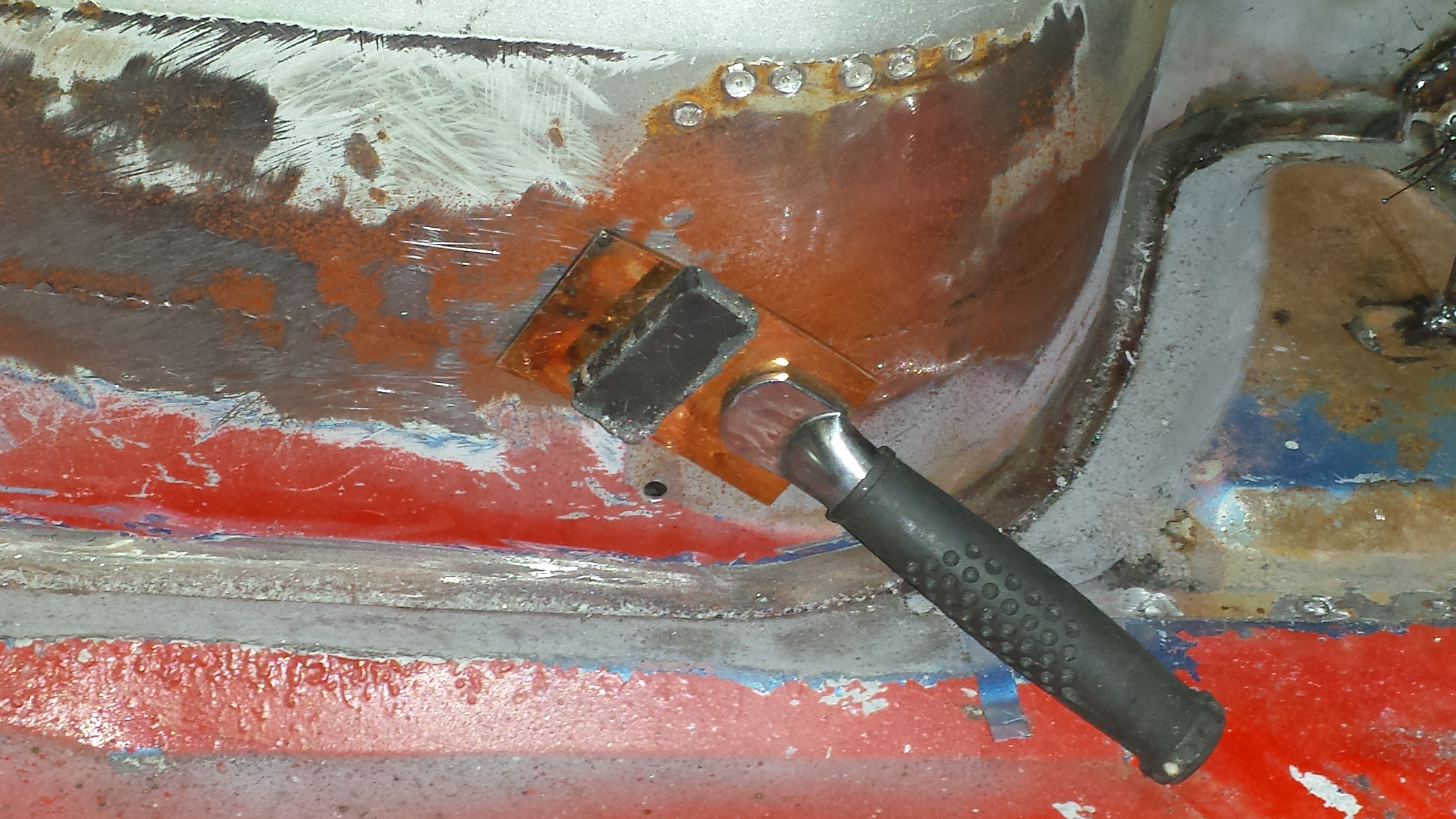

Thanks everyone. I'm feeling much better about this now, and thanks for the compliments! McMark mentioned being able to MAKE good welds out of bad with grinding. The other way to do it is with body filler and I don't want to be "that guy." "That guy" already left his mark in the hell hole of this car which I will have to sort out. But I can't blame the PO because "that guy" was me, 25 years ago! (IMG:style_emoticons/default/dumbass.gif)
QUOTE(Perry Kiehl @ Jun 12 2017, 01:21 PM) *
One thing that will help from blowing through is spooling out about 1/2-3/4" of wire. A copper spoon behind the weld will help too, but often that requires two people.
I was just reading a tip last night about angling the nozzle to increase stickout and reduce blowout. I'll give that a try. Here's a shot of my hillbilly substitute for a copper spoon assistant (IMG:style_emoticons/default/tooth.gif) :
