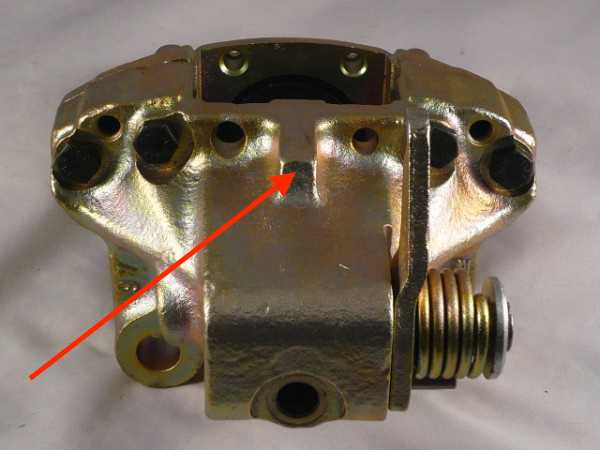

Hi guys,
Can someone tell me/confirm if these rear calipers are for a 914-6?
Thanks,
Bill.
post Aug 12 2017, 08:37 AM
914-6 GT in waiting
Posts: 19,994
Joined: 19-September 09
Member No.: 10,825
Yes
4's are smaller with a "bump"

mepstein, where exactly would the bump be on a -4 rear caliper?
Thanks again for the help in confirming.
Bill.

QUOTE(mb911 @ Aug 12 2017, 10:45 AM) *
QUOTE(mepstein @ Aug 12 2017, 06:37 AM) *
Yes
Pics stolen from PMB website. The only place to get yours restored.
Please note that Mark is our local 914-6 caliper expert as he has his fair share of them (IMG:style_emoticons/default/biggrin.gif)
Lol. No way, just 2% of what Eric Shay knows. Maybe less.
