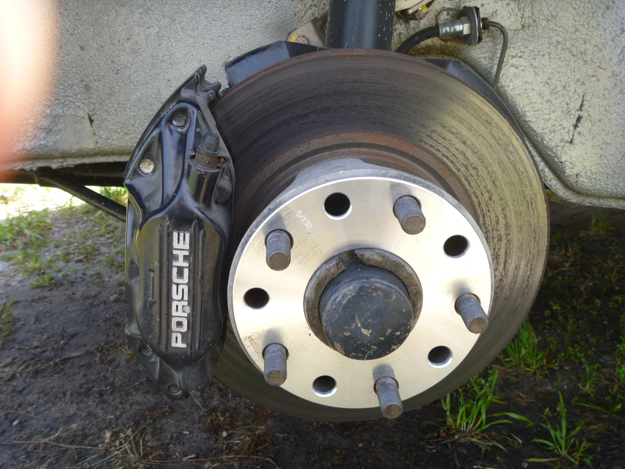

Really to big ,running 19mm with huge brakes ,really too large for what ever brake setup you have,my car stops really well trust me running these on 19mm ATE cylinder;
I have these front and rear ,larger M/Cs are just a what folks talk about like the BS BMW caliper upgrade...waste of $$$$.
Cheers go well.
