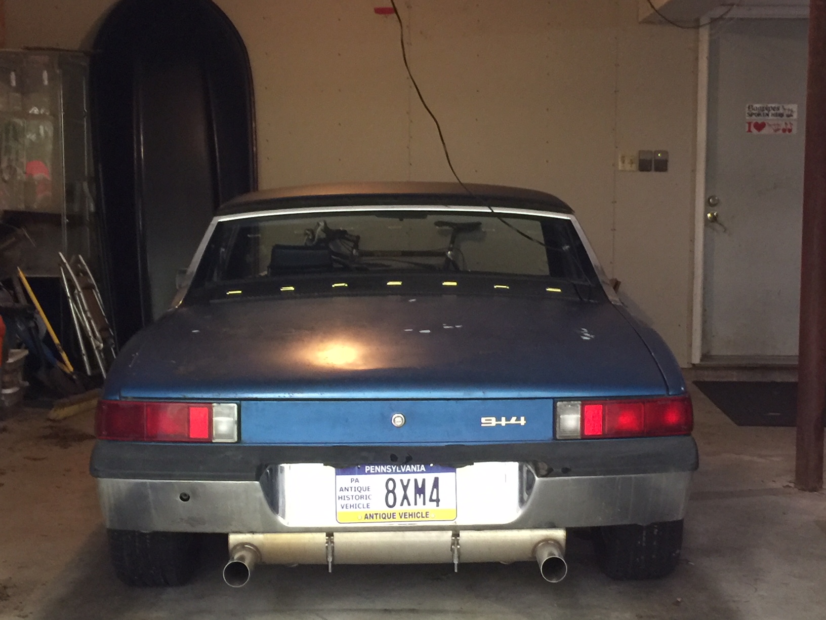

I just put baffles I’m my TT Exhusts RSR muffler. Much quieter. Looks like yours. It is notched to clear the 915. 2000-2400 was extremely loud!!I like Ben’s 2 in 1 out, don’t know if it would clear the trans. Drivability is pretty important.
My 2 in 1 out clears the car I tested it on with a 915. Though that said most 915 cars require extra length to the heat exchangers to clear.
