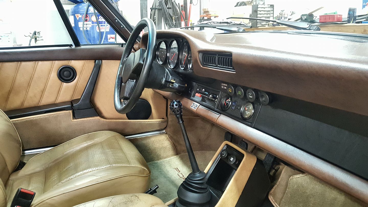

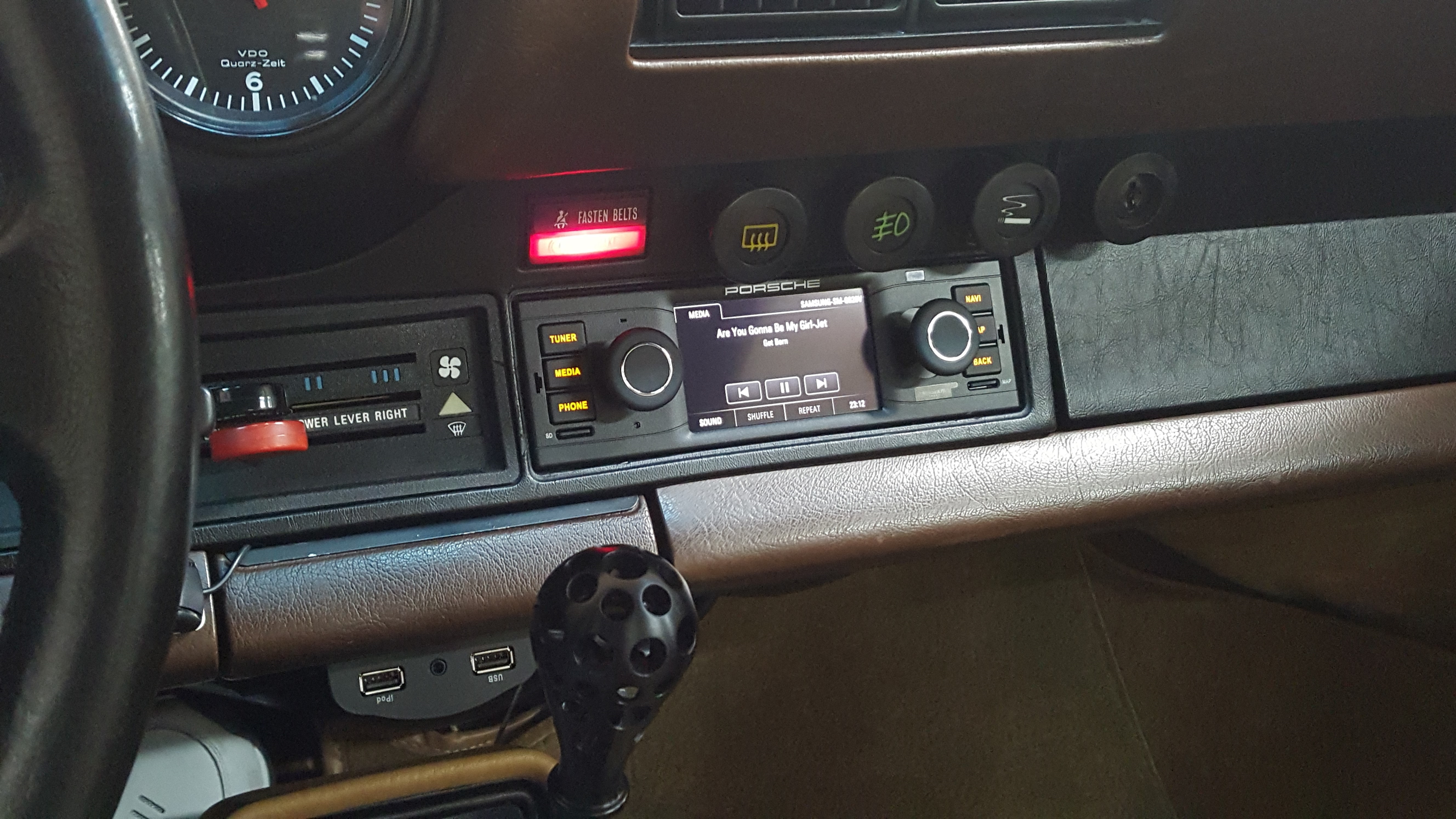

I put a rennshifter in my 911sc, the old shifter needed some new springs.
I got a rennshifter with a taller stick and then put a wevo knob on the top with a threaded insert to make it work. Super tall and I love the hell out of it. I also put all the spring spacers in, maybe it needs it maybe it doesn't.

Better pic. The shifting is way, way better. But what I really like is the shifter is closer to the steering wheel.

Travis I like the longer shift handle. (IMG:style_emoticons/default/idea.gif)

The shift knob is nice as it sits on top of the long shift lever, vs the rennshifter or stock knob that slips over, so I get an extra inch or so of height..
I got the idea from someone who did this on pelicanparts.
