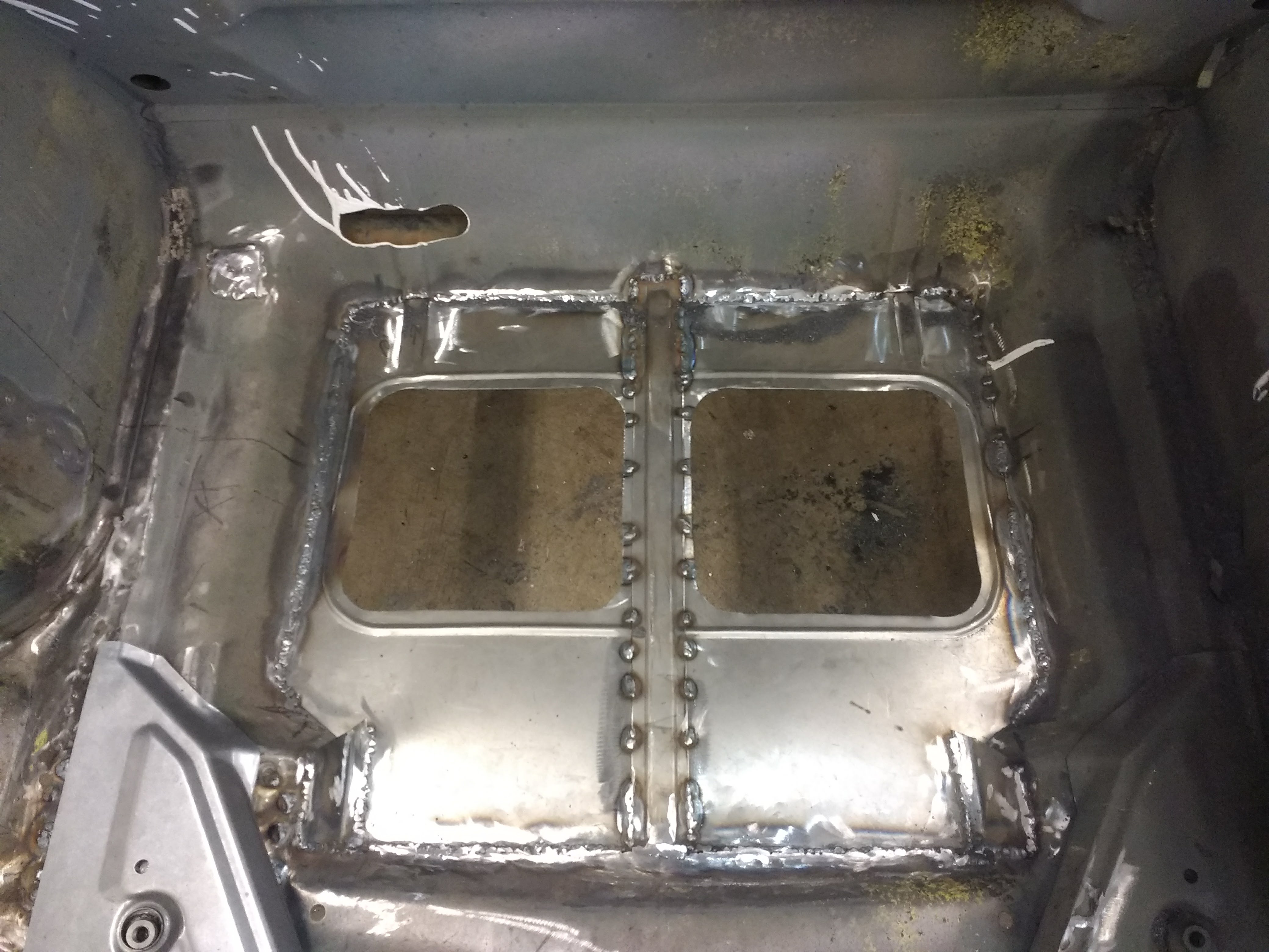

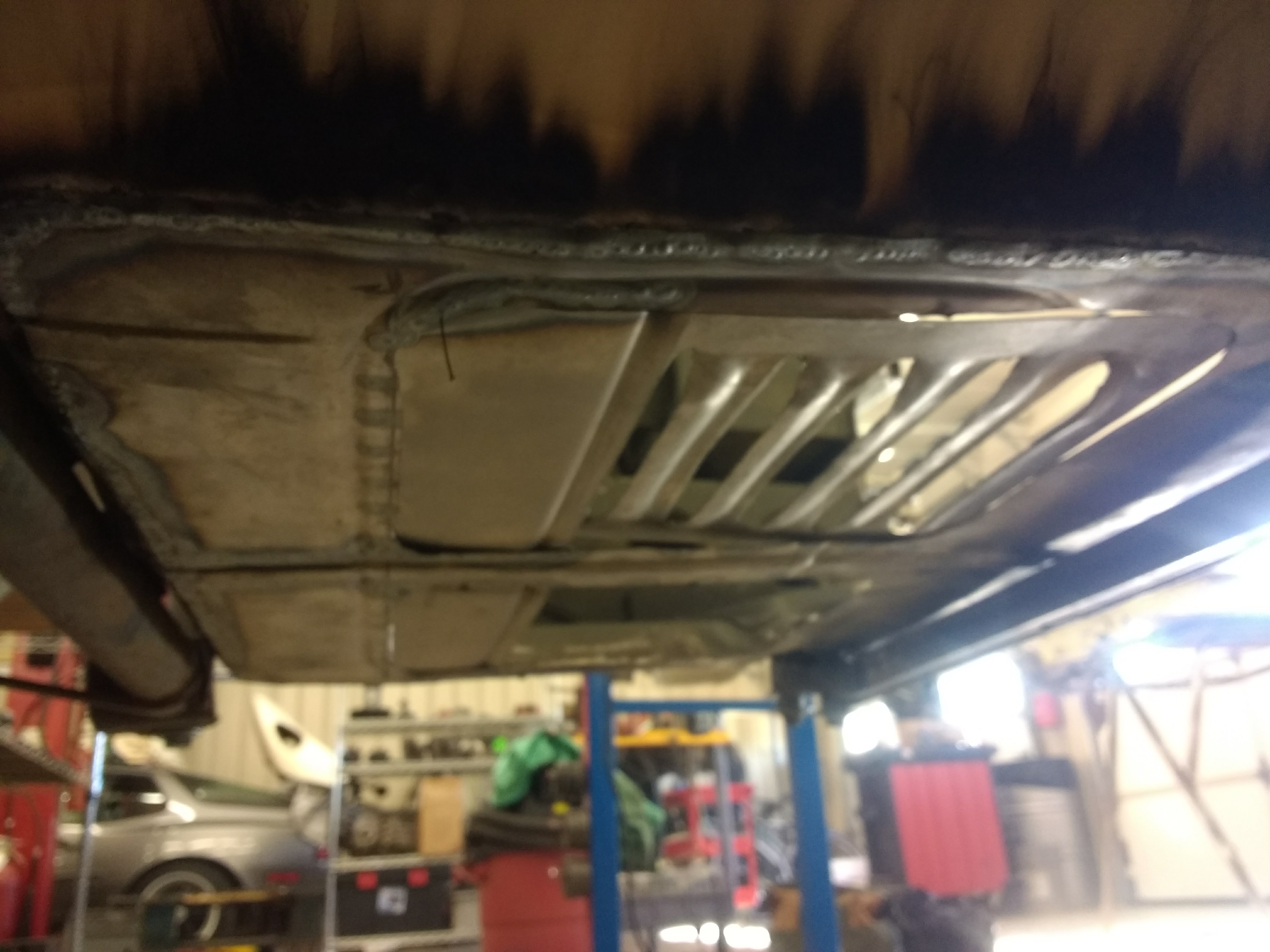

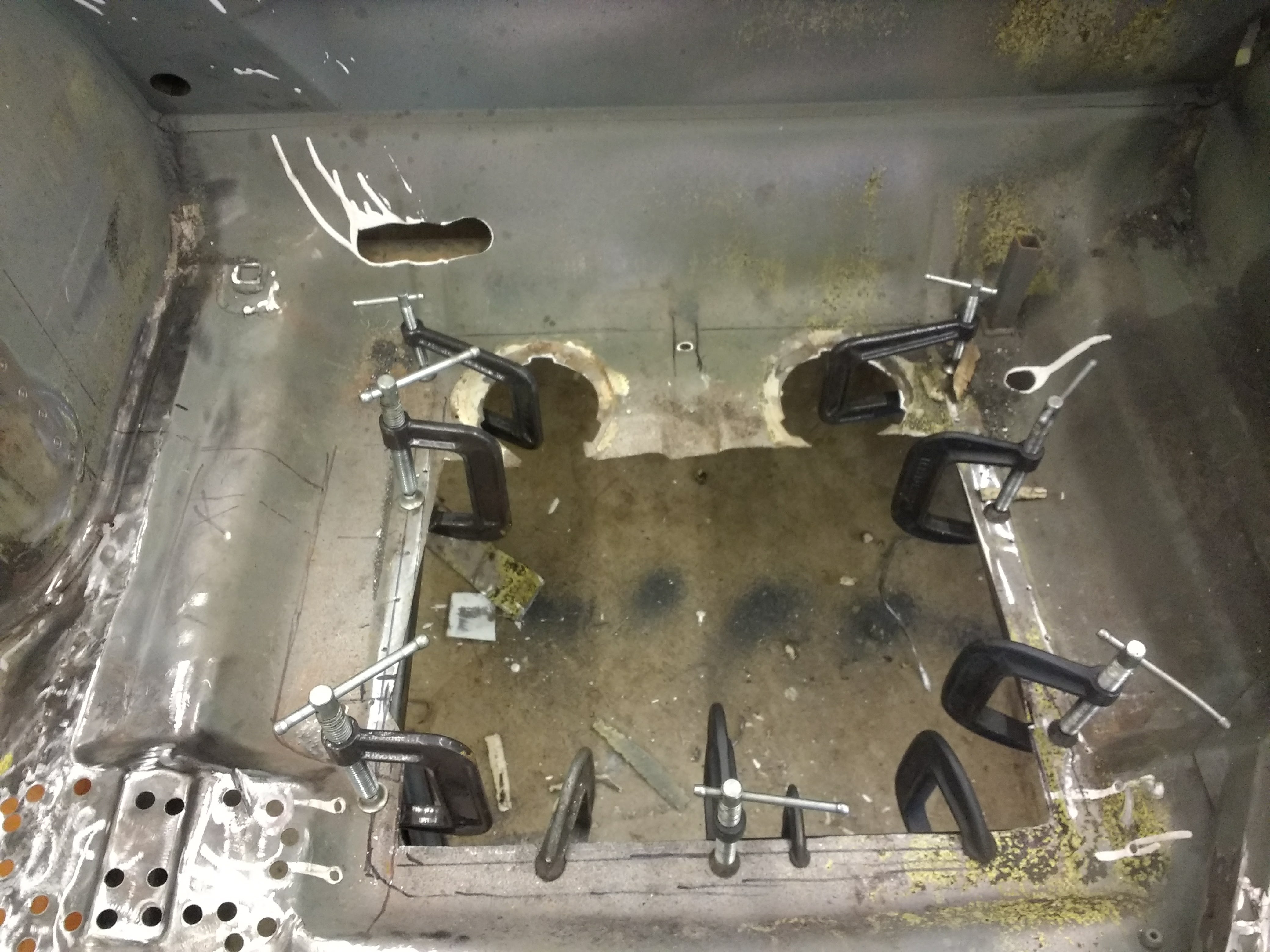

I've already trimmed the sides and front of the gapeing hole cut out by previous owner(s) for oil cooler.
Note the 'pointy' jagged ends at the rear of the hole. I have a lovely hole in on the back of my left hand from one of them where it attacked me through a leather glove.
I'm about to get even, and fix the problem forever.

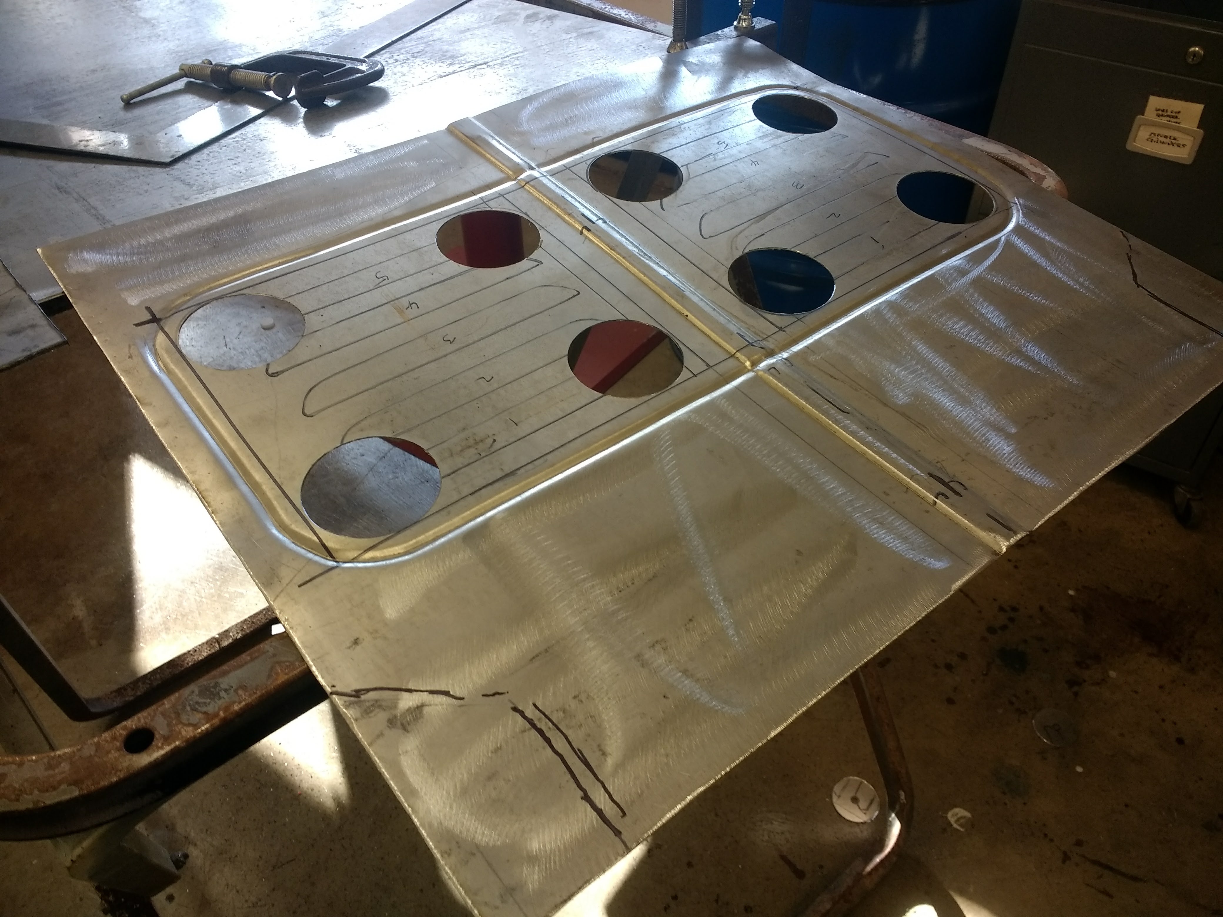

Make a Sharpie layout for the new floor and include area for exhaust of hot air and size of louvers:
Then, cut the radiuses with a hole saw;
Run a 'bead' with the bead roller around the outer edge of the future opening, and roll a step fore/aft down the middle to stiffen the floor;
Weld in the floor after removing the new holes where the future louvers will be welded in.

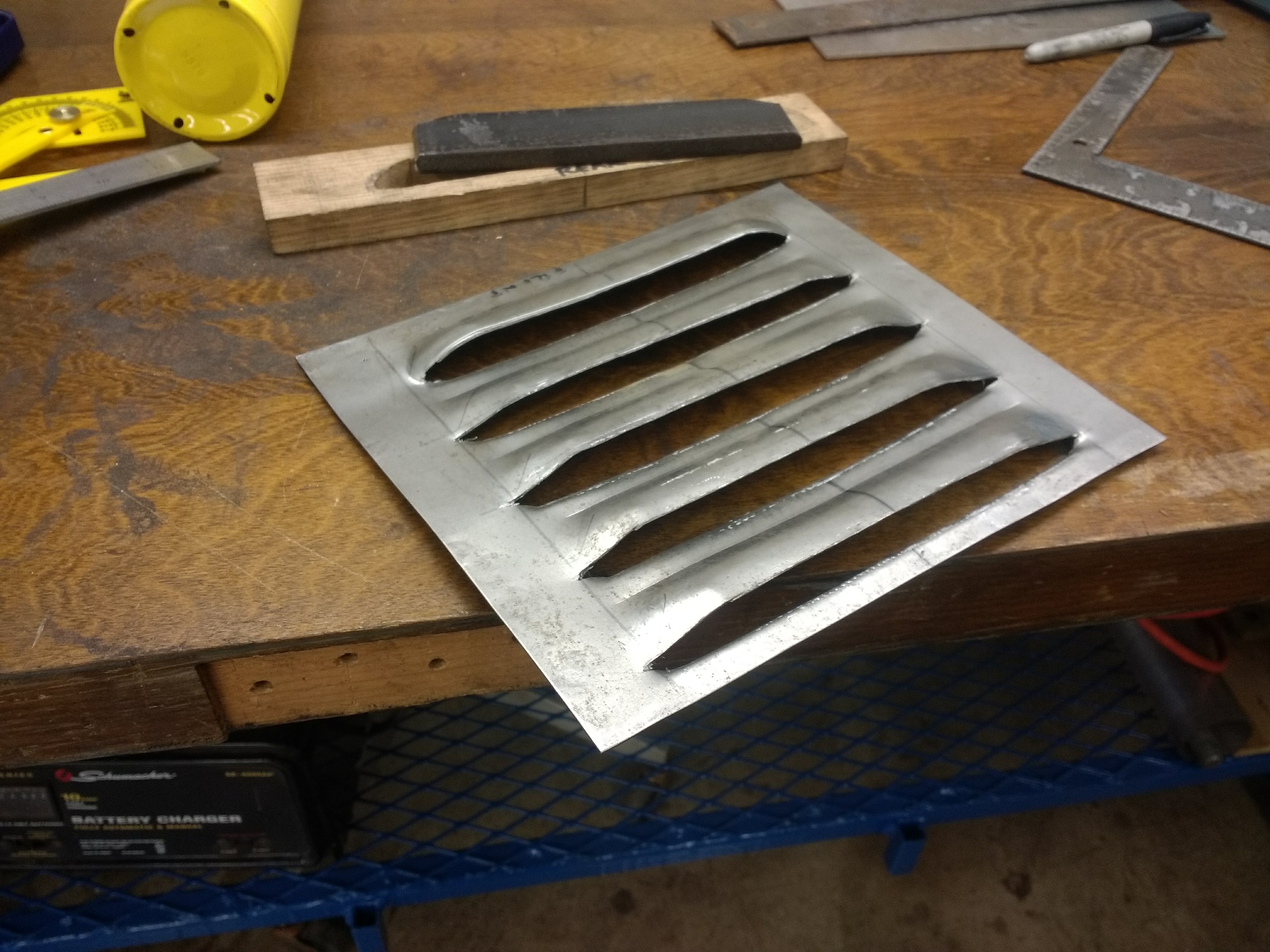

Lets make a couple of louvered panels;
Pictures take up too much room, Next Reply Please
Bead roller with louver dies installed.
I'll roll the dies over the layout on a piece of 20 gauge steel sheet.

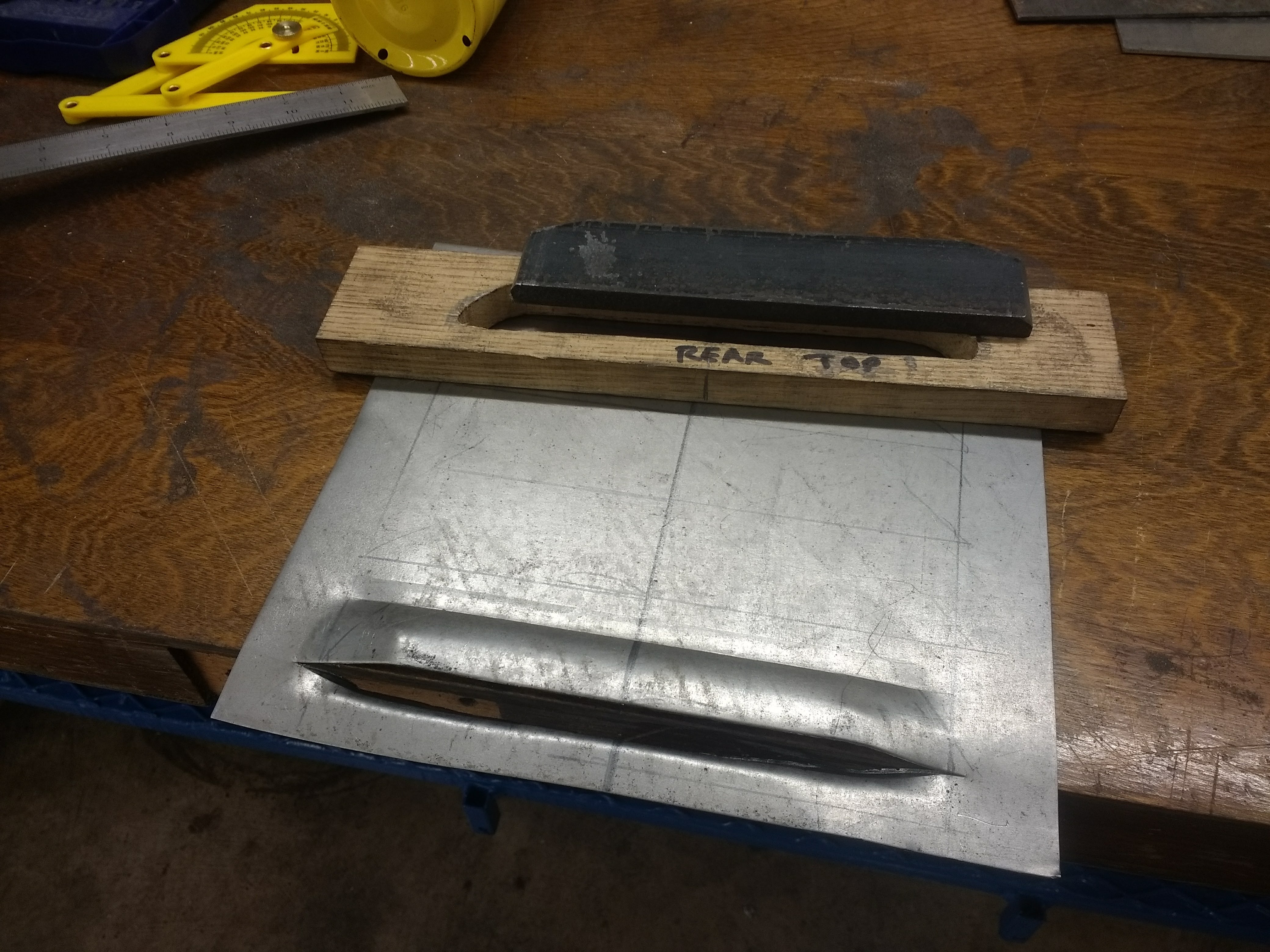

Lets make some louvers!!
Here is what the new panel looks like with one louver rolled in;
The wooden block and steel bar in the back of the louver are a homemade die to stretch the metal and make the louvers more consistent.
OK, I need to find out how to make my images smaller....... not enough room for another picture!!!
I've tried Ribbet resizing tool, it does not work with Google images, Google Images where my pics are is absolutely no help. My phone's camera will not let me choose my picture size.
Bates
post Jan 10 2018, 09:03 PM
Bates
Posts: 69
Joined: 27-December 13
From: Madison, Virginia
Member No.: 16,800
Louvers rolled onto sheet, then stretched with steel die.
FYI, I had the die this size from fabricating engine covers (bonnets in proper English) when I was restoring my Morgan 4/4
I made the louvered panels from 20 gauge sheet, as this is easier on my tooling to create the louvers, the floor panel is 18 gauge
