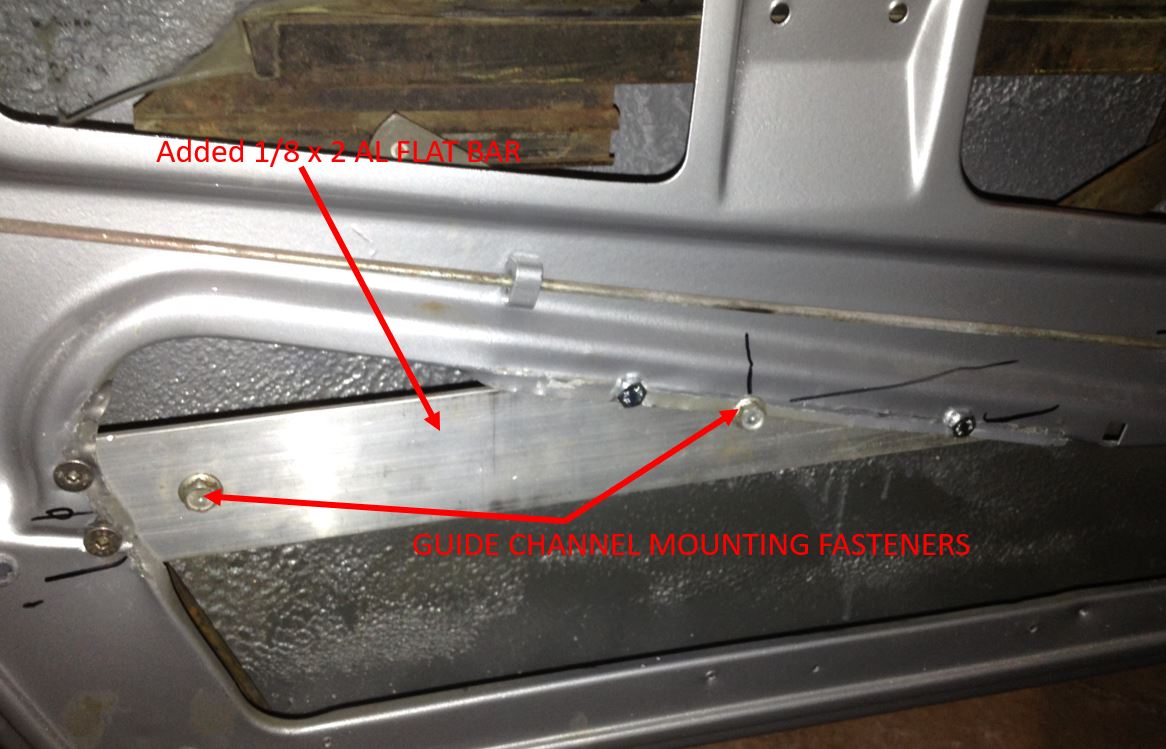

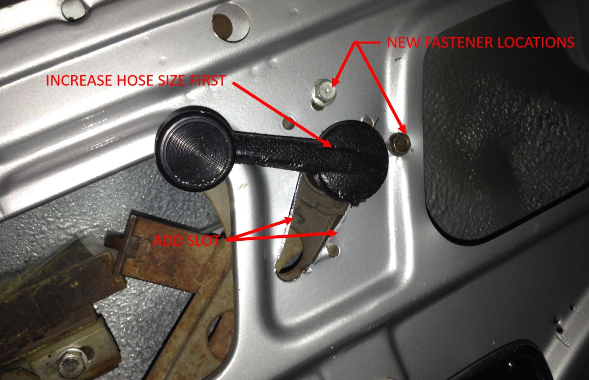

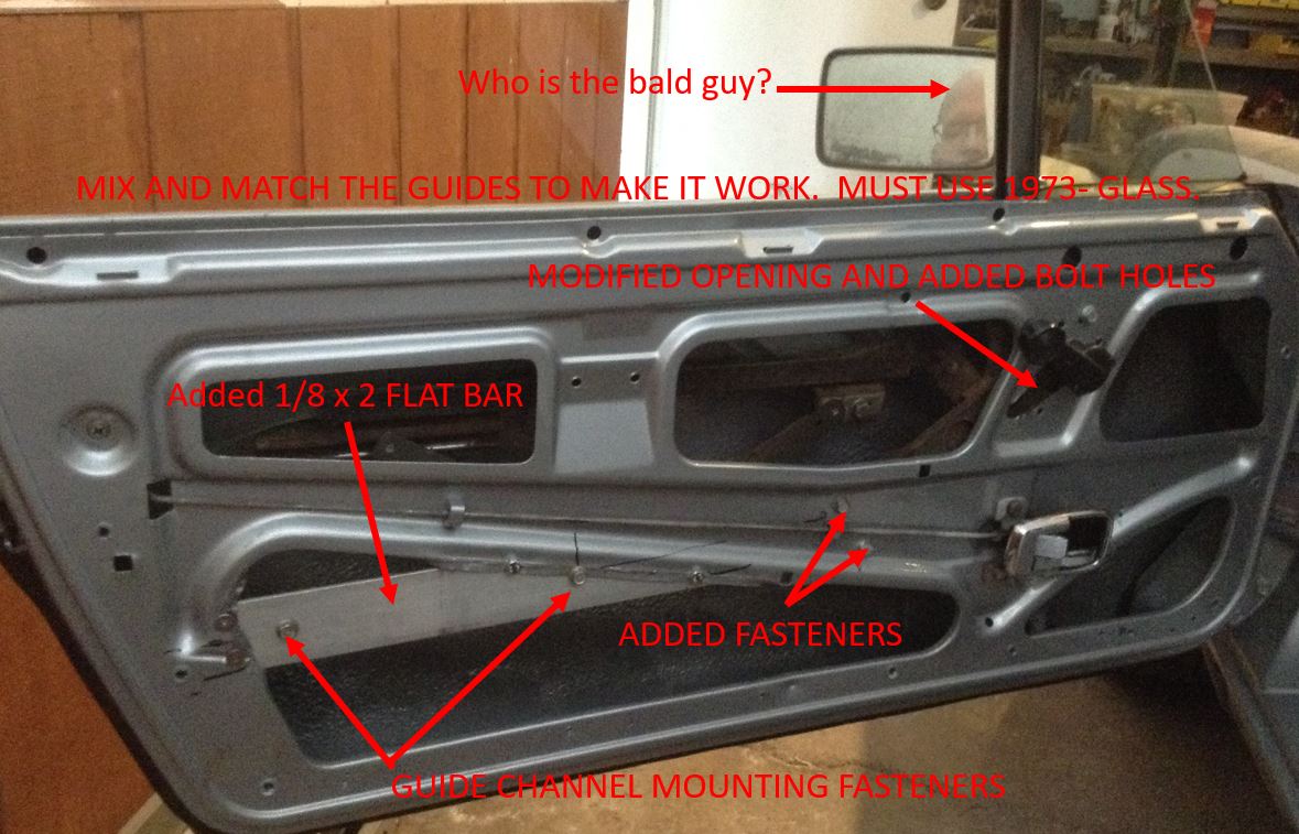

> Late model window regulator in an early door, I converted a 1972 door to use the scissor type window regulator.

Not pretty but it works. Definitely need a 73 or later donor door with a lot of trial and error to get it tol work.
1970-72 is a lighter door because it doesn’t have the side impact reinforcement.

I did a similar mod on my late 73. I used older doors and made 5 cut/slices to completely remove the old winding mechanisms structure and tigd in the new style structure.
