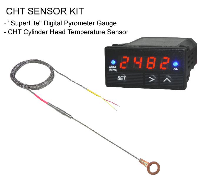

I've been using these since I've rebuilt my engine to a 2056 about 5 years ago:
Head temp gauge:
http://thesensorconnection.com/cht-sensors...e-sensor-kit-fs

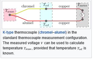

A head temp gauge is nothing more than a type K thermocouple reader. In the image below taken here (https://en.wikipedia.org/wiki/Thermocouple), we can see Tref which happens at the transition between the TC chromel/alumel wires and the copper wire.
The TC will read the temperature differential between Tref and Tsens. This is why you don't want Tref to be located in the engine compartment (Like the VDO gauge). This would not give you the proper head temp as it would be offset by the engine compartment temp. Ideally, you want the TC wire (chomel/alumel) to run all the way to the gauge, and have a compensated gauge that will have a sensor measuring the temperature at the gauge connection point (which will be cabin temp) and compensate (compared to 20-25C room temp) in order to give you the correct head temperature.

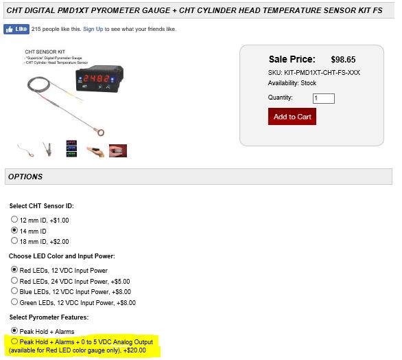

How about a recommendation for just a sensor that does variable voltage output? Or a resistive circuit sensor with appropriate voltage divider and putput volts/temperature? I'd like to install a CHT input to my DL-1 data acq system, which can be displayed on the DASH1 and warnings set.
Alternatively, how about an existing CHT gauges that has voltage output for data acq? That's what I do for the AEM AFR gauge, it offers voltage output (and I just hide the AFR gauge behind the panel; I only want to see numbers when things go pear-shaped...)
Montreal914
post Jan 26 2018, 10:21 PM
Posts: 2,072
Joined: 8-August 10
From: Claremont, CA
Member No.: 12,023
QUOTE(GregAmy @ Jan 26 2018, 08:06 AM) *
Yes, 0-5V output, and reasonably priced too. (post #5) (IMG:style_emoticons/default/beerchug.gif)
