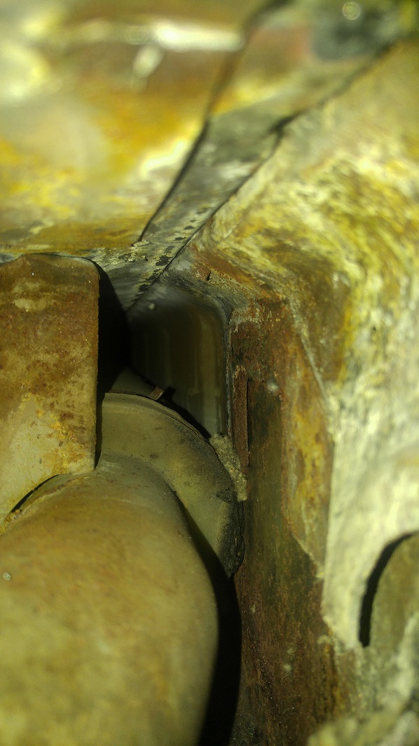

With that last photo of the replaced jack point and that itty bitty hole - I started to poke around.
TravisNeff
post Jun 5 2018, 04:26 PM
Posts: 5,082
Joined: 20-March 03
From: Mesa, AZ
Member No.: 447
The long was stuffed with what looks to be Cotton. Damn rodents! I am not surprised I found a whole bunch of dry dog food stuffed in the heater tubes when I installed the inner long kit a long time ago
The longs are rotting from the inside out.
