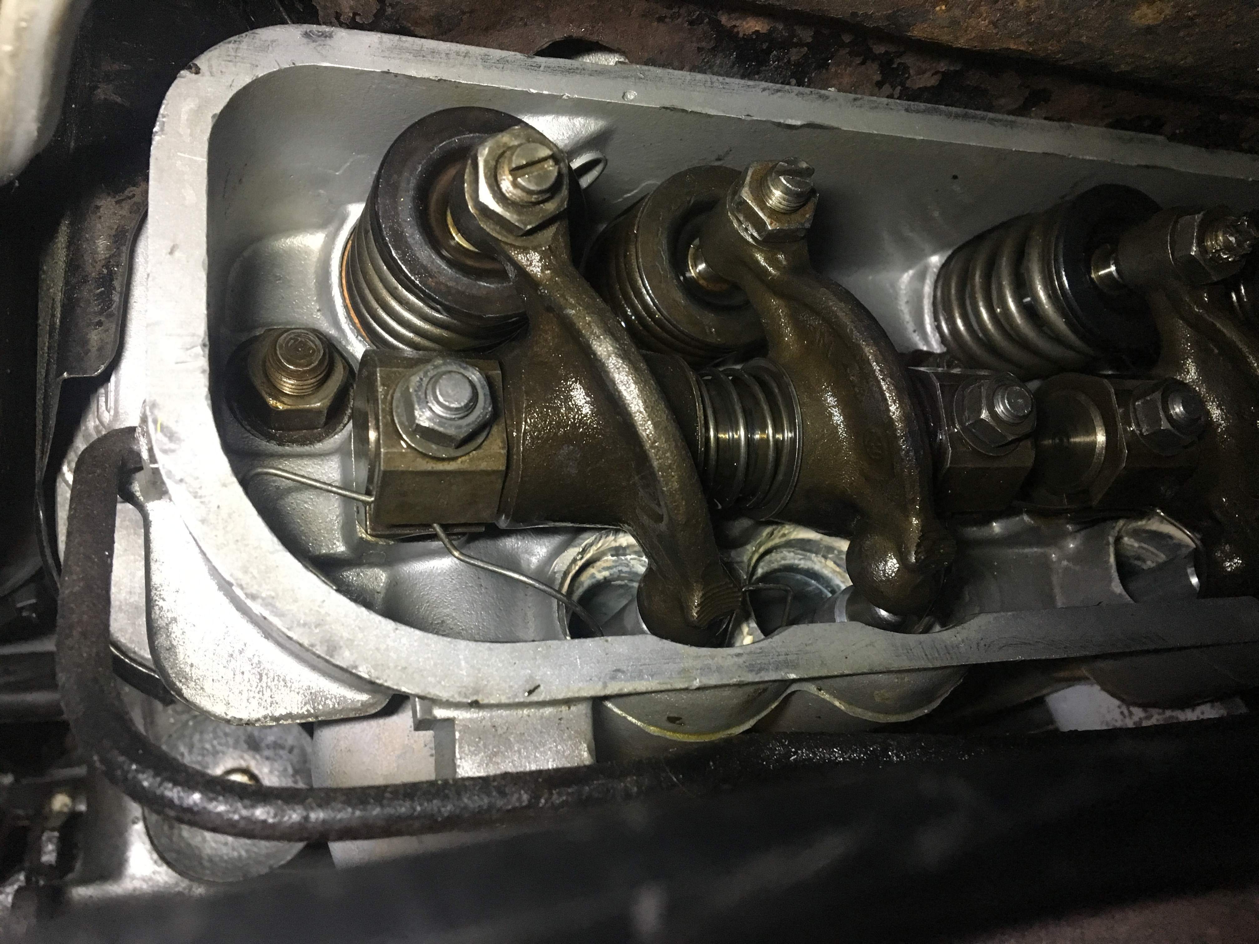

See photos. Definitely a stuck valve. Pushrod
Fell out of rocker as result.

Stuck intake valve

Once the valve is bent, it is going to stick. Maybe a result and not a cause.

Possible causes:
Guides not sized/reamed/honed correctly after install, guides tight, valves sticking. Since you are saying it happens after warm up this is suspect. If this is the issue if you remove the springs you should feel drag on the valve even cold. I agree bent valve, but they usually bend at the tulip, not the stem.
Done right the valve should have no drag or sticky spots, it should slip like it's running in butter.
Same vein, when driving the guides in the tool is leaving a burr at the top (spring side) of the guide, again this is not sized/reamed/honed correctly after install issue.
Cam gear off by one tooth.
Lifter sticking in bore, unlikely but possible.
Bad or broken spring, weak spring should only show up in higher RPM's
Chirping sound, a fast squeak-squeak-squeak can also be a head sealing issue but you should be able to see (head off) carbon tracing or if using head gaskets a definite damage to the gasket. In extreme cases this will cut right into the aluminum head like a cutting torch.

I often see this when a seat is falling out.
Mark Henry

Take the head off and look at that valve, if it is a seat it will be sitting cocked in it's bore. If it sits back down take the valve off and either knock the seat around a bit or heat it to 375-400 in an oven (chambers facing down) and see if the seat falls out.

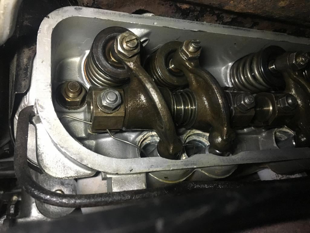

Photo of the stuck valve. When this happened to
the other head, I removed the spring,
and gave the valve a little tap and it came right
out. I then put it back in the guide and it was smooth.
There was some evidence of fine brass flakes, but on a
different valve spring.
Someone suggested possibly lifter catching. I checked them all,
and if you press down on the lifter when pulling you can feel
a small catch, but I think this is because the lifter is crossing a chasm in it’s travel in the case. I will probably replace them all. Cam off by one tooth? I usually triple check, but at this point anything is possible . I don’t know maybe I should just tear the whole case apart.
Looking over the sales receipt from Rimco, they reamed the guides on both heads originally. When I sent the other head back, they replaced the guides rather than reeming. So perhaps there is something with their reaming process ?

top end oiling problem ?? no lube

I'd check the clearance of the guides, most shops use a Go-No Go gauge, but it as simple as feel for an experienced machinist, if it catches before the spring goes on it will seize when hot.
Another cause for this is bad gas, varnish, new engine always use brand new gas.
This could just be caused by your issue, but that is lean city, brown exhaust valve, bright white electrode.

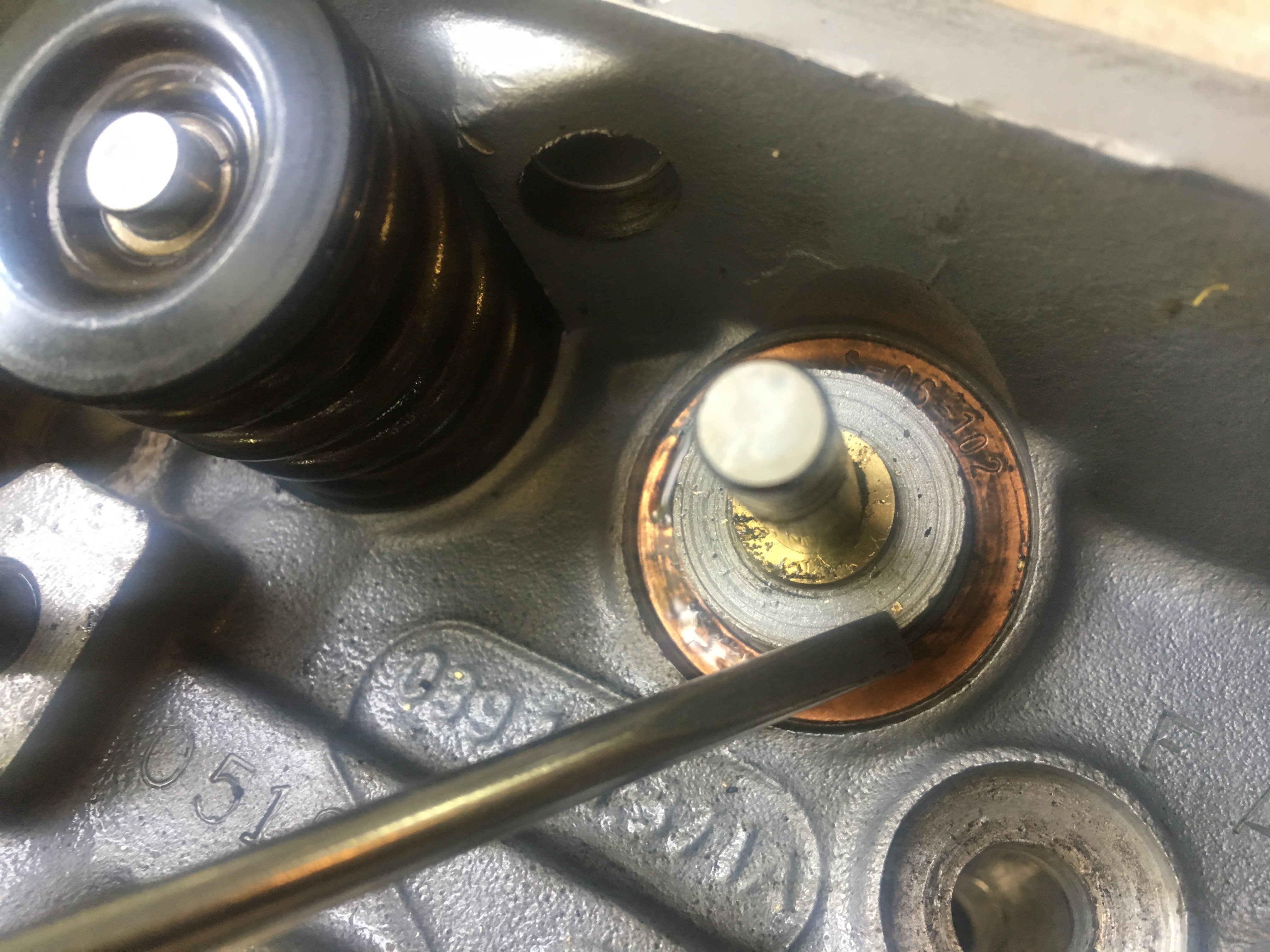

So, after sitting on the workbench for a few hours, I noticed that the
valve sprung back closed on its own. So I got the spring compressor
and removed thr spring. Gave the stem a little tap with a rubber hammer: Valve was tight! It came out with a few taps. I immediately noticed the fine
Brass shavings again. Here I point to one...

Most likely issue is the guides are too tight.
