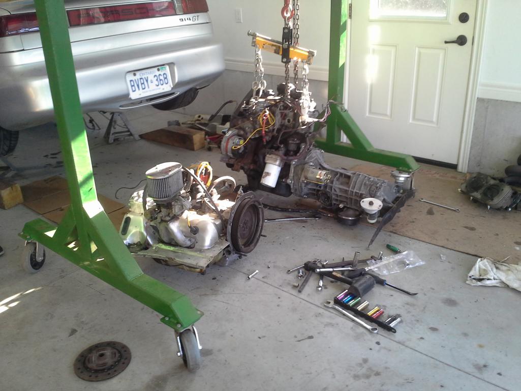

Been planning this for a while, but it was supposed to be a winter project. Wasn't quite ready yet. KEP adaptor parts have been sitting here. Timeline moved up because of a failure.

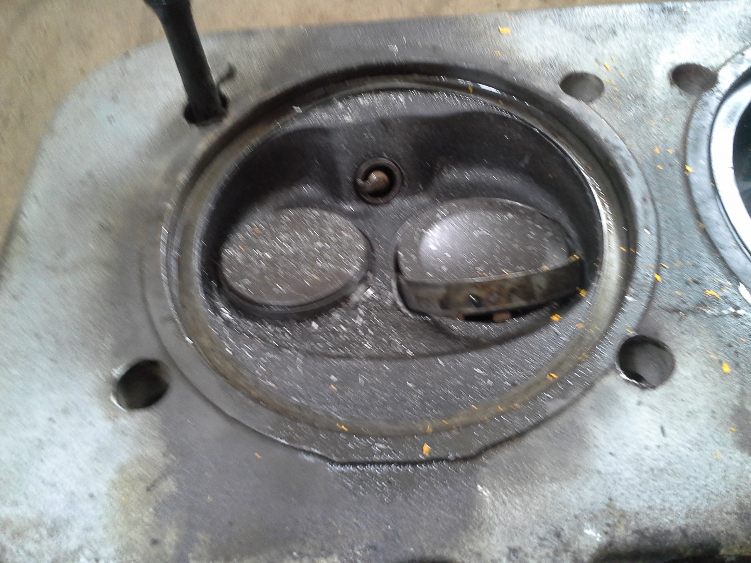

Had a chirp that turned into a BAD miss, valve seat issue on one cylinder.Attached Image

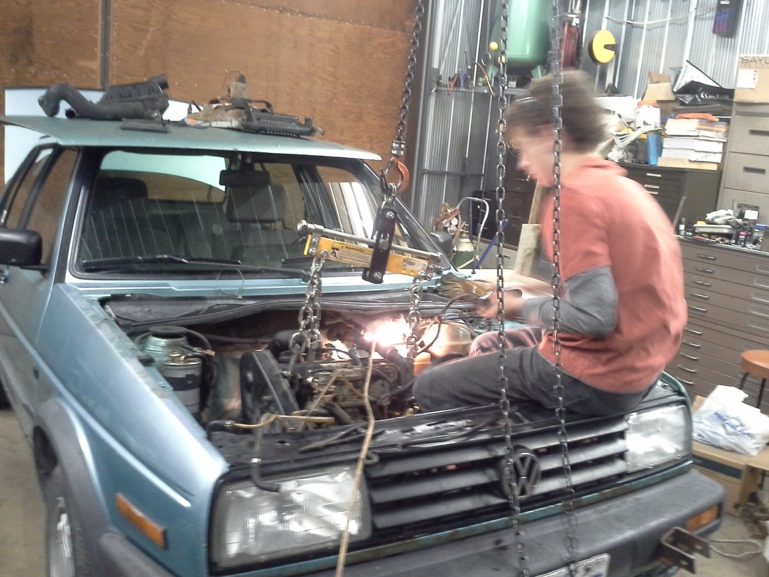

Had a fresh 1.9 AAZ diesel sitting in my storage trailer that had never been fired. (honed, rings, bearings, injection pump reseal). "new" engine was destined for my daily beater . Same engine in the beater is getting a little tired, I've put at least 350,000 km on it and the compression is getting down. Still runs okay though. Swapped the "new" engine into the beater. 16 year old son is learning...Attached Image

Plan is to build the car with the more tired engine, and pull it this winter to go through it if need be. Engine was "turned up" about 10 years ago, more fuel, timing advanced etc. and will outrun the same car with a gas engine all day long. Only change on installation is a T3 turbo instead of a K14 that it came with. Really easy to do while it's out of the car. Engine and trans met yesterday.Attached Image

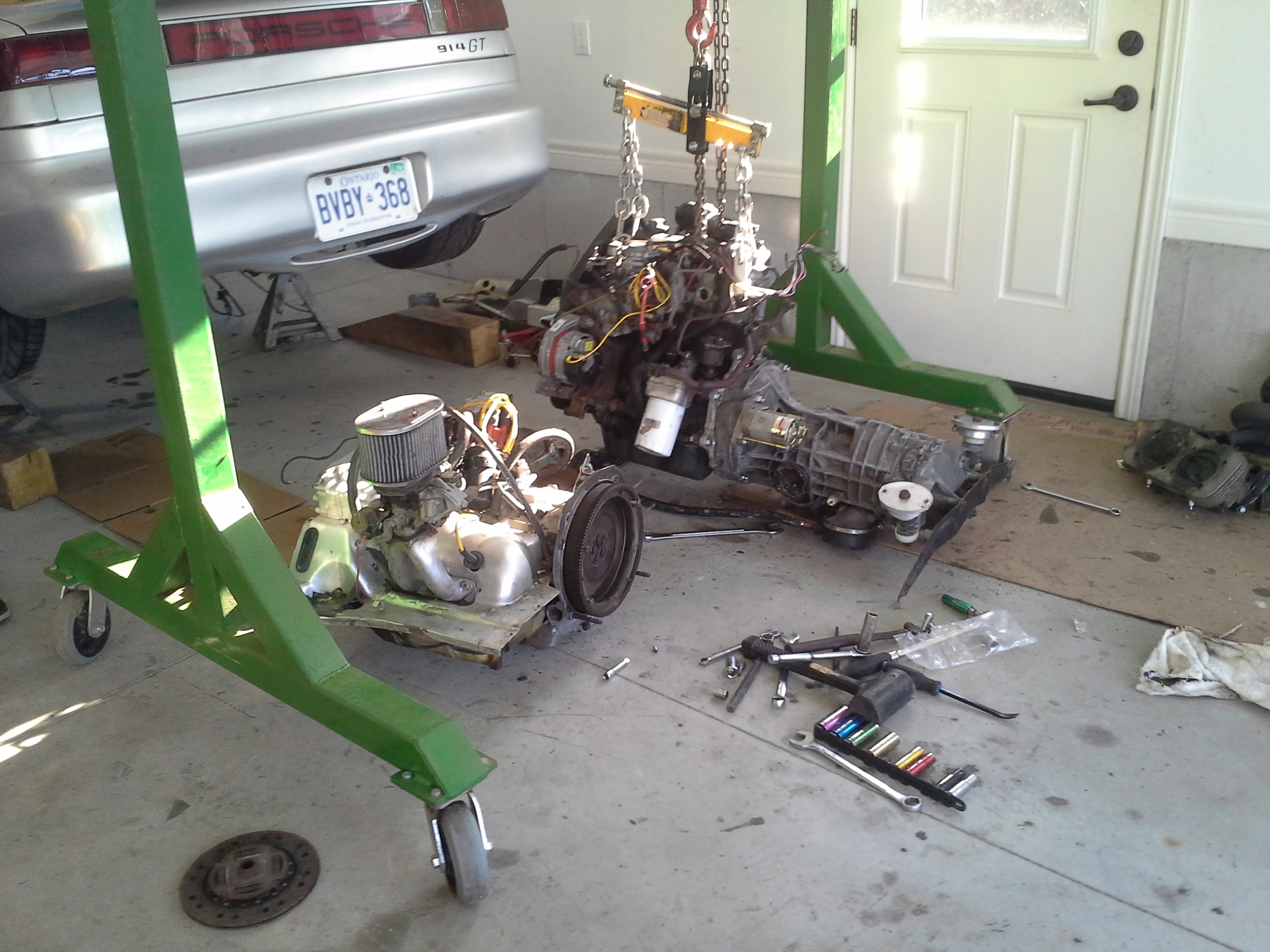

Engine/trans and crossbar are sitting on the floor in approximate placement that it needs to be in order to get a good look and plan a front mount. We have a plan, not sure if it's the best plan but will work without any car body surgery.
Car in the past had a Dodge 360 in it, water lines are there to put the rad in the front but I'm going to try to run with a rad in the engine compartment. I'd like to have a sealed up front compartment again if I can make it work that way.

BTW I may have a complete 2L engine for sale at some point, needs head work and a piston. There's a pretty good mark in the piston where the valve seat made contact. Pretty sure carbs are Holley, at least they're a small progressive 2 barrel. Pertronix electronic in the distributor. Heater boxes are a little grubby but good shape. Exhaust is a 4 into one type with a cherry bomb looking muffler.

Exactly why I'm using the AAZ that I bought used mileage unknown and put another 350,000 or so on since. Trouble free... unless you count the time I changed the timing belt and didn't do the tensioner pulley... Hard on valves when you break the belt.
Going to set the engine in and look at the plumbing.

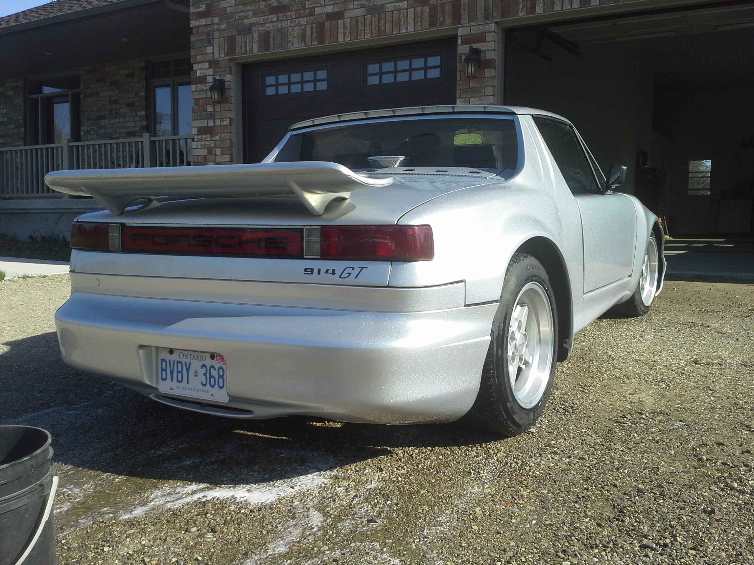

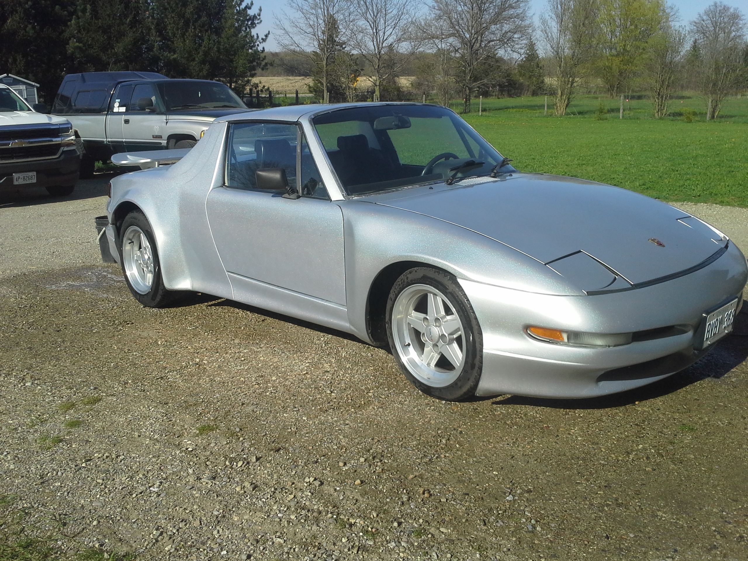

Car was previously owned by a body shop owner, only untouched panel is the hood. Roof sanded and painted. All that reshaping is steel. Attached Image Attached Image

QUOTE(PatrickB @ Jul 4 2018, 10:40 AM) *
Wow, never seen that. Kinda like 914 meets Ford Probe... (IMG:style_emoticons/default/confused24.gif)
Good eye. Ford probe bumpers grafted on, then body kit hand built to match. Was in a paint calendar from PPG in 2005. Not the way I would have built the car.... but also the reason I don't feel guilty about changing stuff.
