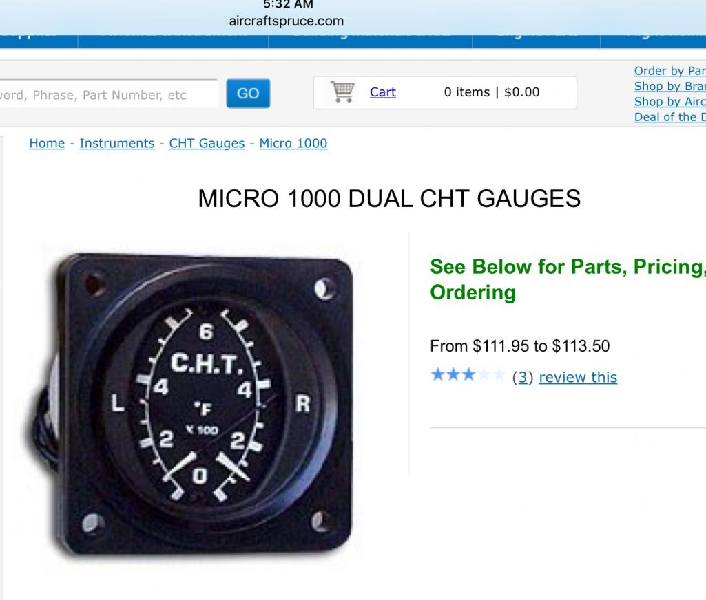

This is what I use from Aircraft Spruce with pickups under 1&3 spark plugs.

I actually have the Aircraft Spruce single (m1000) I think. Anyway I was looking about converting to the Dakota Digital since I'm never sure where exactly the analog is sitting at 375, 385, 395?? BTW these numbers are only hitting that up tall hills. I'm cruising <350 on the flats all day long (IMG:style_emoticons/default/driving.gif)
My question originated from thinking about running FI and not knowing if you are ruining your heads.
