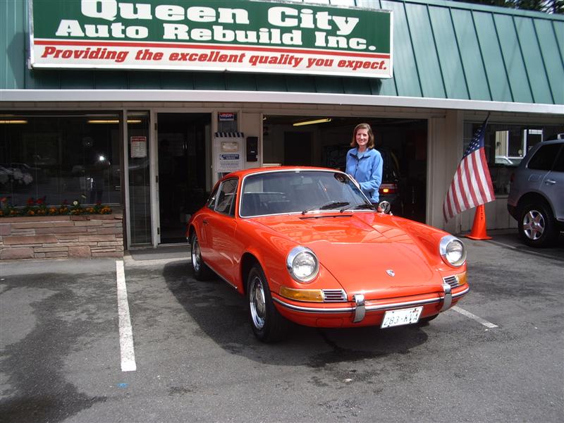

I thought about posting this awhile back, and now it's a relevant topic.
This car was just stripped & painted with some significant restoration by the same shop that is repainting my 914.
This very nice lady, a school teacher bought the car new in 1969. She had ordered a VW & the broker she was working with phoned her & told her about a cancelation he had on a 912 Porsche, she thought about it, three times the money but somehow she justified it.
She has used it as her daily driver since 1970. It is a beautiful car. Can you imagine the money that she has saved over the last 35 years even with all the maintenance, while driving a very cool car.
I thought this was just a great story . ( she did comment my 914 isn't a real porsche ........ Bitch )
