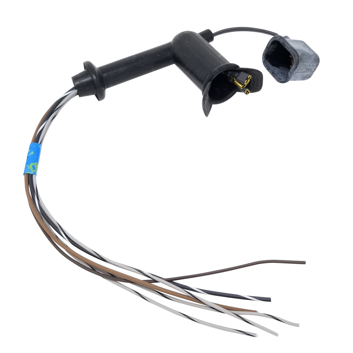

There is a short cut coming soon

Mikey914
post Feb 10 2019, 05:19 PM
The rubber man
Posts: 12,784
Joined: 27-December 04
From: Hillsboro, OR
Member No.: 3,348
Highly recommend replacing g the boots while the ends are off while you are doing this. Most are crap.
Got both of you need them.
