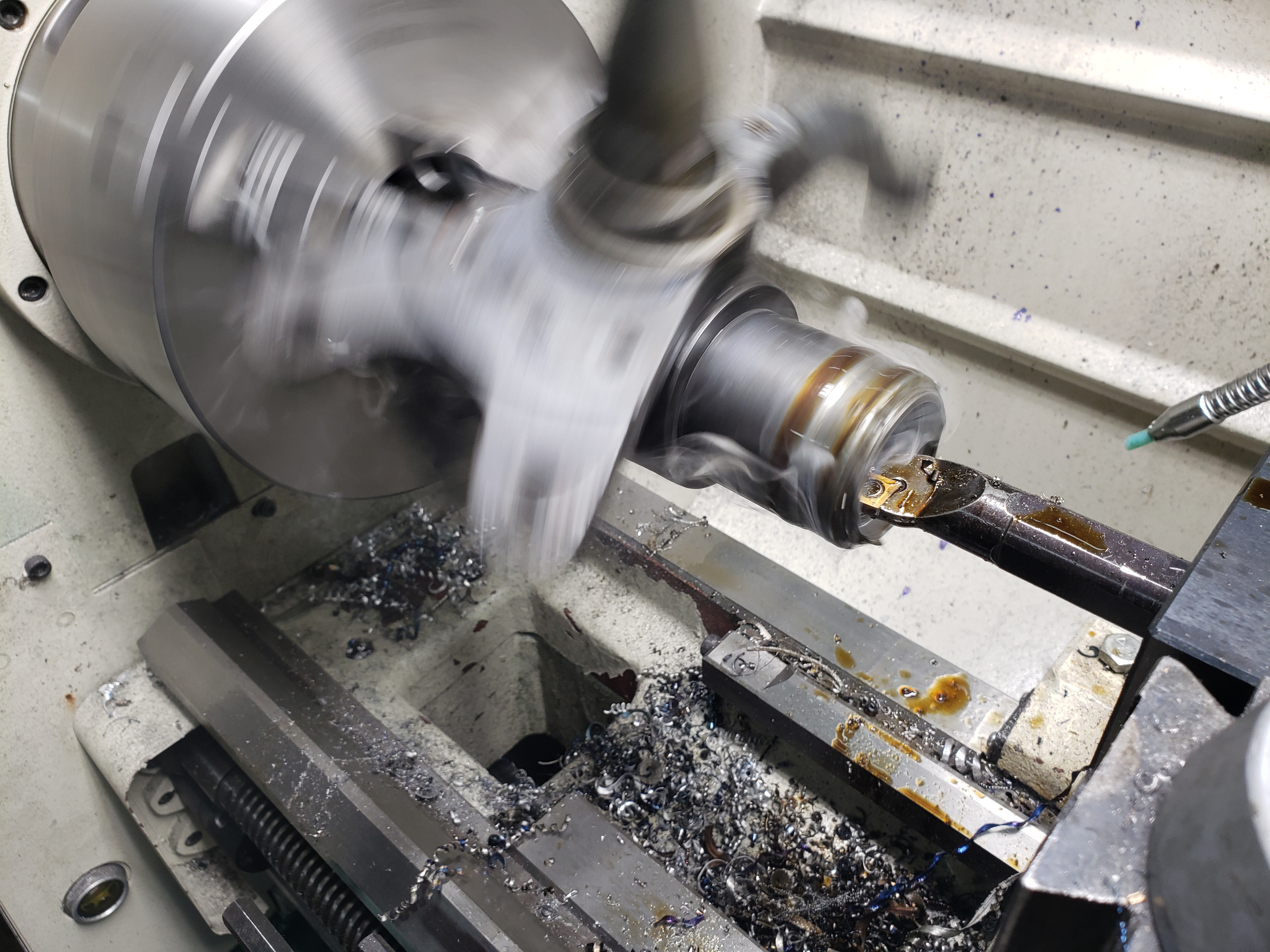

I didn't take many pictures of the process
This is after cutting off the original "Pinch bolt" bottom in the band saw, the rest of the material inside the strut must be removed
so in the lathe it goes,

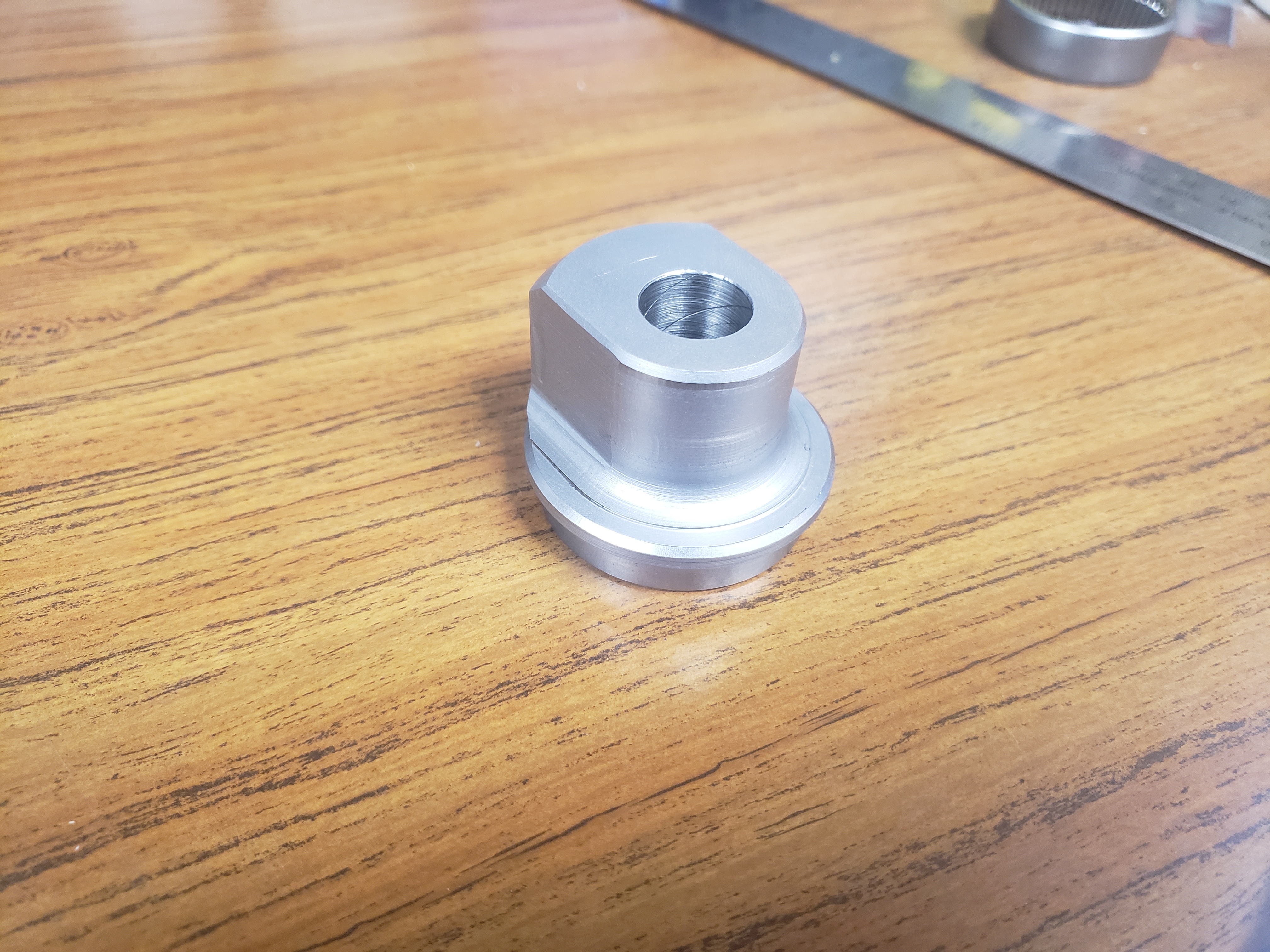

I am also working on making new wedge bolt strut bottoms from scratch, so we don't have to cannibalize original struts
These will be hardened 4140 ChroMoly
This is the prototype and its still not done so I apologize for the bad surface finish
