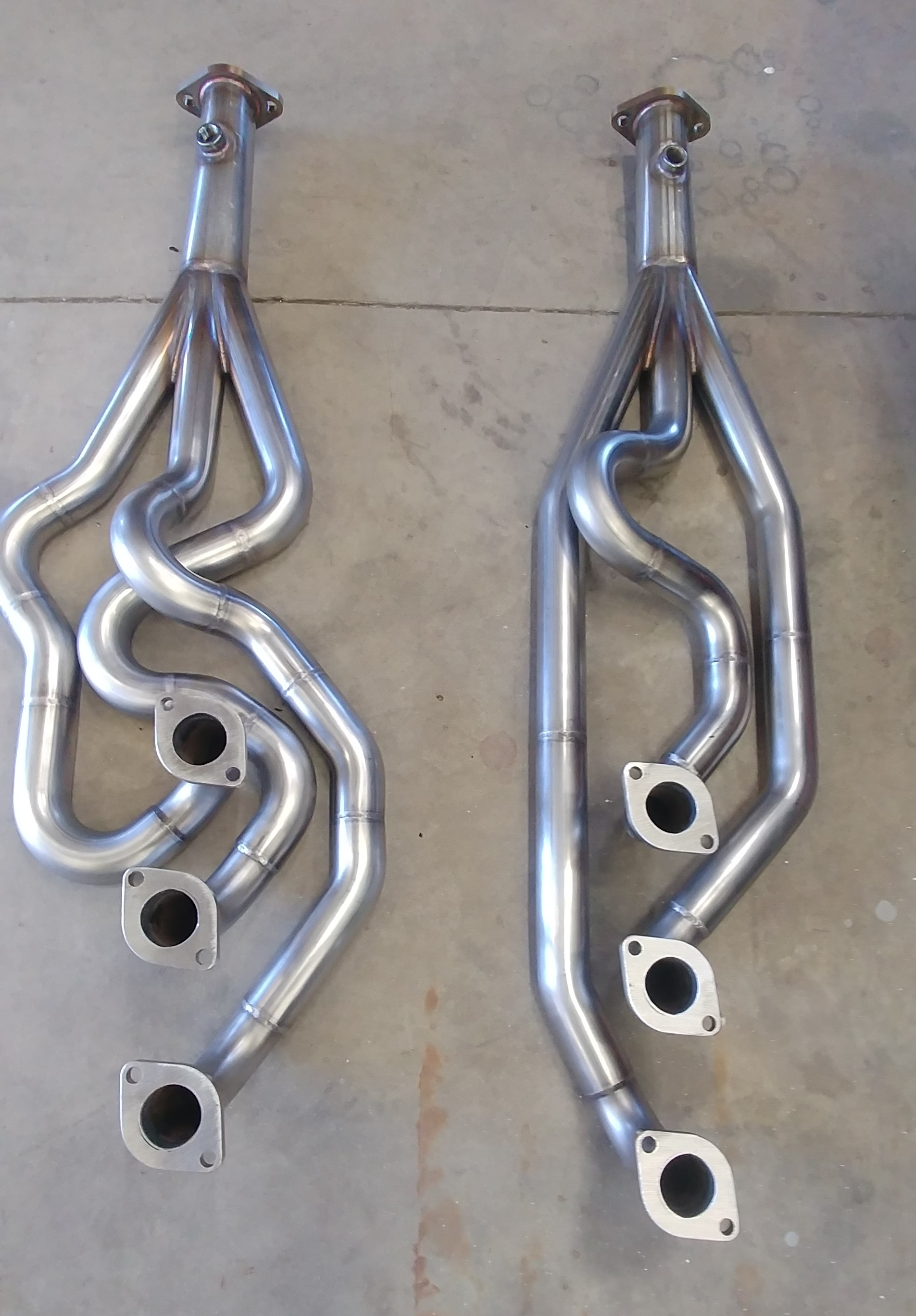

Here are the stepped headers I built for my car.. I will build heat exchangers over them after some testing but notice my 02 bung location. Attached Image

The bung should be clock to the 10 or 2 o'clock, it's the best position for any moisture to fully drain out of the o2 sensor. Moisture can cause thermal shock to the sensor.
mb911
post Apr 22 2019, 05:35 AM
Posts: 7,845
Joined: 2-January 09
From: Burlington wi
Member No.: 9,892
Mark,
I had always read 10 to 2 o clock?
