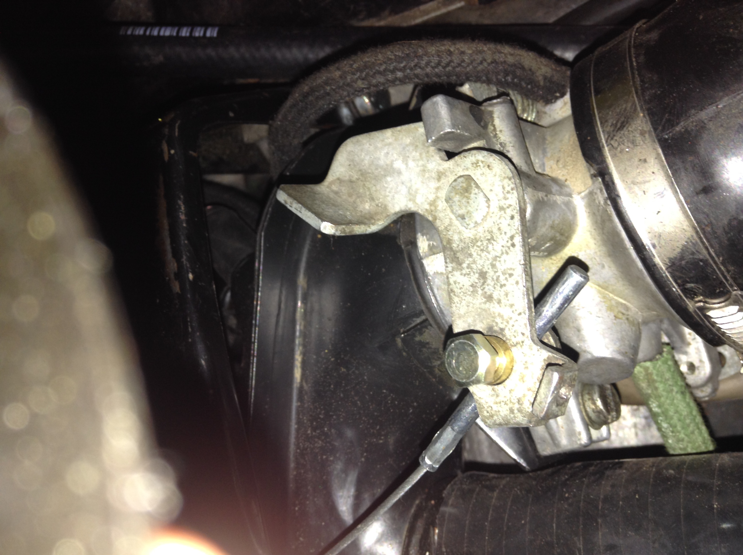

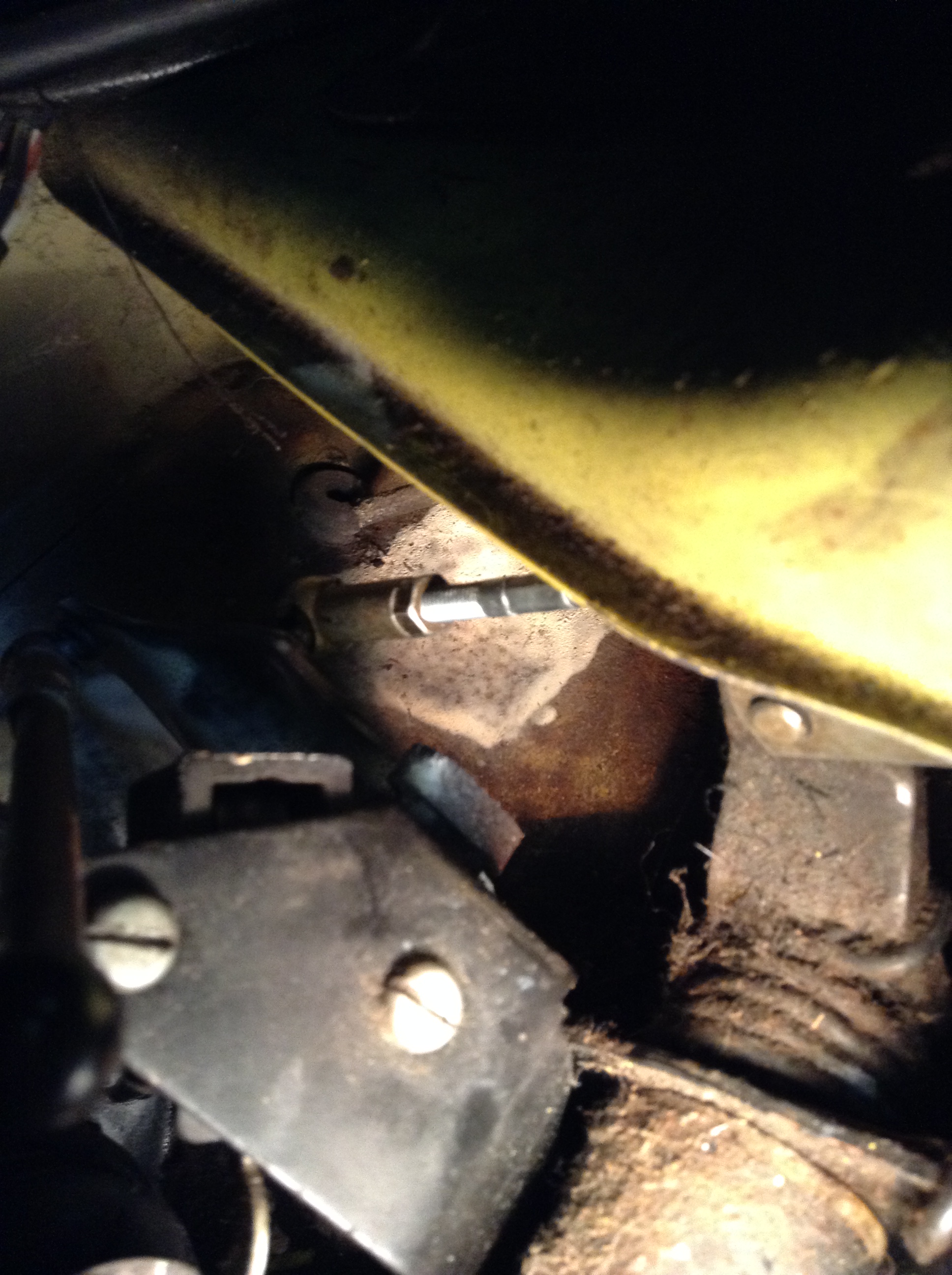

Finally had a chance to get back on it. Pulled the pedal board and the linkage seems attached at the pedals.
Loosened the air cleaner to get to the throttle linkage in the engine, again all seems intact.
There is slop in the cable at either end but not so you could pull it out from one end or the other.

To what spring are you referring? My Haynes does not show a return spring in the pedal cluster (p72, fig 4-10) and I did not see any at the engine. Will post some photos in a bit.

Some photosAttached Image Attached ImageAttached Image

That part is labeled "spring for clutch pedal shaft" so I overlooked that. I cannot see anything obvious with that, but since it was brought up, is there a connection between the throttle cable and the vertical arm on part #34 at the fork bolt, #10? I cannot see it behind the body work. Need to pull an access panel off the center tunnel?
phatnine11

enf2232,
Just a question, I don't see a spring on the throttle body?
Phatnine11
enf2232

worn

QUOTE(phatnine11 @ Sep 22 2019, 02:25 PM) *
enf2232,
Phatnine11
Good point. Should be a coil spring pulling the throttle closed.

QUOTE(worn @ Sep 22 2019, 03:58 PM) *
enf2232,
Phatnine11
Goes through hole in lever shown in middle photo.
enf2232
post Sep 24 2019, 05:04 PM
Posts: 93
Joined: 13-July 14
From: Toledo, OH
Member No.: 17,621
Partial success. Removed air cleaner and searched and found spring. Reconnected and pedal seems to work. Put things in the engine compartment back together, ran out of light. Still have to test and put pedal board back in.

ClayPerrine
post Sep 25 2019, 07:08 AM
Posts: 16,568
Joined: 11-September 03
From: Hurst, TX.
Member No.: 1,143
The later 914s had a secondary throttle spring wound around the shaft of the throttle body. If the main spring between the arm and the tin broke, the secondary one was there to make the throttle return. This was done by VW to cure runaway engine RPM complaints.
