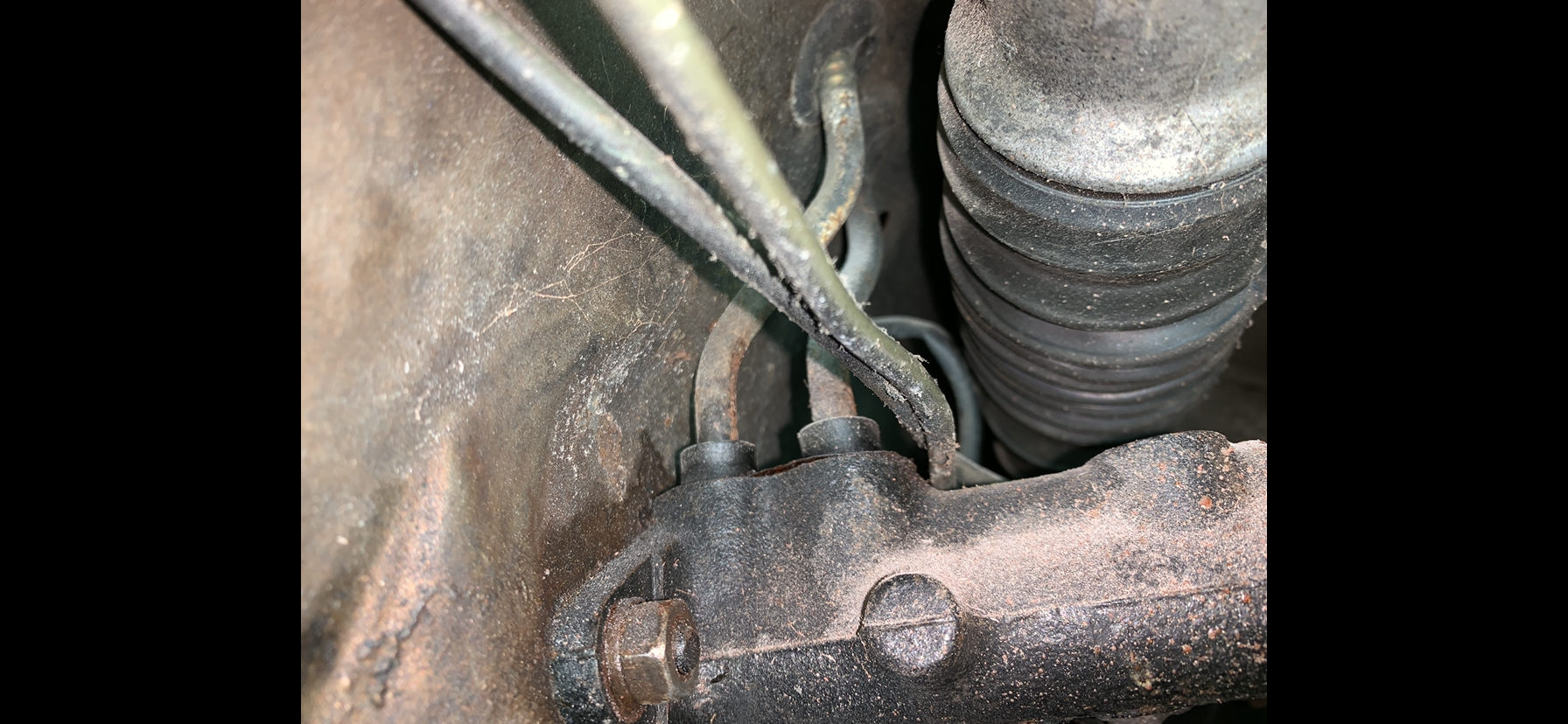

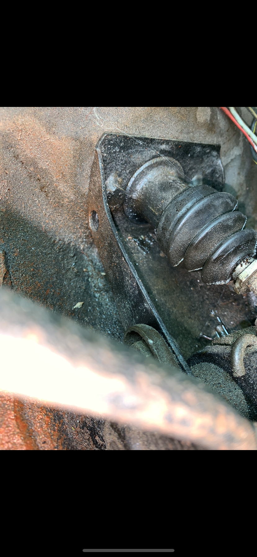

After closer investigation and looking outside at the supply lines tonight, seeing no leak from the master cylinder at the supply or the outgoing lines, I went back in to look closer, and yes there is fluid under the pedals cluster inside.... (IMG:style_emoticons/default/headbang.gif)

Outside under MC and on top are dry, just wet at wall where Mc goes thru but really wet under at the low spot here pedal cluster bolts down to floor

Well lines coming down are dry , lined up fine- BUT Mc will be replaced before car is driven again it looks like but this MC was new less than 5 years ago- hey Eric Shea, is the still under warranty?

I'm certainly no expert but it sounds like it went bad. That's what kills the pedal cluster. Brake fluid on the oem plastic bushings.

It might just be the grommets which can be replaced. I would have a new master and a pair of grommets ready.
