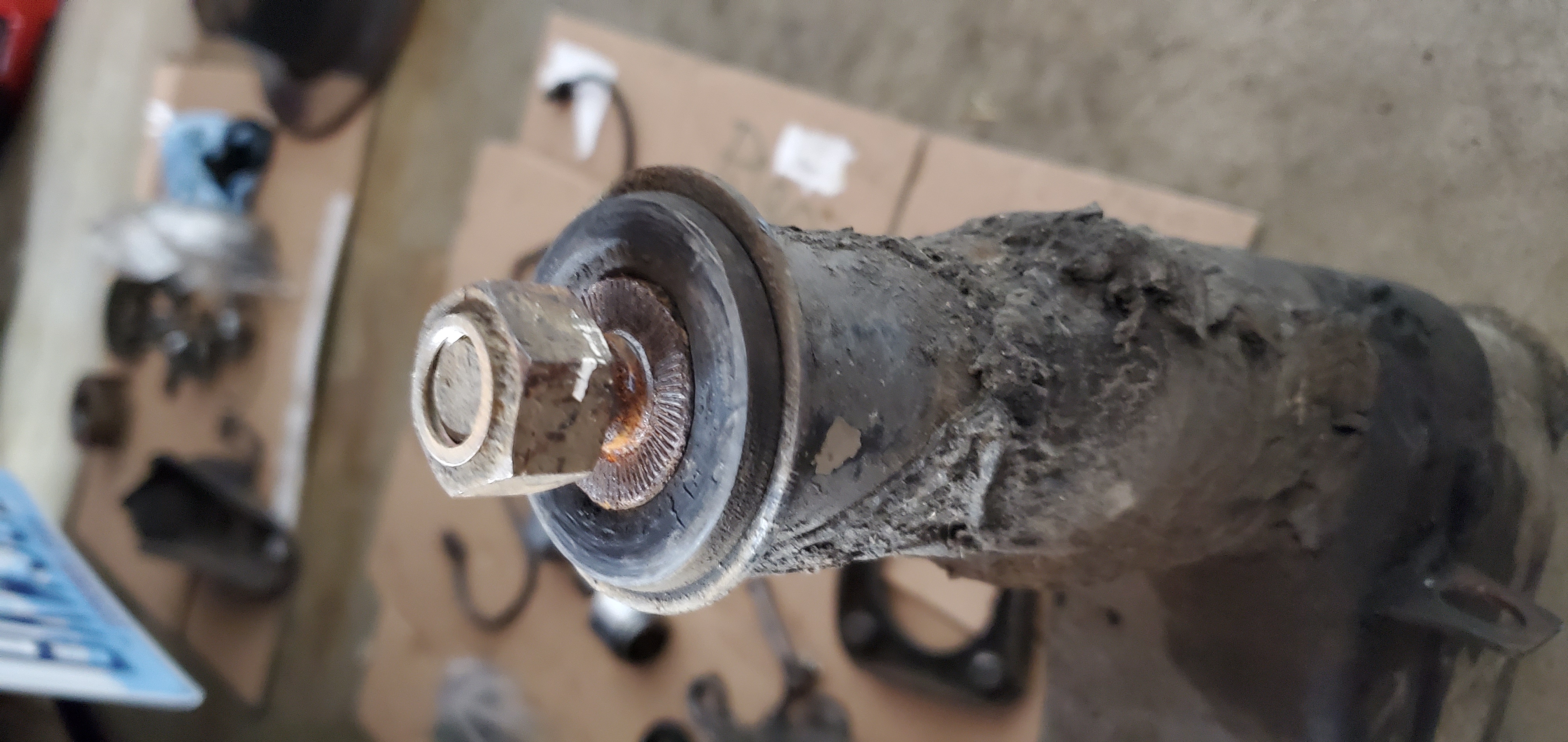

PMB is the benchmark for caliper rebuilds, but I had good luck rebuilding my own with caliper paint and parts bought from PMB. Eric can also just plate your caliper halves if you take them apart first. Change out the brake hoses too.
No KYBs! They're cheaper for a reason. My Koni reds (rear shocks) started leaking, so I pulled the nice looking KYB's off my parts car. They had Weltmeister 140lb springs on them and the car rode like it had no suspension at all. I put new Koni adjustable shocks (with 3 clicks from full soft) in the 140 springs and I really like the ride. Firm, but compliant. I put 100 miles a day on I-5, and still have my kidneys. My car doesn't have sway bars.
I only have experience with rubber suspension bushings. I would probably use original type rubber or maybe a little firmer for a daily.

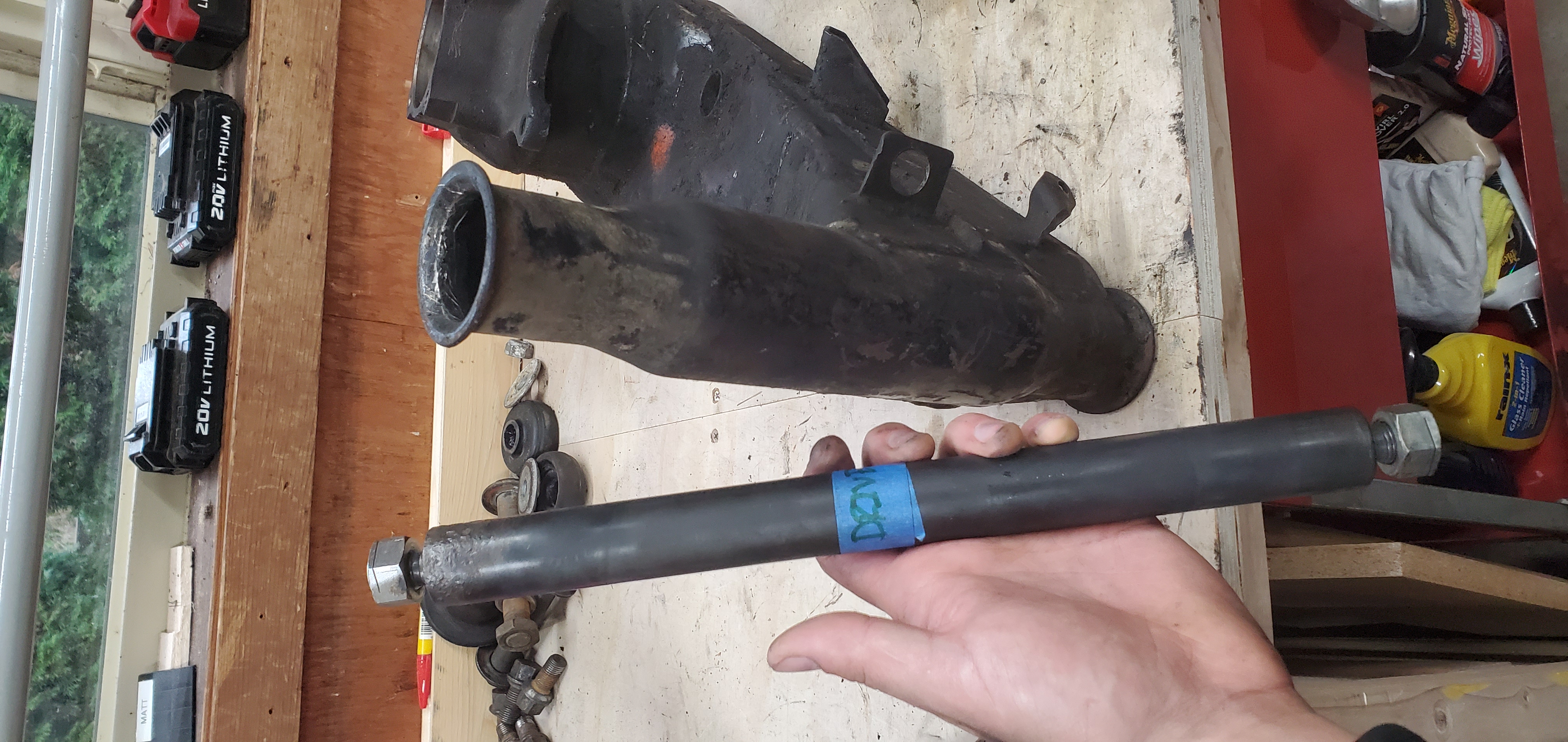

post Oct 24 2019, 10:24 PM
Posts: 310
Joined: 24-July 18
From: Olympia, WA
Member No.: 22,336
Hey guys!
I've seen a few methods online but what is the best way to get these bushings out of the rear control arms?
After much swearing, hammering and torching I finally got everything torn out and disassembled. Going to sandblast the calipers tomorrow and am awaiting parts from Pelican and 914 Rubber.
Discovered much half assed work from PO much to my amusement. Finally figured out why the right wheel had so much camber than the left...no shim! LolAttached Image
914werke
post Oct 25 2019, 12:24 AM
Posts: 11,759
Joined: 22-March 03
From: USofA
Member No.: 453
From that pic it looks like you may have more work ahead of you.
Having done a few of these ... the problem youll find is that your pivot shafts are going to be pretty rusty & corroded where the OE vulcanized rubber was attached.

post Oct 25 2019, 06:13 AM
914-6 GT in waiting
Posts: 20,922
Joined: 19-September 09
Member No.: 10,825
QUOTE(tvdinnerbythepool @ Oct 25 2019, 12:24 AM) *
Hey guys!
Either heat from a torch or a press. I’ve done both. Torch is the fastest. Heat until you get some smoke and then pry out with a screwdriver. Same with the rubber a arm bushings.

post Oct 25 2019, 09:59 AM
Posts: 310
Joined: 24-July 18
From: Olympia, WA
Member No.: 22,336
@914werke for sure! It was a ton of work just to get this far and I'm ready for a rough road ahead!
@mepstein copy the heat/press
@Tbrown4x4 calipers are taped up/holes stuffed etc but will ensure nothing got by and wilco on the paint, still exploring options
Thanks for the input guys!
tvdinnerbythepool
post Oct 25 2019, 10:49 AM
Posts: 310
Joined: 24-July 18
From: Olympia, WA
Member No.: 22,336
1 down! Took about 40 minutes with heat and press.
A little pitting on one end but should lean up nicely
post Oct 25 2019, 11:17 AM
914-6 GT in waiting
Posts: 20,922
Member No.: 10,825
Mine took 5-10 minutes each side but I really laid in the heat. I was blasting and powder coating after so I didn’t worry about the paint. I was thinking about building up the pits with jb weld and then sanding smooth but I haven’t done it yet. I’m not sure it makes any difference.
914werke
post Oct 25 2019, 11:42 AM
Posts: 11,759
Joined: 22-March 03
From: USofA
Member No.: 453
(IMG:style_emoticons/default/sad.gif) Mmmm IDK... I chuck them up in the lathe & take a mil off of them to get down to clean smooth metal before reusing.
