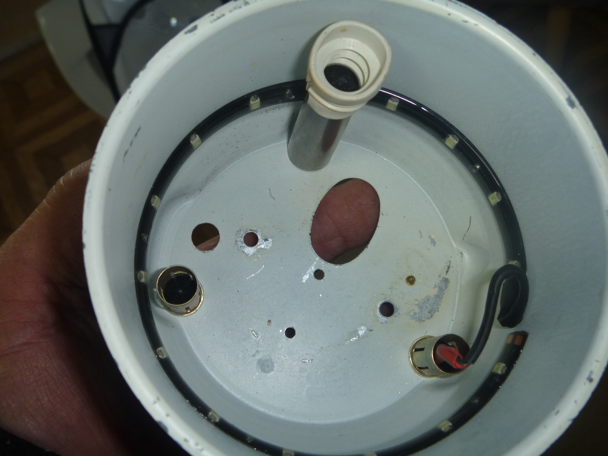

Mine fissed out when the dimmer went south so got a spare from a vendor on here and got later one (11pin),bridged out the dimmer cause running LED strips in my gauges ...don't need no shi#ty dimmer,my old switch had other issues too so worth doing.
