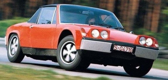

my new favorite pic.... porsche 8cyl
911 based

Member No.: 9,101
QUOTE(GregAmy @ Jan 16 2020, 12:07 PM) *
You're *far* better off trying to find an actual 908 engine...
It's interesting though, I never noticed that they had moved the firewall back on the 914-8 until just now. The picture always seemed a bit off but I couldn't put my finger on what was different. (IMG:style_emoticons/default/wacko.gif)

I think the quad headlights would be far out..
the body sure looks tortured in this pic (IMG:style_emoticons/default/driving.gif)
