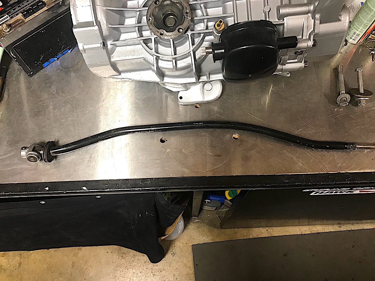

A few issues here , after the bushing disintegrated I ordered new stuff, a new firewall bushing from RIX914PARTS and other goodies from 914rubber.com, and a new brass bushing for the coupling, however I can’t get the pin out, and I’m going to mess up the pin end and it’s not going to slide thru if I do that- so I’m going to have to find a press I guess somewhere?
1. Should it be that tight ?
2. Is this a normal weld end?

lube the pin, support the coupler in a vice with wood to cushion and drive out the pin, Replace the coupler bushings with the special delrin variety with the completely round hole

That was one of the more frustrating tasks I've had to do. Getting the pin out was surprisingly difficult. I think I ended up putting it in a vice with a drift and using the floor jack handle as leverage on the vice handle. Penetrating oil, heat, and crank a little on the vice. Lil' bugger finally let go.

2. Normal
The coupler is not that strong. It's better to support the rod. I like to use a long socket under the pin - basically hammer or press the pin into the socket.

I've done a bunch of those. I use two sockets, one for a "cup" and the other for a pin. Make sure the pin isn't pitted badly or it can chew on the bushing.

From the pictures the pin ends look pretty distorted. That won't make the task any easier.

QUOTE(rhodyguy @ Jan 18 2020, 09:32 AM) *
Good point. So you want to make sure the pin doesn't have any burrs on it that would give you trouble pressing it through. If both sides have boogers, you can get by cleaning off the press through side.

QUOTE(IronHillRestorations @ Jan 18 2020, 01:14 PM) *
Only one side is like that, so should be able to press it thru on other side.

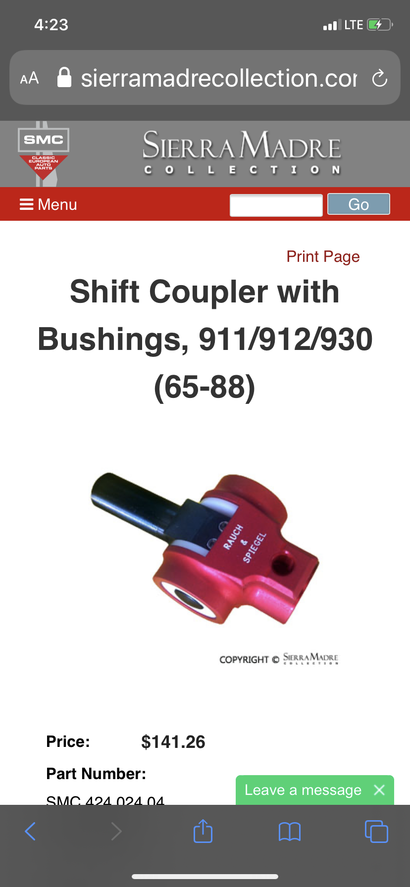

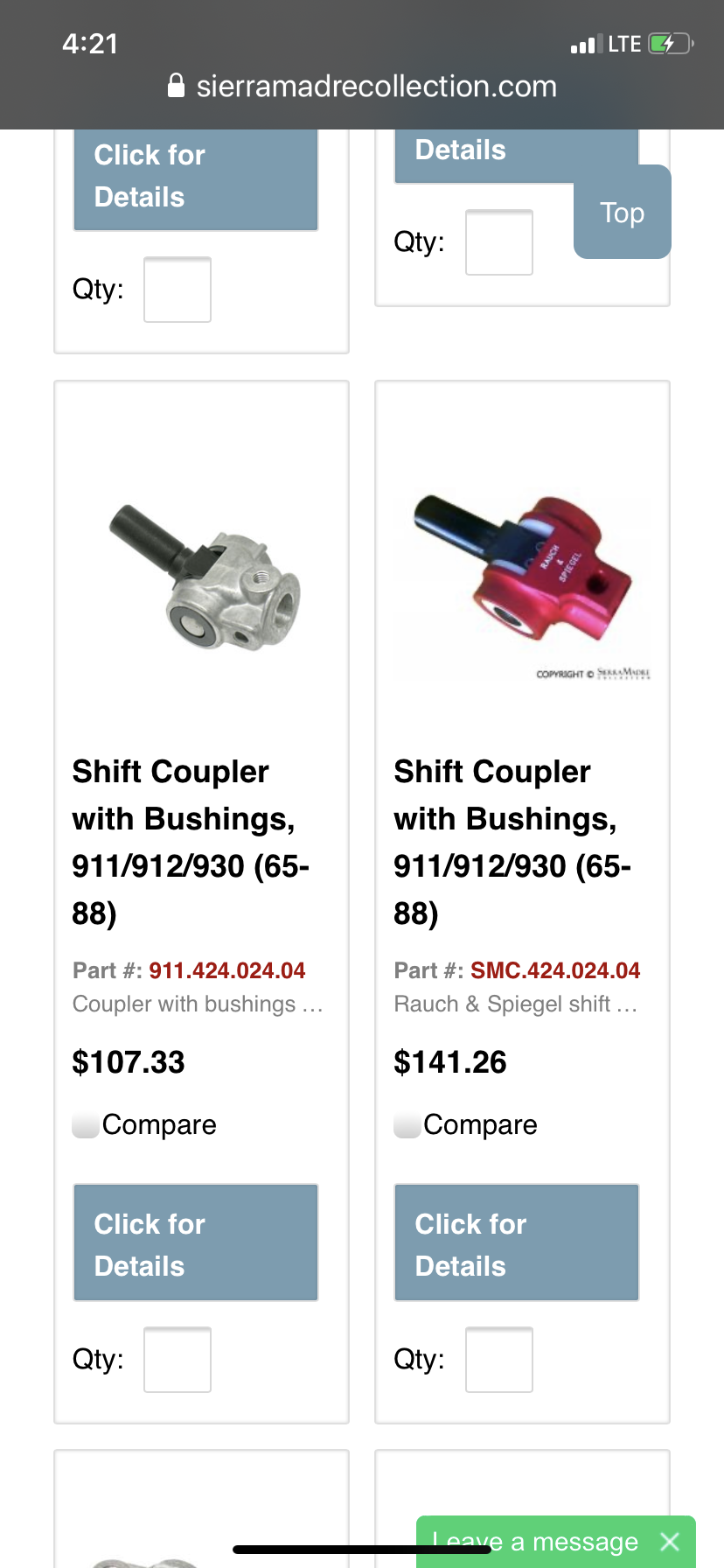

I don’t think the pins are available. There are several different couplers on line, not sure any but the OEM one from Sierra Madre is the correct length etc.
DRPHIL914
post Jan 18 2020, 03:26 PM
Dr. Phil
Posts: 5,907
Joined: 9-December 09
From: Kennesaw, GA
Member No.: 11,106
https://sierramadrecollection.com/Shift-Cou...-88-p22232.html
Any reason why these could not be used, looks like comes with coupler bushing and pin
Mikey914
post Jan 18 2020, 04:19 PM
The rubber man
Posts: 12,772
Joined: 27-December 04
From: Hillsboro, OR
Member No.: 3,348
Why replace a perfectly good part ?
You still have to press the shaft out of the old assembly.
We had looked at making these but got down to that question.
Perhaps we make an entire assembly?
Easy swap out.

Member No.: 378
1/2 step forward and 4 steps backwards with those fancy ones. Cutting, welding?, tapping?, ruining a functional rod? Dress the pin with a file, put in the new bushings and be done with it. Put glycerin on the pin and bushings.

Member No.: 21,666
Personally I’d replace it since if the repairs are not spot on it tweak the alignment of everything.
