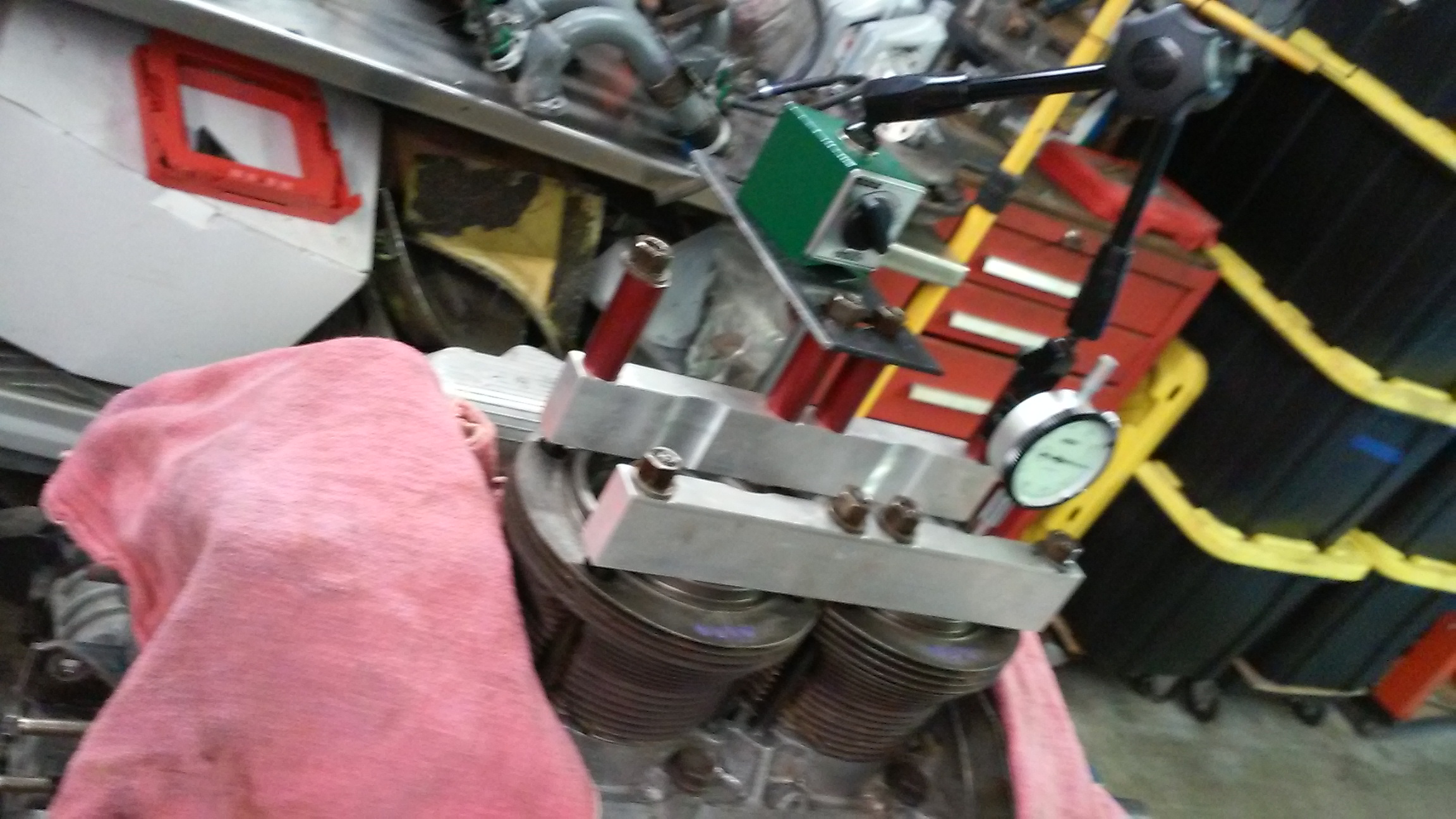

The individual deck heights are less of a concern than having each pair of cylinders even. I use to make a tool to do this, but you can probably work something out with a straight edge, some spacers, and the cylinder head nuts.
I picked up one of your tools used. Were there any write ups or instructions on how to use it? I found the original pictures and see how it’s bolted up and seen how the plate locates over the pistons. What type of mounting is used for the dial indicator?

Aaron I think I inherited one of your tools, is it two machined alunimum bars with a keyed plate that drops in for measuring deck and 4 spacers?
I'm using it for the first time and have to say it's a nice piece of T4 kit. (IMG:style_emoticons/default/thumb3d.gif)
try this ~

That looks great. How is the dial gauge connected so that you can slide it from the cylinder onto the edge of the piston?

That's the one I have but it also has a plate that drops in between and is keyed to the half circle cut outs you see on the bars. No need to use a dial indicator, a vernier caliper zeroed on the plate is good enough.
Used it again today, got +/- .001 on all cylinders, .041 deck no base shim on KB pistons. Little lower CR than I was aiming for with stock heads, but acceptable so they went in with no shims or head gaskets.
