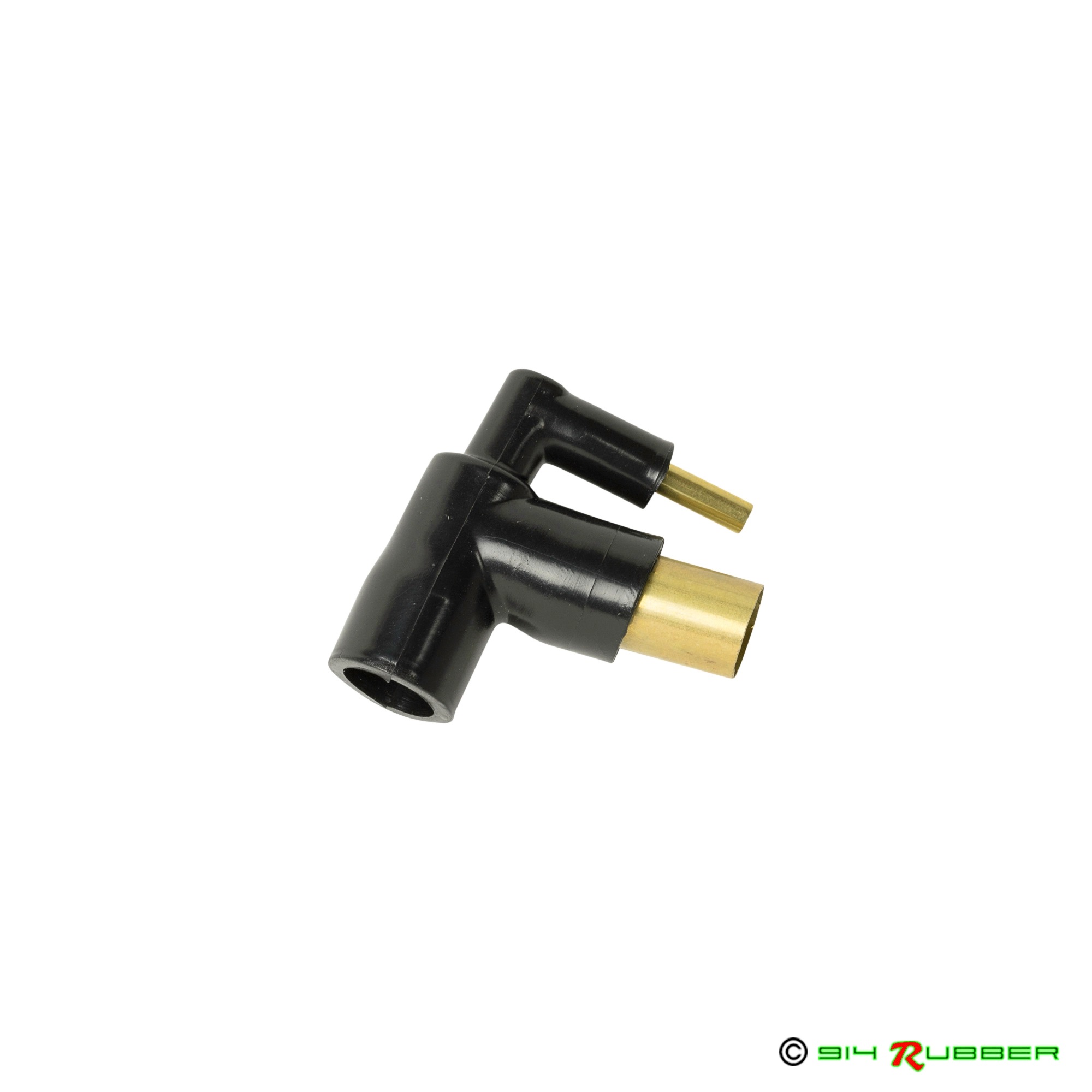

Is this what you are looking for?
https://900designs-container.zoeysite.com/b...with-fittings-1
JamesM
post Jan 20 2020, 05:06 PM
Posts: 2,182
Joined: 6-April 06
From: Kearns, UT
Member No.: 5,834
QUOTE(Mikey914 @ Jan 20 2020, 03:28 PM) *
Nope! Already got one of those from you. The problem is the 2.0 plenum currently on this motor has no where for that part to attach! Difference between the early and late 2.0 plenums. Thankfully i have spares!

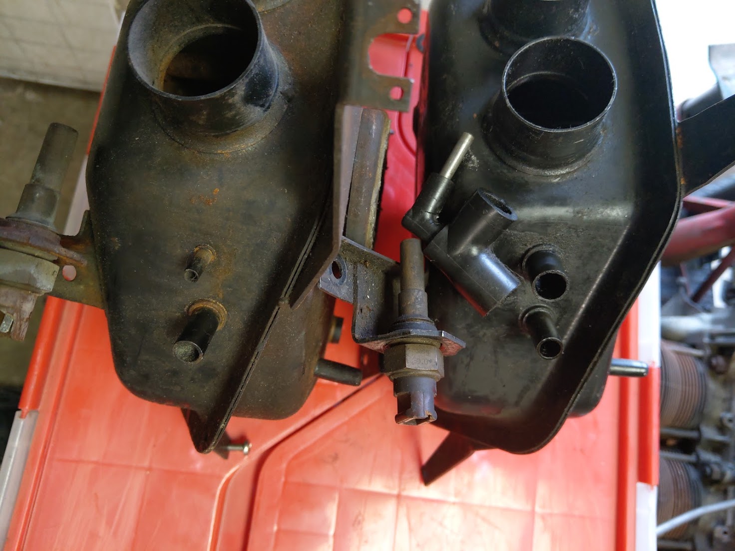

Here is a picture of the 2 versions side by side so everyone can see what im talking about.
Early 2.0 plenums had a larger port on them for the "F" piece to supply manifold vacuum to both the crank case vent valve and the control port on the decel valve. When the crank case vent system was changed in later 2.0s the port on the plenum was changed to only supply vacuum to the decel valve as on the later cars the oil tower (with no PCV) vents to the air filter box. My issue was just determining which one of these is correct for an LE, as I suspected the one that came with my LE was incorrect (as confirmed by Jeff)
914Sixer
post Jan 20 2020, 05:28 PM
Posts: 9,428
Joined: 17-January 05
From: San Angelo Texas
Member No.: 3,457
Easy spot, the one on the left is a 75-76 because of the thermotime switch.
JamesM
post Jan 21 2020, 09:32 AM
Posts: 2,182
Joined: 6-April 06
From: Kearns, UT
Member No.: 5,834
QUOTE(914Sixer @ Jan 20 2020, 04:28 PM) *
Except these both have the same dual wire thermo-time switch. (IMG:style_emoticons/default/biggrin.gif)
