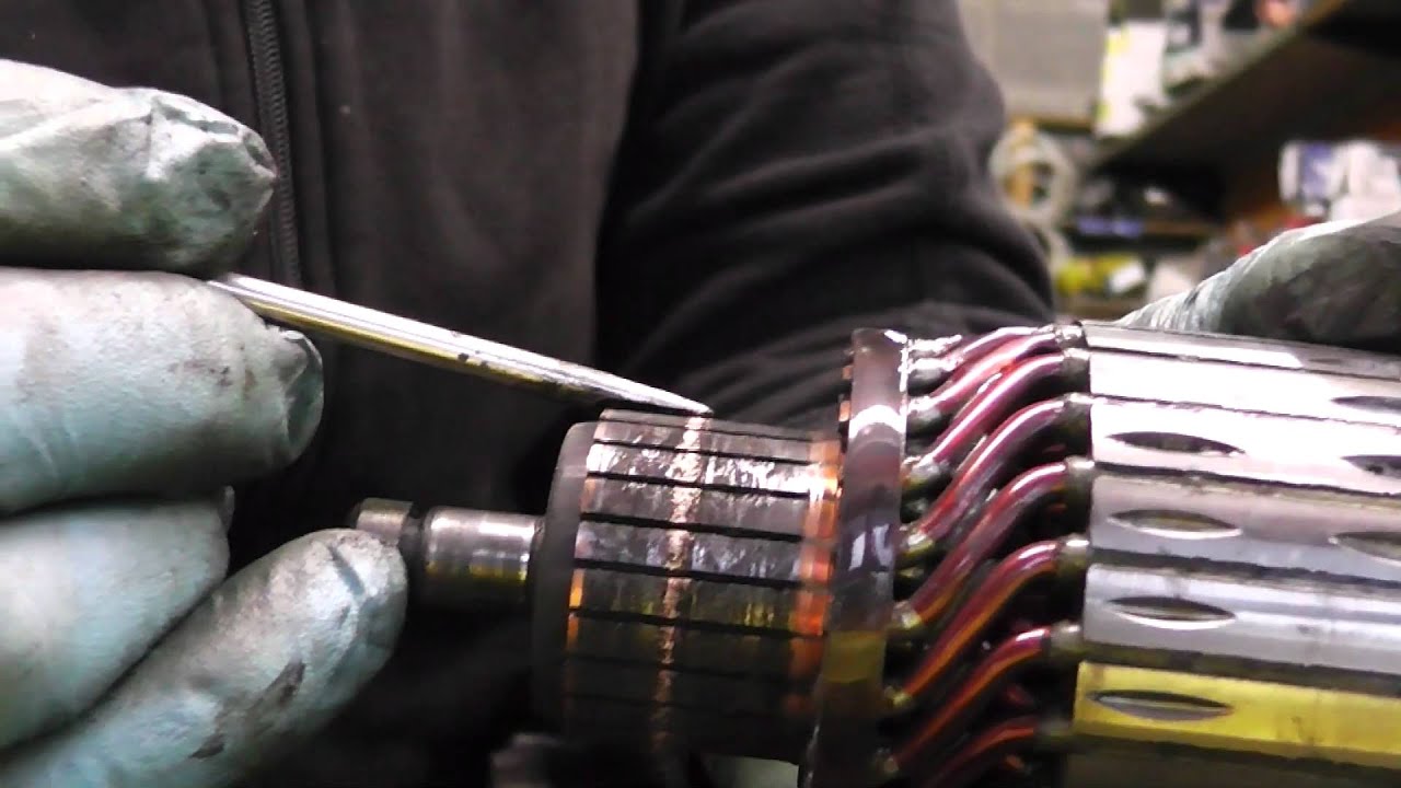

Sounds like its just dirty inside,they can be sluggish to turn if the commutator is glazed up with carbon from the brushes or the brushes are worn.
Used to polish the commutators in a lathe after recutting the segments with a modified fine hacksaw blade,brushes don't normally wear too much but aren't hard to change if needs be.
Worth checking the solenoid is sticking up also,that can slow things down.
