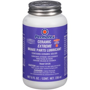

I lightly lubed the flare on the metal tubing with the Permatex Brake Parts Lube
I had no issues pushing the flare into the rubber grommet.
As stated before, give yourself some slack by removing the reservoir strap.
