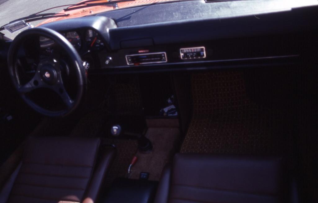

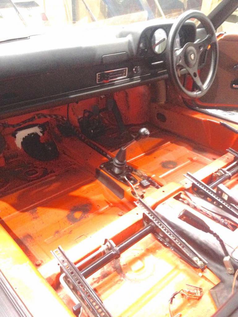

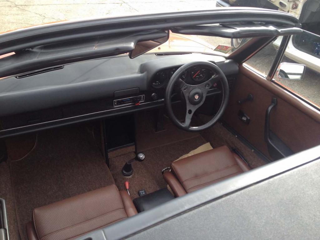

re dashboard. i believe it actually comes via WA (along the way), the dash is a complete fibreglass unit. the mould was available to guys around melbourne converting the cars in the late 80s/early 90s. reputedly the mould was a crayfords unit sent out to australia (to perth according to story or myth) for a licensee to convert 914s for the australian market when the cars were new.
where it differs from crayfords original finished dashboard of the 1970s is the ash tray has been incorporated (bit of work if i remember right) and its not hand glued and hand stitched leather covering as they did. we did a full vinyl vacuum wrap. its not two piece like a factory dash where the top padded section is fitted down on to the top of lower metal dash (which has its own section of padded vinyl competing the section to the windscreen. the lower dash knee padding and air vents are re-used. the chrome trim strip removed and refixed from left to right. the heater blower controls cannot be repositioned precisely as per a factory mirror because the firewall swings in and restricts space so it ends up slightly closer to steering wheel than original. barely noticeable.
the guage panel moves across and is reused intact. strangely crayfords and some aus conversions go to the trouble of mirroring the instrument pod by swapping speedo for aux instruments. i didn't. i did what the factory does for 911 rhd cars. instrument guage layout is same for lhd or rhd - its never mirrored, just on left or on right.
the sapphire radio could not go back in, would not fit, upper fire wall too close. still have it in a box. and the glovebox is just big enough for a pair of giant jackie onassis sunglasses if you need to store such a thing, but not much else can fit in there. fuse board was left in original position and wiring extended across to switches and guages.
crayfords and some other converters moved the fuses. its much of muchness whether you do or you don't. if you look at a lot of european cars sold in australia in genuine rhd factory state the fusebox is always on the left still. especially french cars.
i have seen cars here that were converted by sectioning and welding the dash. that can work for the metal pressing that is the backbone for the dash. is a lot of work. i have also seen sectioned upper padded elements that were then re-skinned. but the join and glue lines are often evident and visible in side light.
the pedals are an area where people did do different things. most conversions i have seen along the way seem to use a rhd 911 pedal cluster. all good except the 911 is a narrower car in terms of its interior with the drivers seat closer to the centre line of the car. we reworked the original pedal cluster in exactly the same way crayfords did. copied a crayfords cars that was here i had access to.

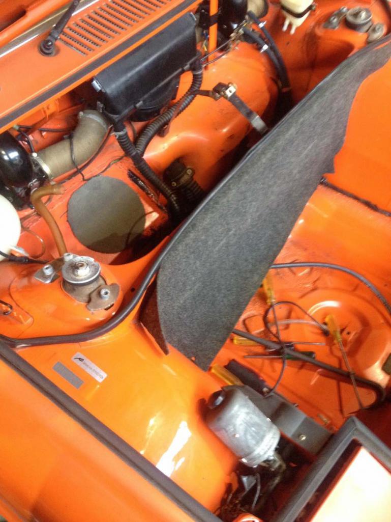

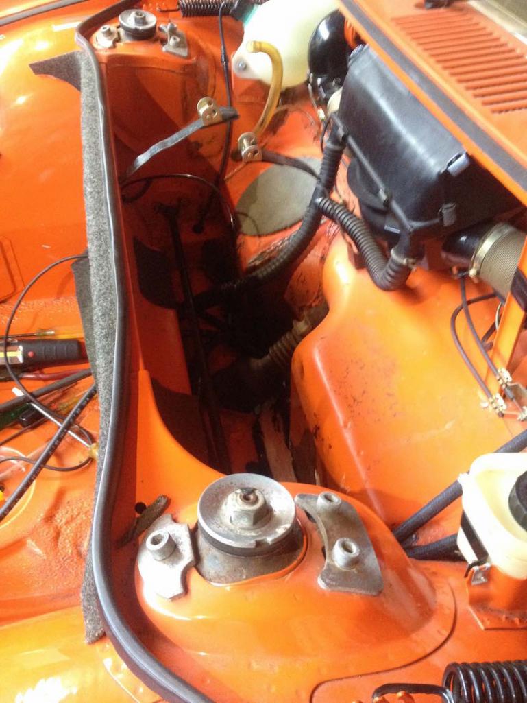

some images of firewall area. tank out for remaking fuel lines recently.
some surface rust starting was found down in the v joint below the fuel tank due to condensation maybe. on top metal surface of the cavity not bottom (underside -road surface). we went back over all the welds from when i converted it and gave seams etc some love/attention 30 years on. tight fit to bring the fuel lines through to the bottom of the tank.
you lose tank connections access port (or its severely reduced in size with conversion), so back then an access hole cut in the front truck firewall hidden behind the truck carpet to assist getting fuel lines on to the tank. the tank loses about half of its lower bulb and has reduced capacity.
some images from last few months. in one of them you can see mods to lower firewall from cabin side. evident where we have been attending to seams and welds. on lh side the original firewall and floor piece for the pedal mounting gets removed and moved across to right as part of the new drivers footwell. a replacement panel is folded and welded in.
another bit of useless information, but all this stuff is sheet steel and welded on my car. would not have thought to have done it any other way, neither would anyone else in the 80s and 90s. i've seen a crayfords car up close and they were pop rivetted panels with mastic sealant!!!!! some of the panels were sheet steel but one of the firewall panels was a fibreglass moulding. no welding! the 1970s!?
Attached Image Attached ImageAttached Image
