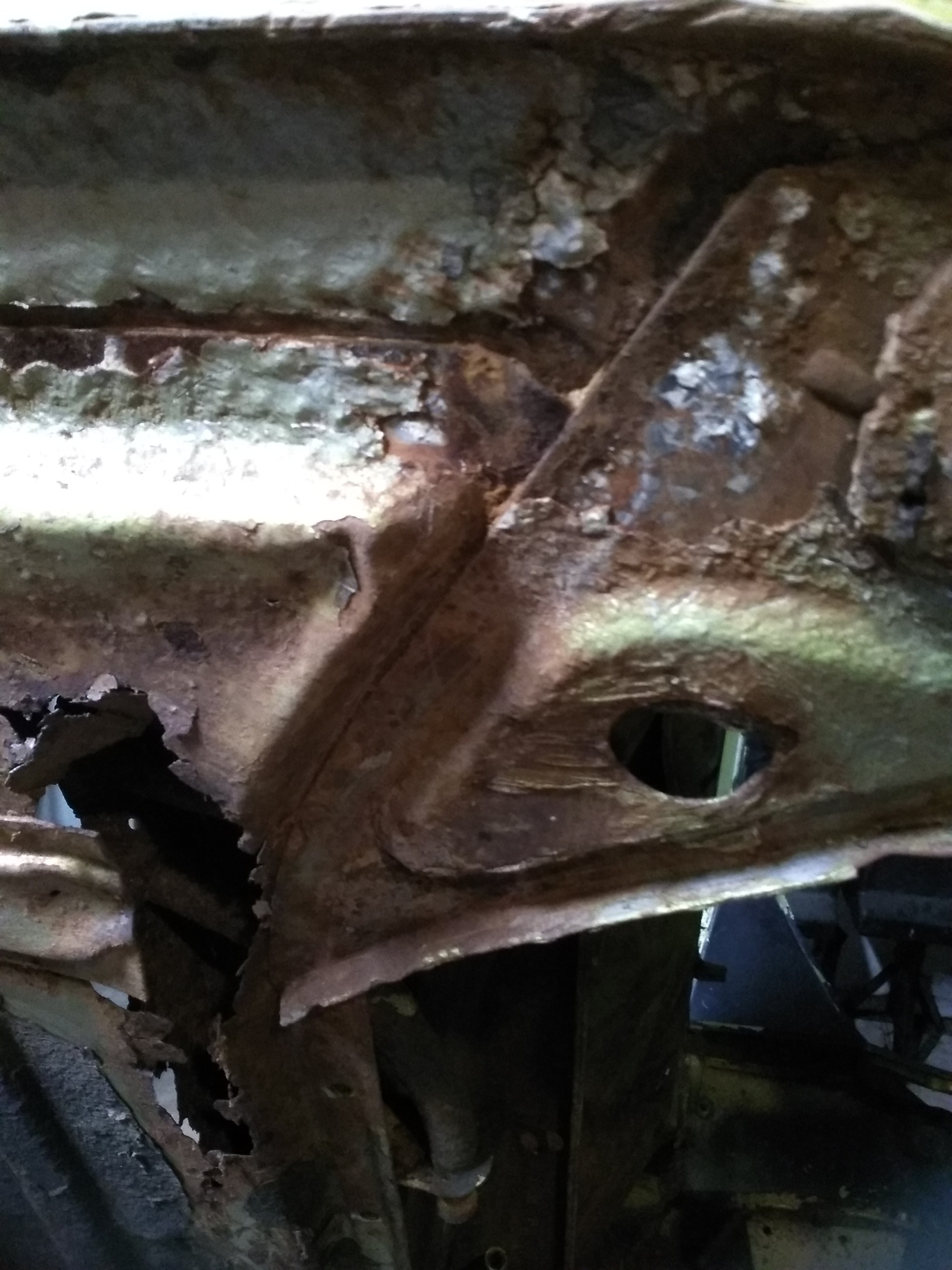

I am replacing the cross members and inner firewall longitudinal. The picture is the worst of it. Want to make sure i get the best parts i can before the work begins. The only thing i havent figured is how to get the floor pan between the support in the engine well and the outer firewall longitudinal. Any ideas there?

It looks like the floor pan fits above this bracketAttached Image
Duane921
post May 10 2020, 06:36 PM
Posts: 17
Joined: 29-August 13
From: San Antonio, Texas
Member No.: 16,322
I am not sure how to get the old floor pan out and the new one in here.

That bracket gets taken off as part of the floor removal and replaced after the new floor is in. You can salvage the ones you have if they are in good condition. The easier way is to order those when you order the floor. Look in the kits section of the RD web site. They have package deals for floor replacement. Can't remember if there is a package deal for just rear replacement but take a look.
Floor pan removal is easiest with the car on a lift or, better yet, a rotisserie. You cut out all the spot welds around the perimeter of the floor and along the tunnel and cross member. A Blair spot welder cutter set is great for cutting the spots. You can cut the tunnel and cross member welds from inside the car but the perimeter welds have to be done from underneath unfortunately. It will be a lot of work, but rewarding.
