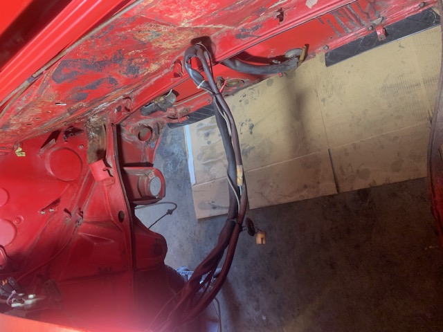

kroelofsen
post May 14 2020, 09:10 AM
Posts: 101
Joined: 27-June 19
From: The Netherlands
Member No.: 23,255
Region Association: Europe

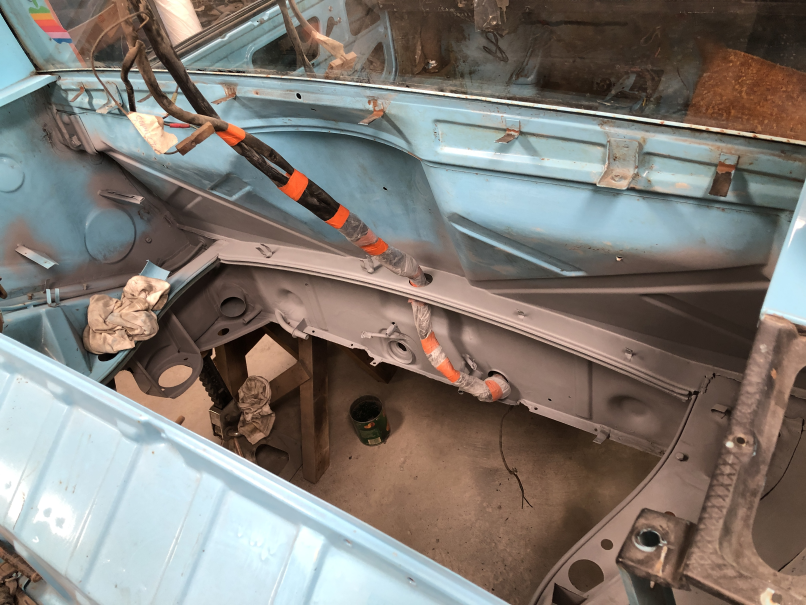

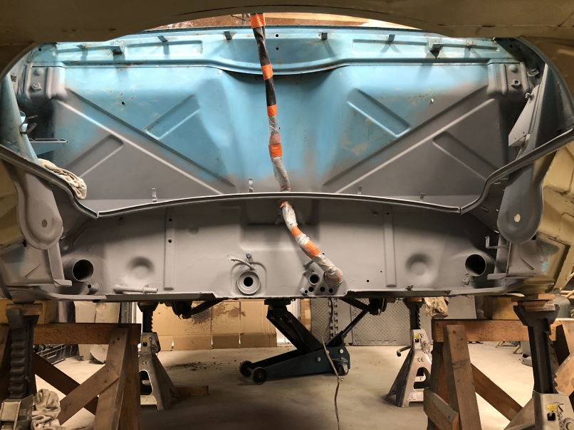

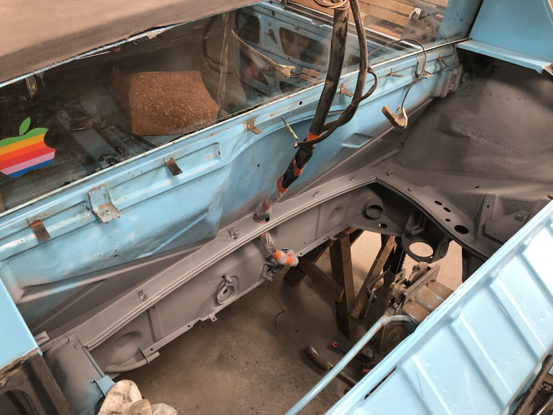

Hi, I'm in the same process right now... Lots of corners etc to work on. Also lots will be covered by equipment in the engine bay. Because I had to do welding on hell hole and jack points I stripped most of the engine bay.
Hope this helps... I covered the wiring loom / snorkel with plastic and wrap it with tape to keep it out of the way...
PS Battery tray not yet in... And before spaying I will remove the rear window...
