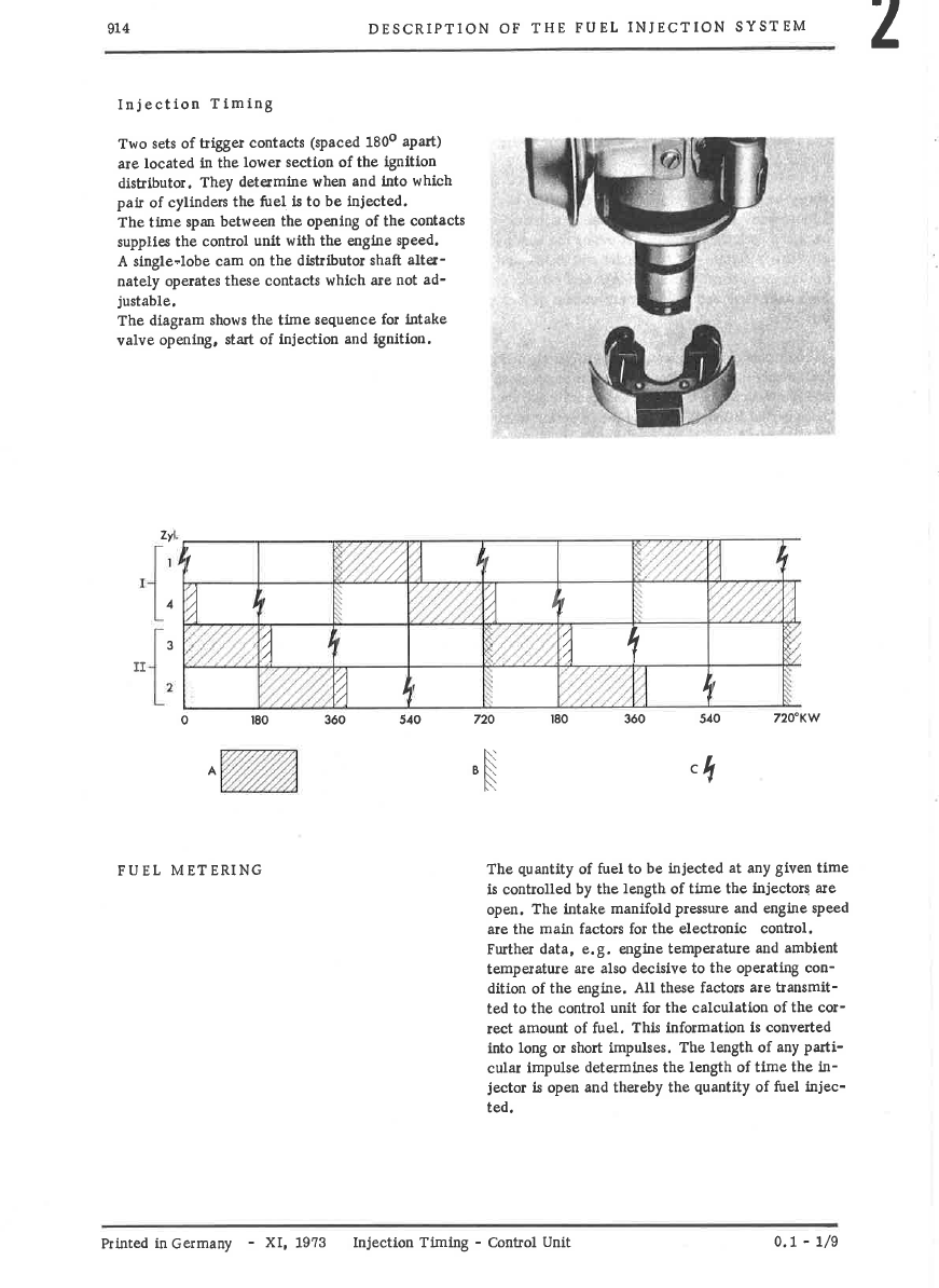

Hi All-
I recently installed a 123Ignition dizzy in my '73 2.0. It apparently can be installed in any of 4 orientations, in 90 degree increments and operate properly when wired to the plugs appropriately.
The d-jet version of the 123 dizzy also has two wires that are used to time the two groups of fuel injection pulses (cyl 1+4 and 3+2). These wires can be connected to the ECU in either polarity, and the "correct" polarity to time/phase the injection pulses seems to depend upon both the distributor orientation, and the wire polarity. Instructions from 123 Ignition show a connector sketch that "suggests" a particular polarity, but I think the correct one also depends on the chosen dizzy orientation, as well as the firing order. (The dizzy can be used in non-914 applications. E.g., with a straight 4.)
I'm an EE. I've been through Paul Anders' ( @pbanders ) very helpful writeups on the ECU and d-jet operation. I've got d-jet schematics. And, I've got a generic (Volvo?) chart purporting to show the injection timing WRT the cylinders (which seems to have a lot of discrepancies with a 914 setup with different firing order.) I've also looked at the injection pulse/spark timing with an oscilloscope (with a high-v probe).
It looks like the orientation and polarity can be adjusted to inject fuel at any of the following times:
1) Inject cylinders 1 and 3 during intake stroke and cylinders 4 and 2 during exhaust stroke.
2) Inject cylinders 1 and 3 during power stroke and cylinders 4 and 2 during compression stroke.
3) Inject cylinders 1 and 3 during exhaust stroke and cylinders 4 and 2 during power stroke.
4) Inject cylinders 1 and 3 during compression stroke and cylinders 4 and 2 during intake stroke.
I think the choice of the 4 options above would affect the dwell time of the fuel charge in the intake runners and might also cause some raw fuel to be sent out the exhaust if a pulse occurs during valve overlap.
Which of the 4 configurations is correct? Is my analysis correct, or did I miss something? Any other advice you can give me?

JeffBowlsby
post Jul 15 2020, 06:59 PM
Posts: 9,392
Joined: 7-January 03
From: San Ramon CA
Member No.: 104
If I recall, DJet squirts a 50% charge in two batches paired as cyls 1+3 and 2+4, which is different than you indicate, but it may not make any functional difference. Lets start there.
https://bowlsby.net/914/Classic/zTN_Man04.pdf See page 7
Not_A_Six
post Jul 15 2020, 07:13 PM
Posts: 110
Joined: 28-November 18
From: North Idaho
Member No.: 22,682
QUOTE(JeffBowlsby @ Jul 15 2020, 05:59 PM) *
Thanks, Jeff! I hadn't seen that doc yet.
Tracing the cable numbers 3-6 on page 226 (aka p.8) of your doc to the corresponding pins on the ECU schematic *looks* like it fires 1+4 as a group, and 2+3 as a group. But, it's entirely possible that I'm screwing this up somehow. Also, with a scope, I've been able to confirm a single fuel injection pulse per distributor revolution for each group of cylinders. (It's the timing between the FI pulse and the spark for a given cylinder that I'm wrestling with at the moment.)
Any guesses?
Cheers! (IMG:style_emoticons/default/beerchug.gif)
PS -- a second thanks for your "tech notebook". It's been really valuable!

Jeff, after further reading of your doc, I came across this jewel on p. 225:
"Fuel injection valves are parallel connected into groups of two (group 1 = cylinders 1+4; group 2 = cylinders 2+3). Both fuel injection valves of one group inject fuel at the same time. The injection valves of cylinders 1 and 3 inject fuel past the open intake valves, whilst the injection valves of cylinders 2 and 4 inject onto the still closed intake valves while the exhaust gases are being forced out."
This would seem to correspond to scenario #1 in my original post. I can easily configure the 123 dizzy to match this.
Thanks for your help! (IMG:style_emoticons/default/smilie_pokal.gif)

JeffBowlsby
post Jul 16 2020, 10:38 AM
Posts: 9,392
From: San Ramon CA
Member No.: 104
The trigger points contain 2 switches which each initiate an injection pulse 180 degrees dizzy rotation apart, each switch firing a bank of two paired injectors.

Not_A_Six
post Jul 16 2020, 11:44 AM
Posts: 110
From: North Idaho
Member No.: 22,682
QUOTE(JeffBowlsby @ Jul 16 2020, 09:38 AM) *
Sure. On a '73 2.0 d-jet 914, the pulses are the "B" ones in that diagram. One pulse per cylinder per 720-degree I-C-P-E cycle. (with 180 degrees of dizzy rotation corresponding to 360 degrees of crank rotation.)
Do you agree?
Thanks.
GregAmy
post Jul 16 2020, 12:02 PM
Posts: 2,725
Joined: 22-February 13
From: Middletown CT
Member No.: 15,565
Bosch D-Jetronic is "batch injection".
Edit: look at the attached file, traces AA-AB, 5-10, upper right corner. Injectors are batched together and two are fired simultaneously. "Batch injection".
