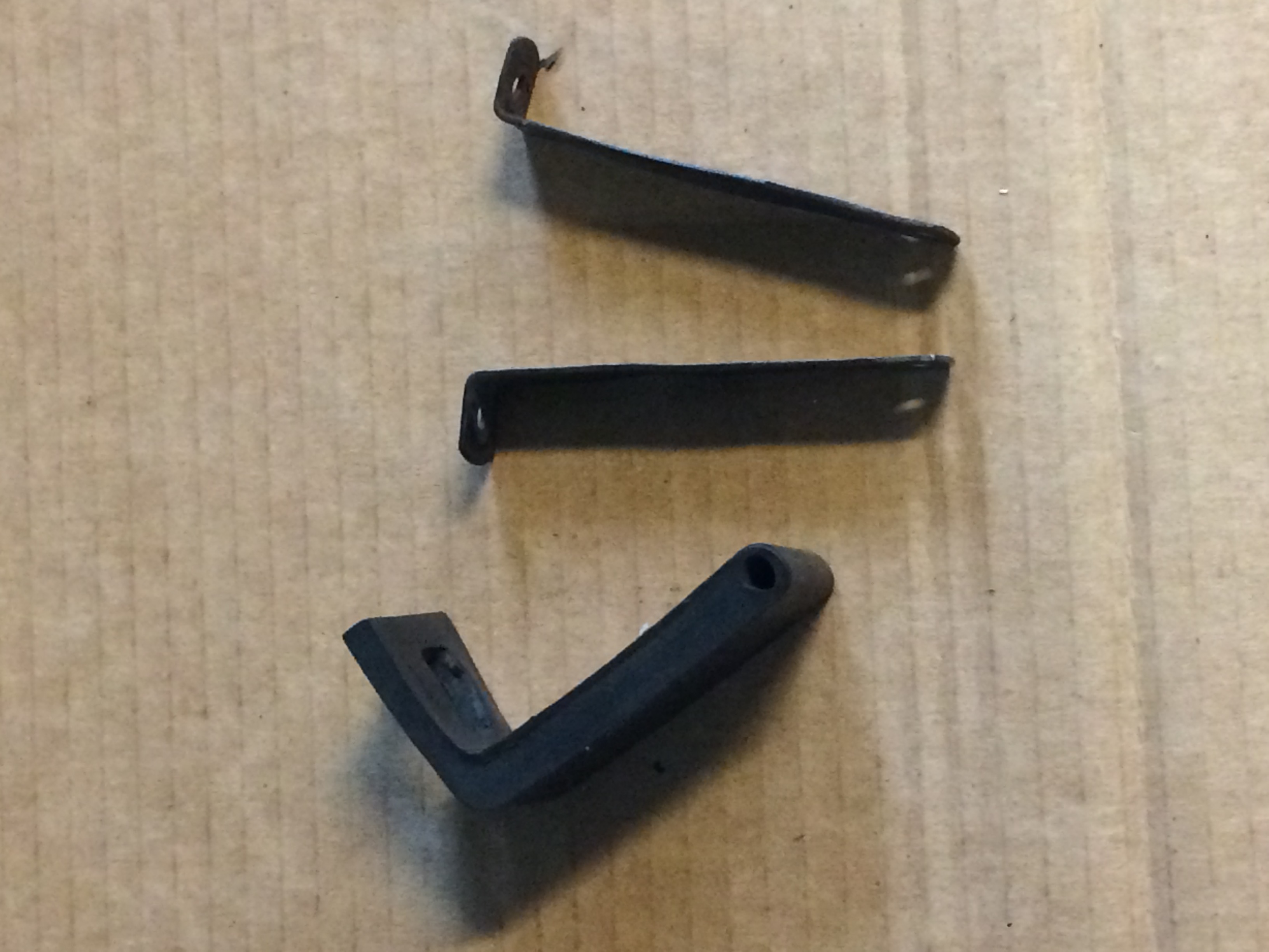

good morning everyone.
question... these thin metal brackets...
are they a part of the engine lid rubber bumper?
or perhaps something else.... related to the drain pan mount?
thanks for the advice

Drain pan brackets, early version

QUOTE(914Sixer @ Sep 15 2020, 10:48 AM) *
thank you!

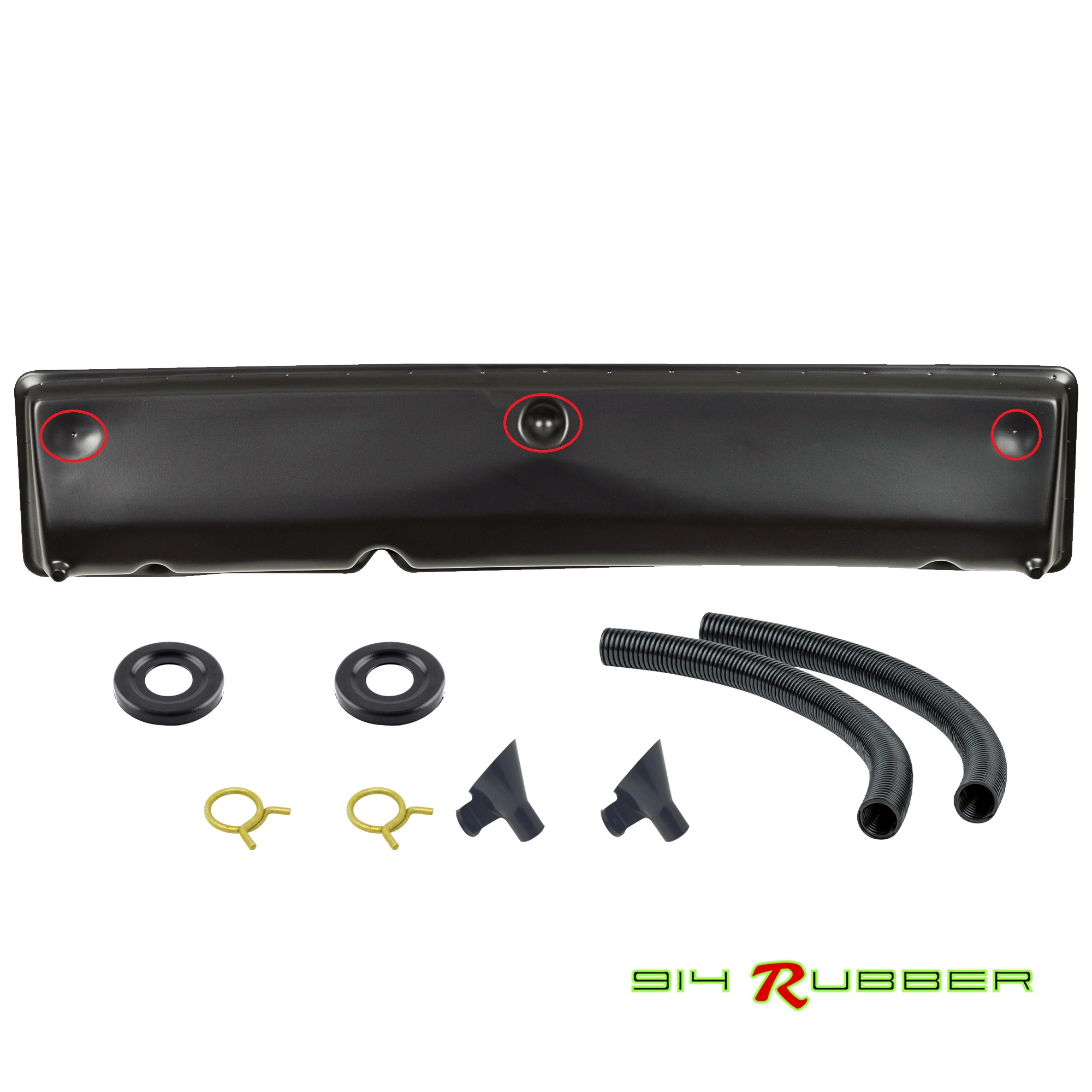

Yep they slide up on the mesh panel pronds at the center and pop rivet to the rain tray right here
