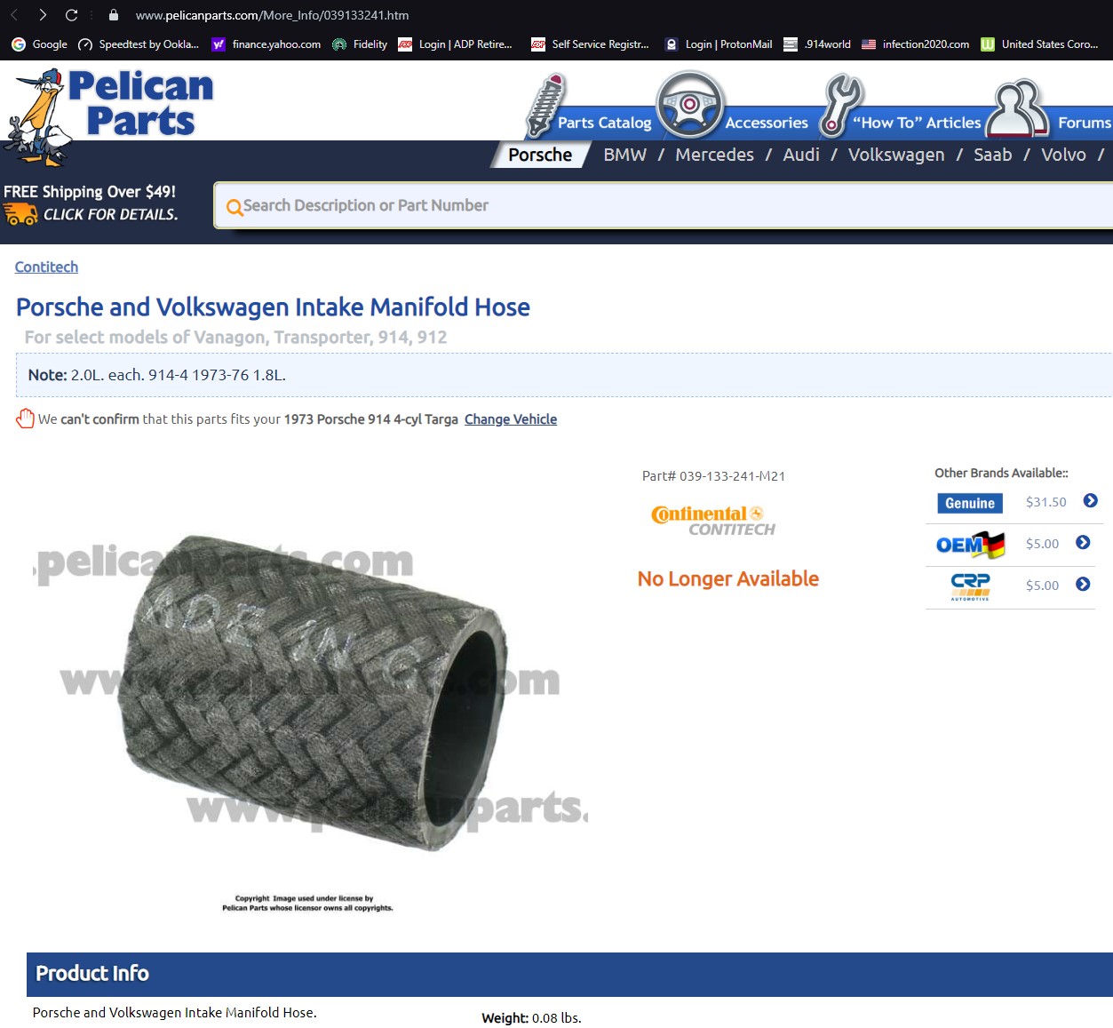

I can't seem to find 1.7L intake manifold hoses - when I check fitment for my 1973 1.7L the suppliers give me the red light.
Any links/suggestions?
I read an old Pelican posting where Dave said that people had resorted to using clamps on the old hoses (despite potential expansion issues).

Nobody makes the 1.7L intake hoses any more. You can use the 2.0 hoses, but you'll need to add hose clamps on both ends of each hose. That's what I had to do on my previous car (a 1.7), and I never had any problems with the hoses or the clamps.

Thanks, Bill. Is that because the 1.8/2.0 hoses (and runners) are a larger diameter?

I bought of a foot of this and used it.
https://www.mcmaster.com/5285K137/
At first I sourced a generic braided hose that mimics the factory boots but it was steel reinforced and quite stiff so I didn’t bother using it. I believe I still have it if you want to give it a try.

I bought a set of 1.7 hoses from Parts Heaven before they closed and i still used clamps on them. The 1.7 and 1.8 runners are the same as far as i understand.

I think that he is talking about the 4 short braided hoses from the plenum to the intake runners

1.8 and 2.0 are the same diameter. 1.7 are slightly smaller.

I meant these:
Mark - I just found them on your website and ordered them:
But I can't find the complete vacuum hose kit - I bought a bunch of items from you this weekend, but couldn't find these . . .can you please add it to my items? Just pm me or call - whatever's easiest.
