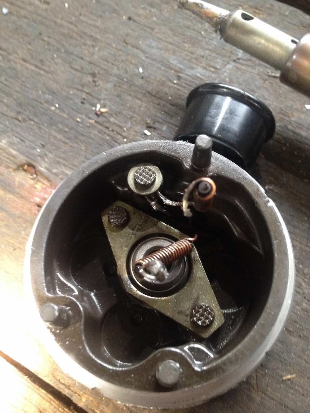

STEP 3.
step 2 gets you to one of the internal leak failures. the big o-ring sealing the motor housing. i inspected this o-ring. it was hard on one side and had definitely been leaking. but there is one more seal to go. the electrical plug.
Additionally at this point you can inspect the commutator and brushes on the electric motor. Mine were in good condition with reasonable level of wear. made sense. the car is a two owner car with 44 K miles and its been dormant for the last 16 years. the pump is worth saving assuming i can solve the leaks with new seals.
Moving on. Electrical plug removal.
at this point you have to get the lower part of the port/pump housing apart and detach the motor.
first. there are two electrical connections rising from the plug to the brush holders.
these wires are like springs at the brush ends. take a soldering iron and release the solder joints so they are free.
next there are three spring washers which hold the pump/port housing together. work these off with a fine pick and a small fine screwdriver.
finally drive out a very small pin which secures the motor axle to the top of the pump housing. you will need an ultra small pin punch, less than 2mm. or 1/16 in imperial size.
be careful driving the pin out. i secured the axle in a vice with soft jaws and placed a rag below the vice to catch the pin. you do not want to lose this pin, its very very small.
pull the motor out of the pump/port housing.
carefully lift the internal face of the pump/port housing up threading the spring wires through it as you go.
once apart stop there.
you will be looking at the back of the electrical plug and if its a 009 pump it should look like the last image. there will be an earth wire, going to a stamped pin and the same stamped pin holds the sprung wire that connects to the brush holder on the motor section you have detached. to note. a 005 may not look like this. at some point i will know as i have a 005 to disassemble, but i have not done that yet.
Attached ImageAttached ImageAttached Image

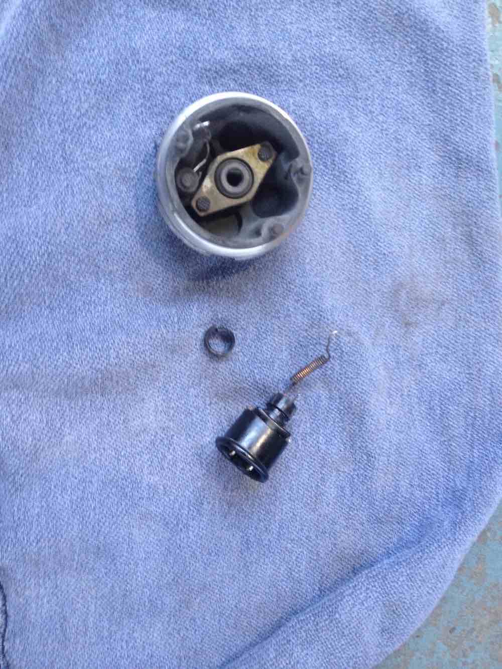

STEP 4.
snip the earth wire to the plug. as close as you can to where it is connected to the stamped clamp. you can resolder this later to reconnect it.
carefully ease out the electrical socket. lots of wiggling and gentle coaxing.
it will be gummed on and take a bit to get it to release but you don't want to tear it out with force or you risk breaking off the two electrical connections at their base.
if that happens things can get harder to repair.
look for the o-ring. in my case there was not much left of it. this was the source of the main leak.
collect all the o-rings up.
the 0-ring for the motor casing is likely a 51x2.5mm and the electrical connection is a 7.8x1.9mm i think, but it was squashed very flat, so i may experiment with this by getting a couple of different sizes to get the correct final fit.
This is where i have gotten to until i obtain all the o-rings.
more when i begin reassembly next week or two.

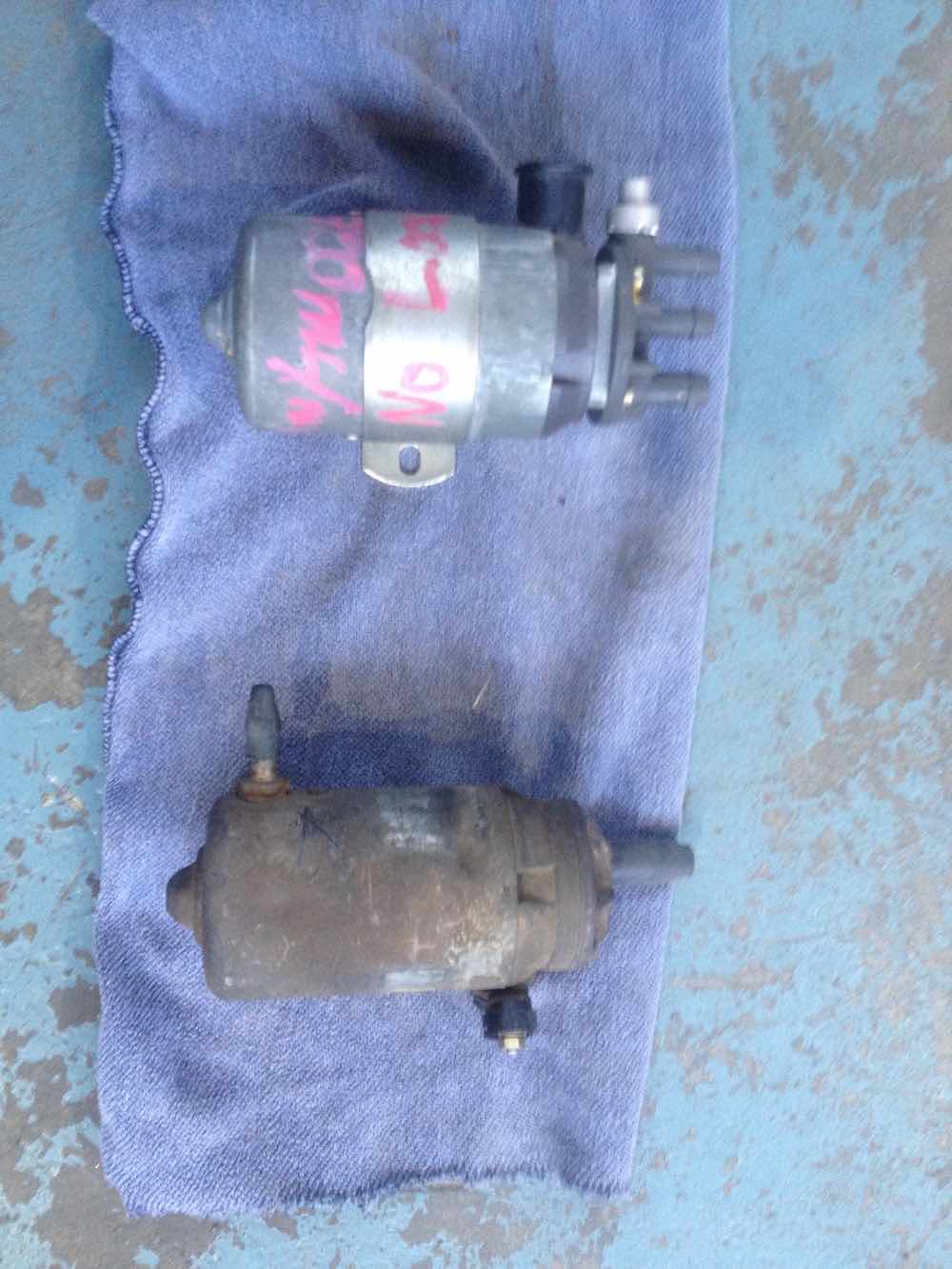

POST SCRIPT.
there are a couple of similar 3 port fuel pumps lying around in the workshop which have been thrown at me to investigate, given i got the 009 apart.
one is a 005 that was taken out of a 1974 SAAB EMS.
externally it looks mint. I'm not sure where these were located on a SAAB but must have been a protected position. the pump has been tested and it is below flow specs at 700ML per minute. (for a 914 the flow rate is 50L/hr or 833ML/minute).
the other is a similar type of bosch unit that came out of mercedes 600 series.
It took me a day to take the 009 apart, but i took my time and thought about how to do it. It took me less than two hours to get the mercedes unit apart to almost the same level of disassembly, felt confident with the method - though the mercedes unit was a lot more unwilling to ease the outer casing shield apart from the upper port casting. it was in their tight. It was interesting once you got inside it. the motor has what i would call turbulence shrouds top and bottom. white plastic shrouds. these encase the coil windings armature section of the motor. I have seen images of the interior of the citroen fitted pump and the motor had only a top shroud not a bottom shroud. I'm not sure if the citroen unit was a 005 pump but i think it might be. I have yet to take apart the 005 pump that came out of the SAAB so that might be interesting to see if it has a turbulence shroud, either completely like the mercedes or a half unit like the citroen. The citroen ran D-Jet fuel injection.
the mercedes pump has a different arrangement in terms of its pump head, ports and o-rings than the 009/005 units fitted to the 914s. so its not an exact comparison - but i believe early VW bosch fuel pumps for EFI have the fully shrouded armarture similar to the mercedes unit.
in pulling the mercedes pump apart we found the reason for the failure. the electric motor commutator had worn to such an extent a portion had broken off and jammed against one of the brushes preventing the motor from rotating. we might try and get the commutator and brushes rebuilt/renewed if we can find someone who can do it for a reasonable cost. you can still get these pumps new from mercedes but at horrendous cost. so its kind of worth having a go at rebuilding them. anyone rebuilding a 005/009 fuel pump from a high mileage 914 will likely find similar advanced wear of the commutator and brushes and would need to rebuild those parts if they wanted to renew the units.
once i get the SAAB one apart I'll post some images.

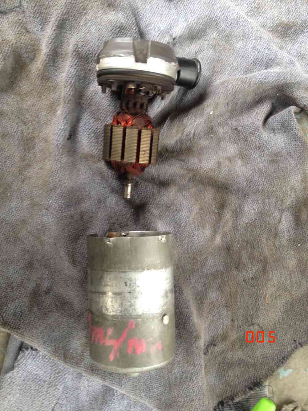

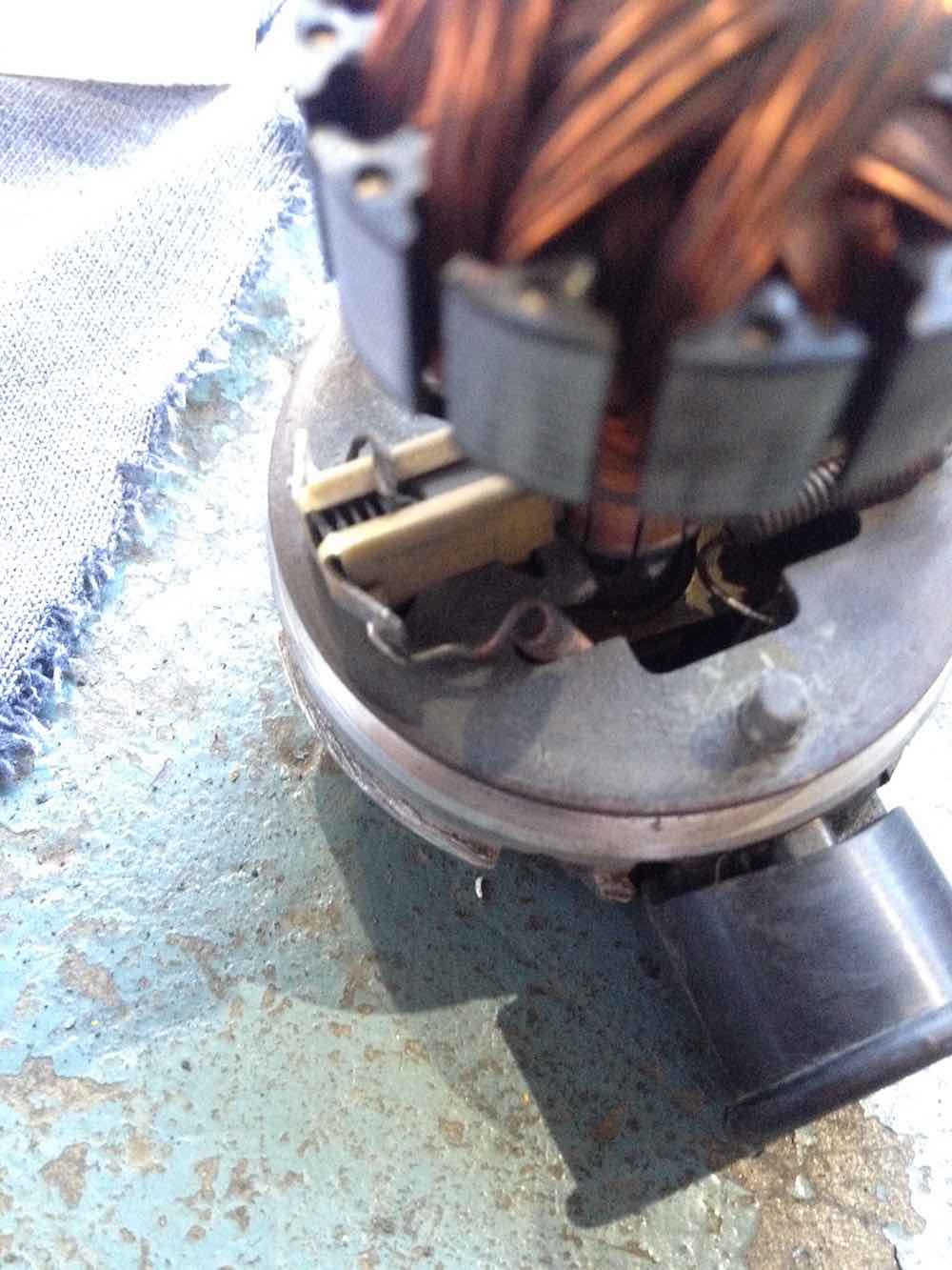

005 Pump.
Disassembled the 005 pump today. Getting better, all apart in about an hour.
The top part of the pump is identical to the 009 unit.
The motor itself is where the differences are.
The armature section (electro magnets) and interior permanent magnets (Fixed to the pump casing) matches the dimensions of the older and earlier mercedes fitted unit but lacks any "turbulence" shrouds (if that is what the shrouds are). In the 009 unit that supersedes it the armature section has smaller sized electromagnets.
The plate holding the brushes and spring wires connecting to the electrical plug is closer to the earlier mercedes fitted unit in layout and components.
Basically the internal components are being miniaturised and reduced in size from 005 to 009. I haven't measured all the different components but the external casing of the 009 looks slightly shorter in length than the earlier 005.
The reason that the 005 has come apart is that it was delivering insufficient flow when tested. at first glance visual inspection we can't seem to find any obvious reason for that. the motor and internals are in the same condition (very good) as the 009 pump that came out of my 914. The 1974 SAAB EMS it was fitted to had done approx 80,000km (50,000 m). The pump came out of the SAAB years (decades) ago and has been stored since.
Comparison images.
Attached Image Attached ImageAttached ImageAttached Image

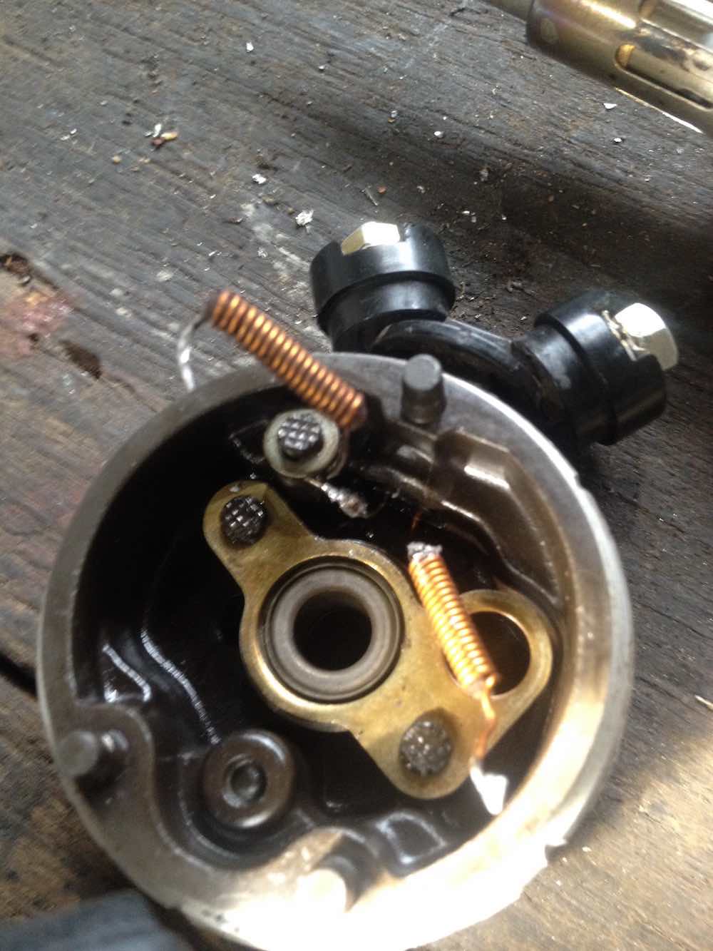

i made photos of the upper section of the 005 pump yesterday during disassembly.
for anyone who still runs one of these 005/009 pumps that might be leaking from the upper section the images show how easy the fix is to fit new o-rings.
however most failures involving leaks or wear will be in the case section.

REASSEMBLY STEP 2
fitting the port housing inner plate & brush holder.
i retained the starlock (or quicklock) washers when i disassembled.
took them off carefully so good to reuse.
if you damage the starlocks get some new ones.
i flattened the starlock tongues using a very small socket to get them to preload again.
i used a slightly larger socket to push them down on the securing pins.
next i resoldered the spring wire connectors to the brush housings.
carefully move the wires into position and push the hook ends through the slots/holes in the connection plate.
i used my original disassembly photos for reference.
fairly easy to see where the wires must go using logic.
very difficult to make errors such as crossing the wires up accidently.
both stay on the sides of the electrical plug they come out of underneath the brush plate.
i did have to melt existing solder out of the holes before i could clip the wires in.
once clipped solder these connections.
soldering went much better than the earlier frustrations i had with the earth wire in plug base.
i repeated the same with the 005 pump i am reassembling.
had to do a bit more work on that one.
different style of brushes and electrical connections on the earlier 005 pump.
one of the brush connections needed some more securing solder repair.
after soldering clean up any loose solder drips, blow out with air and electrical cleaner,
you don't want anything trapped inside this assembly that could later break loose.
