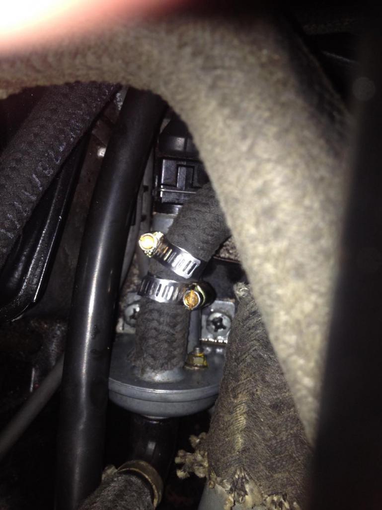

one thing = fuel smell in engine bay on lhs around air cleaner. comes after a few days sitting. had put this down to saturated charcoal cannister, feeding back fumes into aircleaner. have inspected all fuel lines etc thoroughly and no signs of any external fuel leaks/wetness. just a vapour smell thats not there all the time, just after sitting.
pulled everything apart today down there after getting home today.
checked everything. all tight, no air leaks. no bad hoses.
looked at pressure regulator. which sits right there under aircleaner.
i have no reason to think its not original and about 45+ years old.
and did not get replaced. looks great externally, but.........internally?
will get car into shop this week. where i can get some guages on it etc.
at home with car. nothing but basic tools.
but whats thoughts out there.

bdstone914
post Mar 14 2021, 09:16 AM
bdstone914
Posts: 5,422
Joined: 8-November 03
From: Riverside CA
Member No.: 1,319
QUOTE(wonkipop @ Mar 14 2021, 12:01 AM) *
car = 74 1.8 L jet (all intact).
problem =
out driving this morning - gradual then worse loss of power. no accelerator response.
pulled over. cut out. no idle. let it sit for a few minutes. restarted it. got it going.
got up road all right, but symptoms kept coming back, then going away. limped it home.
fun ruined for driving, but fun diagnosing started.
felt like your classic fuel starvation.
background. car has been recommissioned and back on road for about 5 months.
running beautifully.
fuel system entirely rebuilt. clean tank. new fuel lines. new fuel pump. new injectors.
all vacuum lines renewed. all ignition compenents renewed. except coil (which could be original, looks like it, but coil was tested and was a goody).
anyone had this one before.
Test the fuel pressure on the port on the drivers side fuel rail. 28-32 psi is normal Pressure regulators do not go out often.

only reason regulator on my list is the car sat for 16 years. all got replaced apart from it. diaphram might have failed because of bad treatement from me.

doing the check up one step at a time.
got the car to the workshop today, got there without power loss, but the idle was hunting, not badly, just 850 - 950 on the tacho. up and down. it cut out once at the lights just as i got to the workshop after a 20 minute drive.
we hooked up guages to the fuel system. did a pressure and delivery check.
pressure gauge on the injector side of the pressure regulator.
fuel flow on the outboard side of the pressure regulator.
eliminated fuel pressure and flow as well as pump and pressure regulator from equation.
pump gives 39-40 psi, no vacuum - measured with gauge in front of regulator.
delivers 850ml in 30 seconds after the regulator.
we get 32 psi at 18 inches of vacuum.
35 psi at idle with airflow meter on.
30 psi at 3000 revs.

just been on a 340km round trip run up country to euroa for the weekend.
getting much closer to sorting out the problem.
several problems intersecting at the same time?
unsurprising - its been recommissioned after 16 years sitting.
1) i've got rid of the cold start warm up issues.
think it was two things going on leaking air after the AFM flap.
one - throttle body. hopefully new throttle/plenum gasket fixes that long term - in the short term its stayed tight.
two - a collapsing hose from Aux Air Valve for cold start.
i've rigged that so it does not collapse with hose clamps.
result three perfect cold starts in the mornings (one of them reasonably chilly for southern australia at the start of autumn out in the countryside) - no hunting no fuss.
2) i've still got the almost dying and uneven hunting idle but occurs only under the following conditions.
caught in stop and start traffic, on hot/warm days.
listening closely i can hear the fuel pump struggling, making noises, changing pitch.
fairly sure the culprit is the mild steel fuel lines i have run down the tunnel and the section leading from firewall exit to fuel pump. sitting in traffic the car is sometimes sitting in its own hot air and its building up under the car in certain circumstances.
both times on the trip up and back i had the problem at the same spot leaving the city and coming back. a long sequence of about 6 traffic lights with long lines and delays at the lights.
i'm going to try and insulate the lines to protect them from the heat build up.
the fuel is maybe boiling in the line section in front of the pump making the pump cavitate and struggle to make pressure in those conditions?
- think you are right @timothy_nd28 , the fuel delivery is getting in the focus again.
