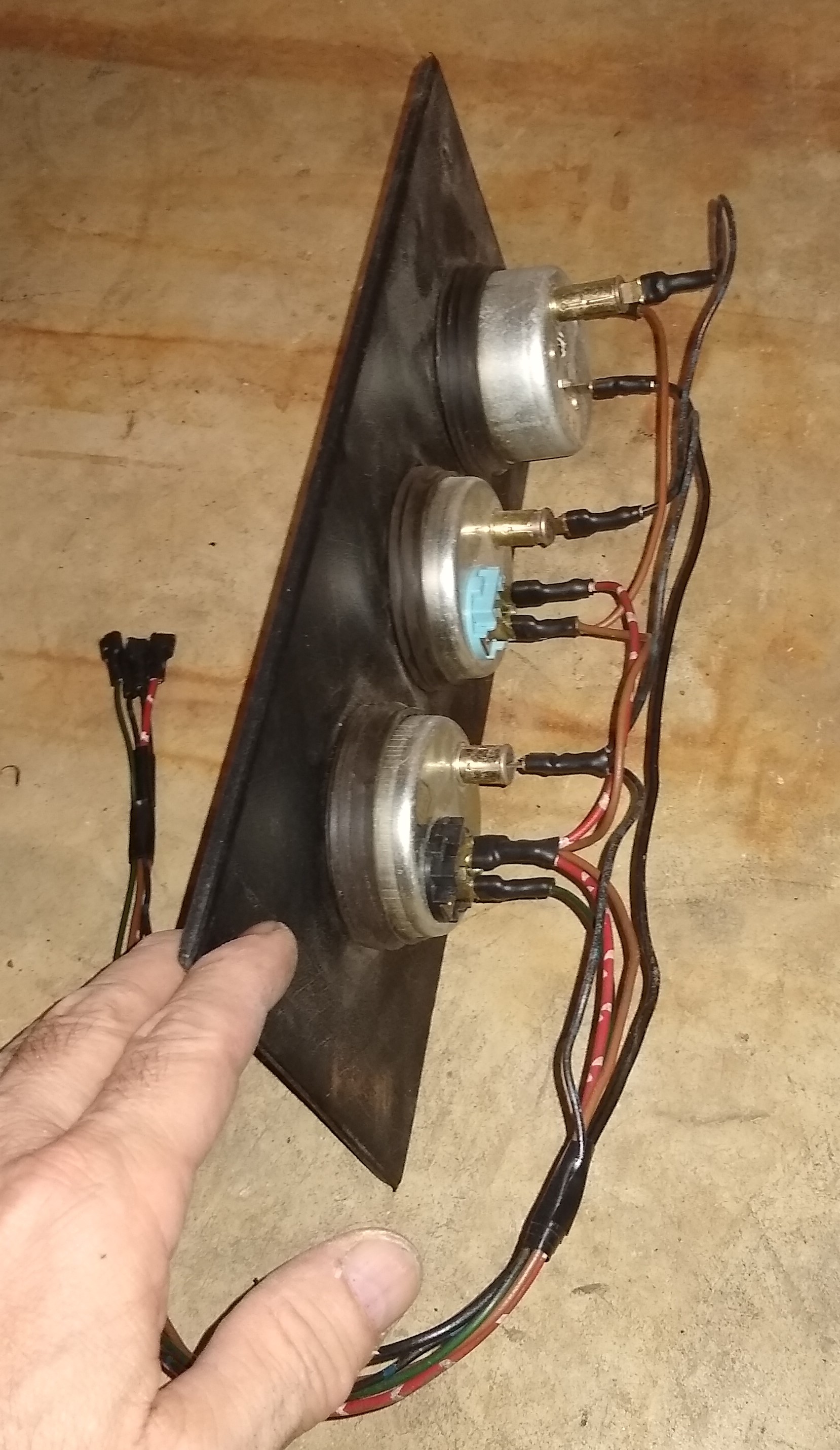

I built a custom wire harness for the center console gauges.
I cleaned and painted my fuse block.

Nice work! All the hours spent on the wiring harness will pay off later.

Really nice work that is going to pay huge dividends when reassembly begins. Especially the wiring harness. (IMG:style_emoticons/default/beerchug.gif)
