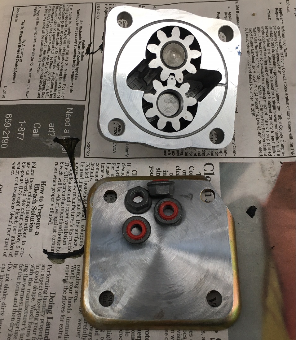

Received my new modified Schadek 30mm pump, new cover, and type 1 oil pump cover nuts this weekend. I took all kinds of measurements on the gears and pin depth of both the one on my engine as well as the new pump to see if I could figure out what happened, or specifically why the lower gear stood too proud against the cover. Couldn't find any smoking gun.
Part of me is tempted to avoid the trouble of wrangling the original pump housing out of the case to replace with the new one and just swap out the gears from the new pump. But I'll probably bite the bullet and replace the entire pump. Could be "fun."
New pump housing with gears, modified cover, and type 1 cover sealing nuts from ebay.
rfinegan
post Aug 8 2021, 04:19 PM
Posts: 1,194
Joined: 8-February 13
From: NC
Member No.: 15,499
Did you go with the Modified Pump from EMW (Jorge)? Fixing the OD pump problem?
