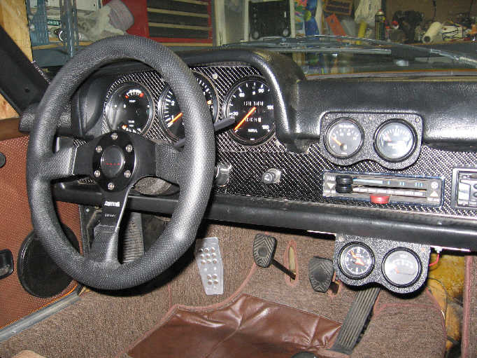

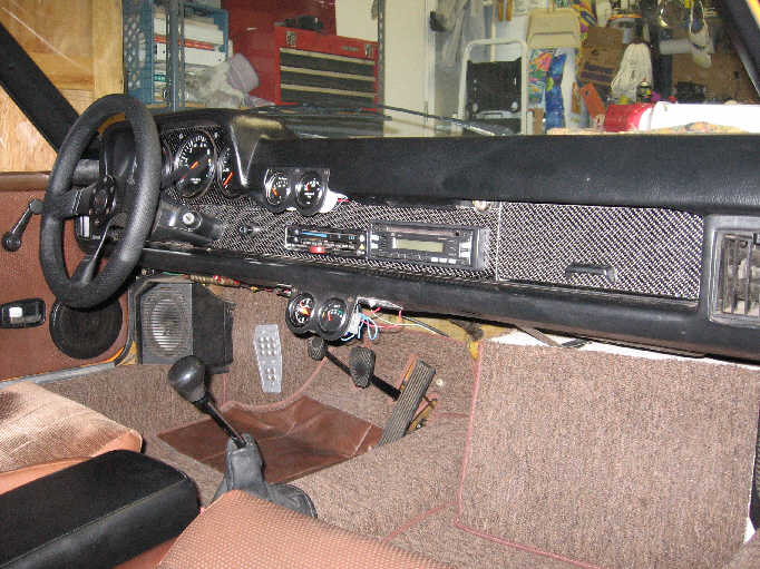

Finally got around to re-doing the dash face in my car. Been a long time coming. Anyway, dash face material is carbon fiber, and finished it off with a new Momo 350mm 'competition' wheel. The thick-gripped, smaller diameter wheel makes the car feel like a video game to drive.
Here's a couple pics. The flash makes the carbon fiber look a bit obnoxious - but it's not. It really just looks like a modern basket weave and is much more subtile than the pictures show.

Looks cool, did you make the dash yourself (with materials from TAP plastics or something) or buy it off of someone?
Demick
post Jul 25 2005, 09:43 AM
Ernie made me do it!
Posts: 2,312
Joined: 6-February 03
From: Pleasanton, CA
Member No.: 257
QUOTE (JmuRiz @ Jul 25 2005, 08:29 AM)
I bought some carbon fiber sheet (already laid up into a flat sheet). I removed the original basketweave material, and then removed the sheetmetal dash face that the basketweave is glued to (the sheetmetal is just taped to the dash face with double sided foam tape. Then I glued the C.F. to the sheetmetal with contact cement, and used a dremmel to cut it to shape. Then I taped it all back into place. I also remove the gauge panel and glove box door and did pretty much the same thing to those.

That looks sharp Demick. It looks like you changed the top (over the guages) as well, but maybe that is just polish.
How many hours was that job?

The top is just one of the ABS dash covers. I've had that for many years (dash underneath is in horrible shape).
Time involved was probably around 4 hours - mostly just a few minutes here and there spread over the course of about a week. Honestly it was easier and faster than I expected.

Looks very nice Demick,
I like how the new material elliminates that weird step next to the radio.

QUOTE (3d914 @ Jul 25 2005, 11:15 AM)
Yep. I never liked that separate piece for the radio. That was something I definitely wanted to eliminate. Also eliminated is the seatbelt warning light (not that it could be seen anyway under my ashtray gauge pod. Also used the opportunity to replace the cigarette lighter with one that actually fits a cell phone adapter.
