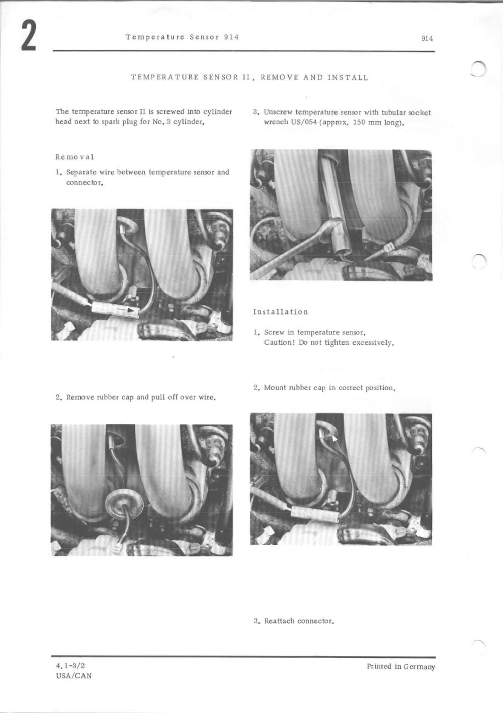

Is the cylinder head temp sensor the one on top of the right bank next to the distributor? Aka single wire connector?
I did my one obligatory cold start this evening to see if fixing the connectors on the dual relay changed anything… it didn’t.
That said, when it’s warm it hums a long real nice and the decel valve is working like a champ.

QUOTE(Van B @ Nov 8 2021, 07:16 PM) *

there is a technique for getting it out.
and the check values as well.
good luck (it is a bugger to get it out but it can be done),
it might have been in there for a long time - go easy with it.
you can test it without getting it out.
some other members here might want to offer some advice before you go hammer and tongs at it.

Wonki, I will pay you money for that manual! Give me that manual lol!
Also, thanks by the way. I’ll chop up a socket and see if I can make that tool.
IMO all these basic sensor are eligible for the modern day remove/replace strategy. They’ve served their time and have earned a retirement. I’ll test it after I take it out and if it’s still good, it earns a place in the spares box!
