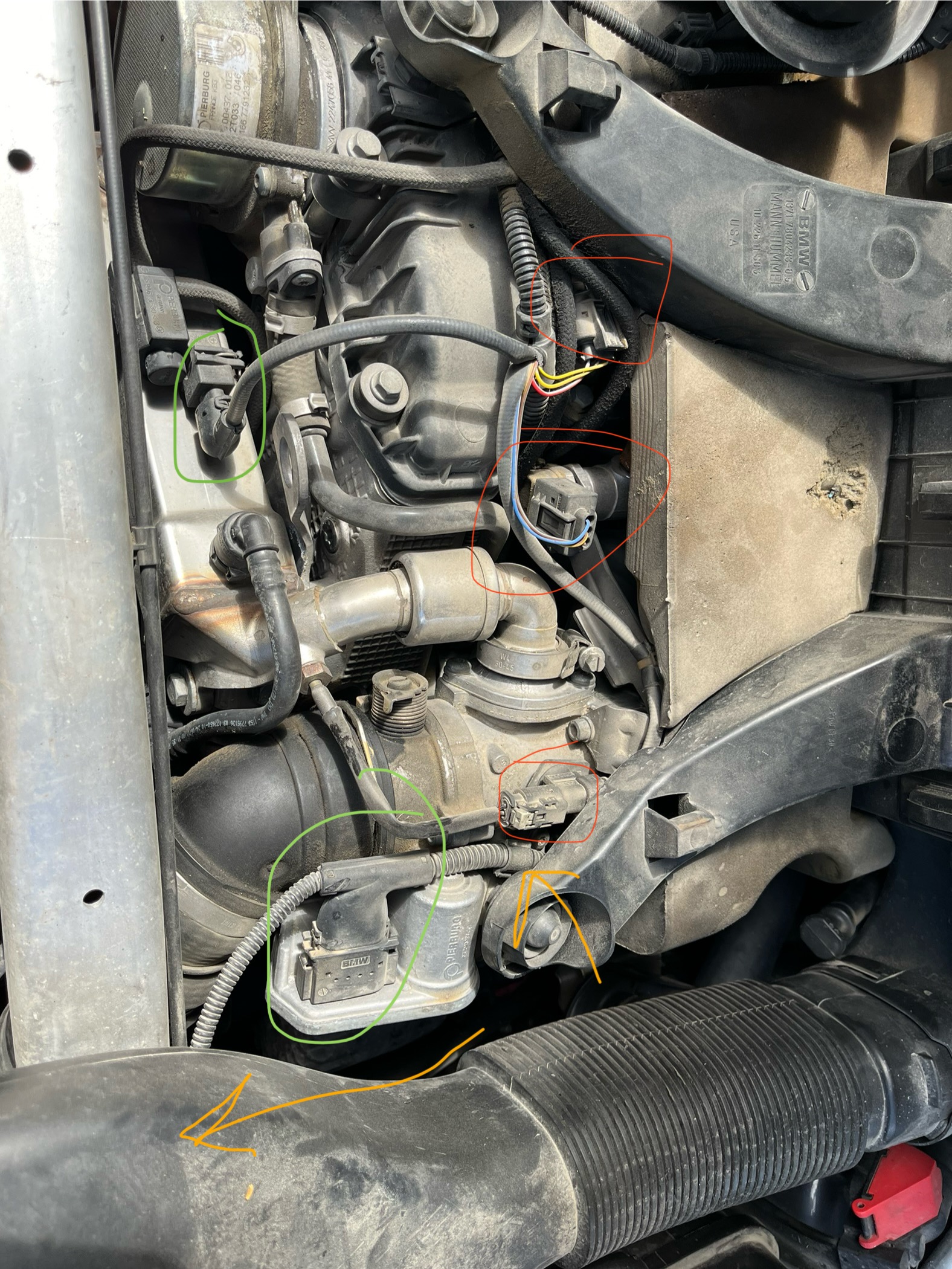

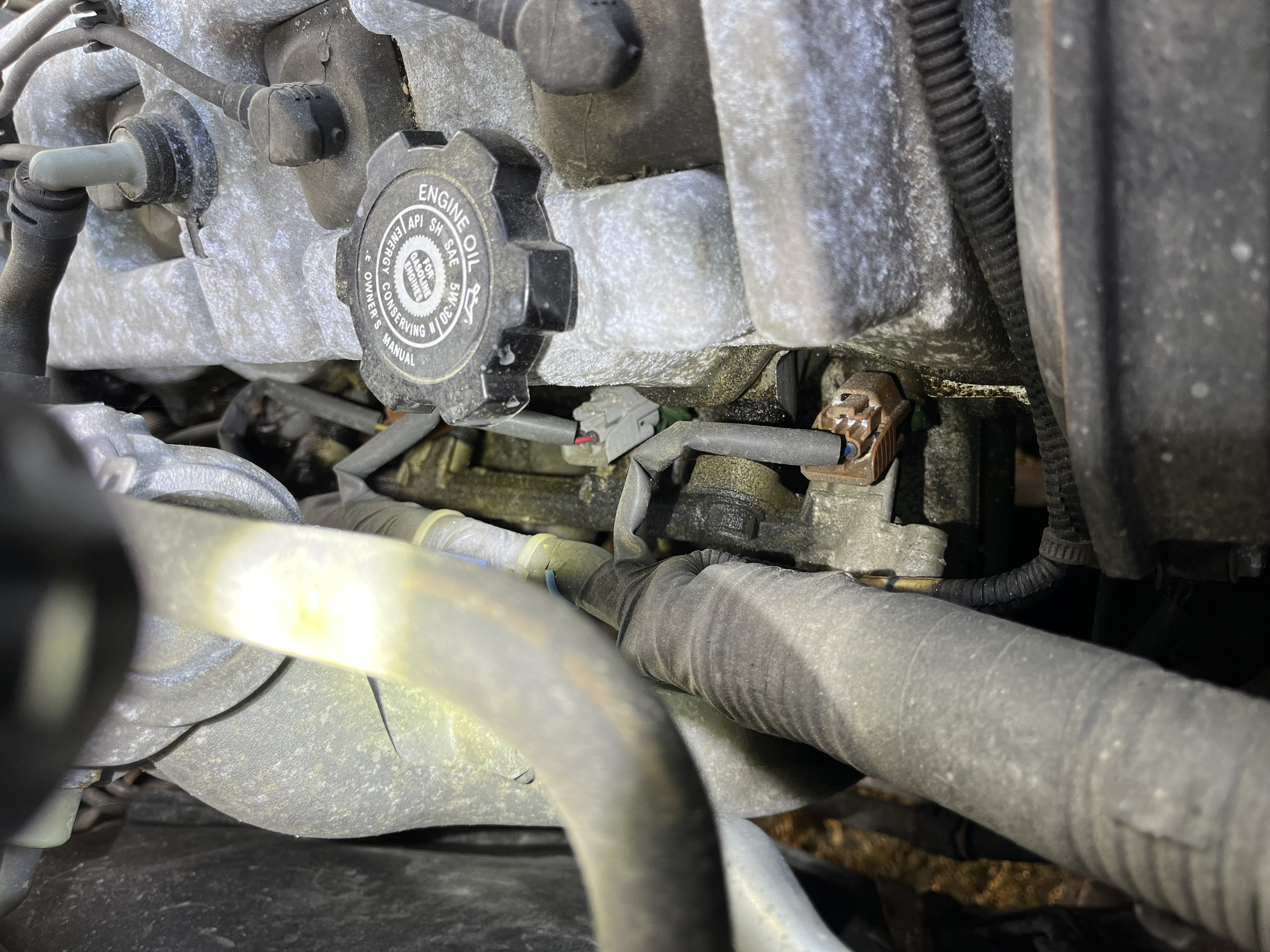

I’m going to post some under hood photos from four different OEMs varying across 20 years of production and with one vehicle that is 30+ years on-road and without issues related to wiring harness or this style of connectors. All these connections are exposed to high temps and potential fluid contamination.
I will also post a couple photos where a full boot is used as you propose. In the cases where a full boot is used, I’ll point out why it was used and the caveats that go with that execution.

1997 Toyota Camry
The Japanese have an incredible record of reliability and durability.
Note: fuel injectors wiring that is on backside of the engine and exposed to plenty of heat.
Note the alternator does have a plastic cap / boot over it to ensure that nothing is accidentally shorted to that high current terminal.

Oxygen sensor - wires potted in sensor but no boot or strain relief required.
Note: emissions systems are mandated to be warranted by OEM 10 years, 100k miles. Emissions systems are not places that OEMs scrimp on due to the warranty risk as well as risk of widespread compliance recalls.
Likewise, this is a very hot location. Attached Image

2012 BMW - 138k miles
Note the varying use - standard connections on non-emissions, non safety components.
There is a boot used on the EGR cooler. An emissions related component. The throttle stepper motor also has a boot because the throttle motor is a safety component. When a boot like this is used, the wiring must be secured nearby to ensure the boot isn’t supporting the wiring which will tend to cause intermittent connectivity issues and/or pin pullout. The wiring for the throttle motor is secured at the locations of the orange arrows to help mitigate those risks.
