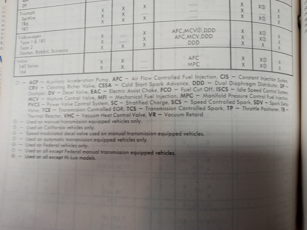

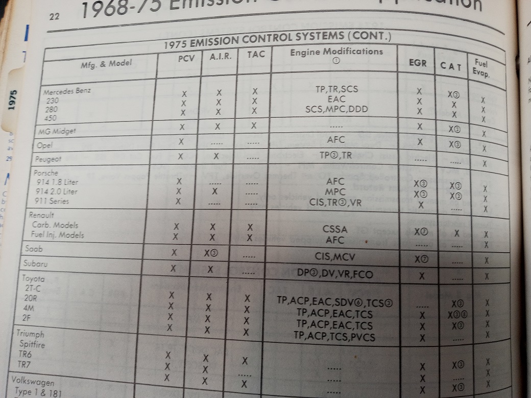

914Mels
post Jan 28 2022, 08:09 PM
Posts: 357
Joined: 20-June 11
From: Santee
Member No.: 13,221
QUOTE(DaveB @ Jan 28 2022, 11:55 AM) *
Need help again. I found out my car was originally from California. Any indication of smog equipment is gone. So how is the smog pump mounted to front of the engine? I've seen the parts and would like to see an engine with this installed.
Thanks,
DaveB
Here are pictures from my old smog book that I used to certify cars back in the 70's. Cat "test pipes" were very popular and usually stayed on long after the "test" was done.Attached Image Attached Image Attached Image Attached Image
wonkipop

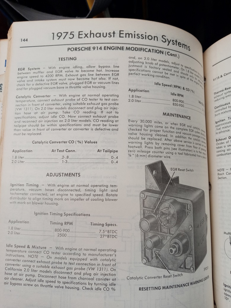

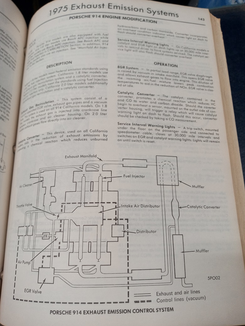

post Jan 28 2022, 09:47 PM
Posts: 5,773
Joined: 6-May 20
From: north antarctica
Member No.: 24,231
neat set of docs @914Mels
@DaveB
attached docs @JeffBowlsby pointed us 74-1.8 owners at last year when he alerted us there was a 49 states and a cal version of the 1.8 in 74, despite other accounts saying it was a 50 state engine.
bit more difference in 75. these docs outline it.
jeff has the whole document (75 training manual) on his website if you want to look it right through.

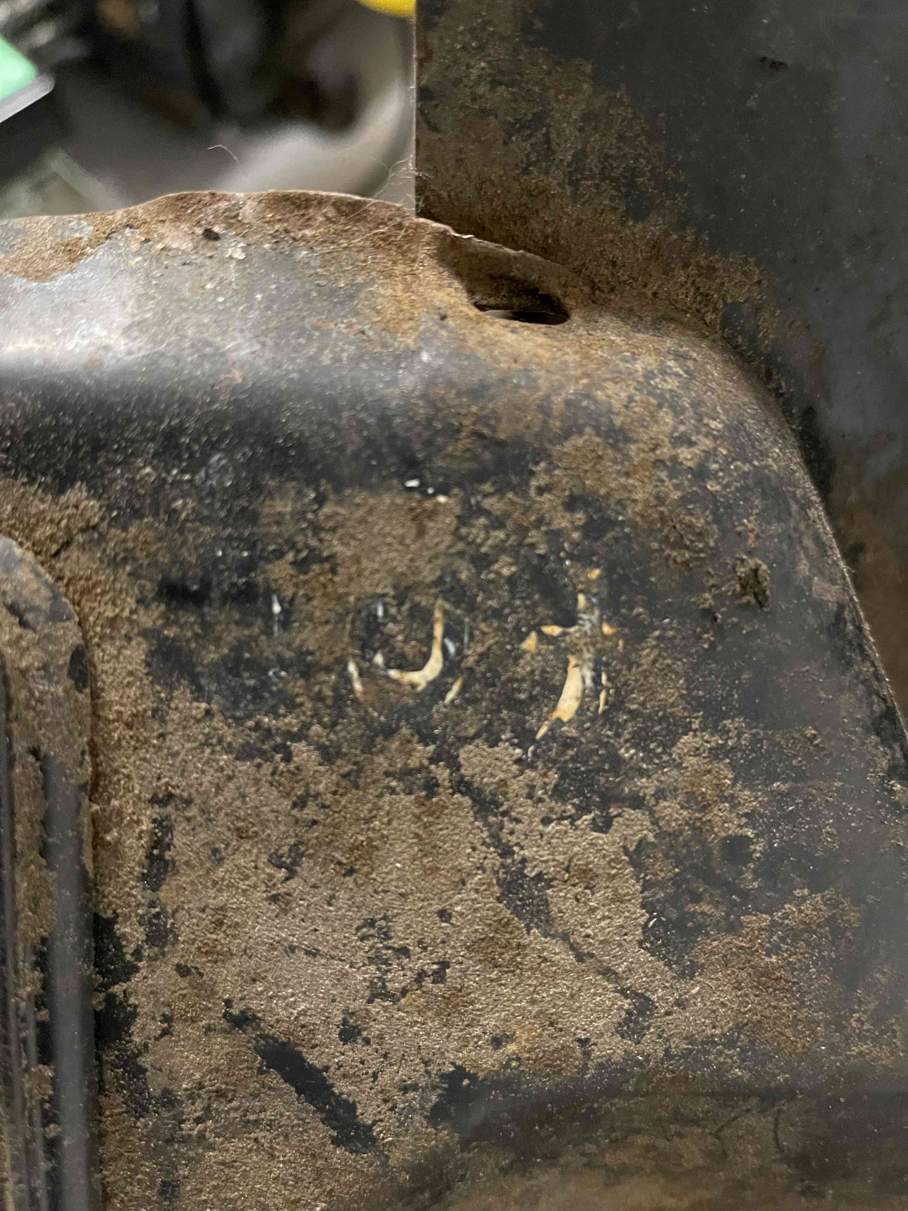

DaveB
post Jan 29 2022, 02:39 AM
Posts: 173
Joined: 25-November 21
From: Portland, Oregon
Member No.: 26,107
@wonkipop
I did find what looks like a stencil mark on the tin. Unfortunately is not legible. This is a snapshot of what I found:
The car is a '75. The engine is a 1.8 but built in late '73, so it's not original to this chassis. Getting the links and info from you and @914Mels helped. I want to understand how it should have been configured to find out what's been done to this car over the years. After I do that, I can figure out how I want to build the drivetrain.
Thanks,
DaveB
Van B
post Jan 29 2022, 09:04 AM
Posts: 1,621
Joined: 20-October 21
From: WR, GA
Member No.: 26,011
Looks like a 604 same as mine. Which is also why there is no indication of an EGR. That engine never came with any of those things.
What’s the engine stamp number?
wonkipop
post Jan 29 2022, 03:03 PM
Posts: 5,773
Joined: 6-May 20
Member No.: 24,231
@DaveB
thanks for the photo. appreciated.
link to a thread in the originality section of this website.
http://www.914world.com/bbs2/index.php?showtopic=357407

@914Mels
those docs you posted are great.
test procedure for EGR makes it clear how it operates at higher revs off intake vacuum (pre throttle plate in throttle body) rather than idle manifold vacuum.
EGR line should be cool after EGR valve to intake boot at idle.
supposed to get warm when you hold it at 4200 rpm.
the EGR let them reconnect to that throttle body port upstream of throttle plate with the distributor vacuum advance port again just like the 49 state cars in 74.
meant you could regain the vacuum advance function of distributor for highway cruise and part throttle just like earlier VWs without causing increase in NOx emissions.
i believe the EGR by feeding in exhaust gases lowered combustion temps and that lowered NOx. you got a bit of benefit reburning some exhaust gas but i believe the main objective of feeding in that exhaust gas was to lower combustion temp slightly at cruise - just enough to get the NOx down.
it wasn't all bad that emissions gear by the time you got to the 75 cal car.
EFI helped compared to carb equiped domestic USA product.
main problem was it was expensive kit that raised the price of the manufacture.
but i don't think it really hindered performance too much.
the big hit on that front was lowered compression for unleaded fuel since the first unleaded fuel was much lower octane.
countries like australia and japan got lucky because we sat back a few years and let it get ironed out in the USA before we adopted the standards. by then all this stuff was well and truly resolved.
