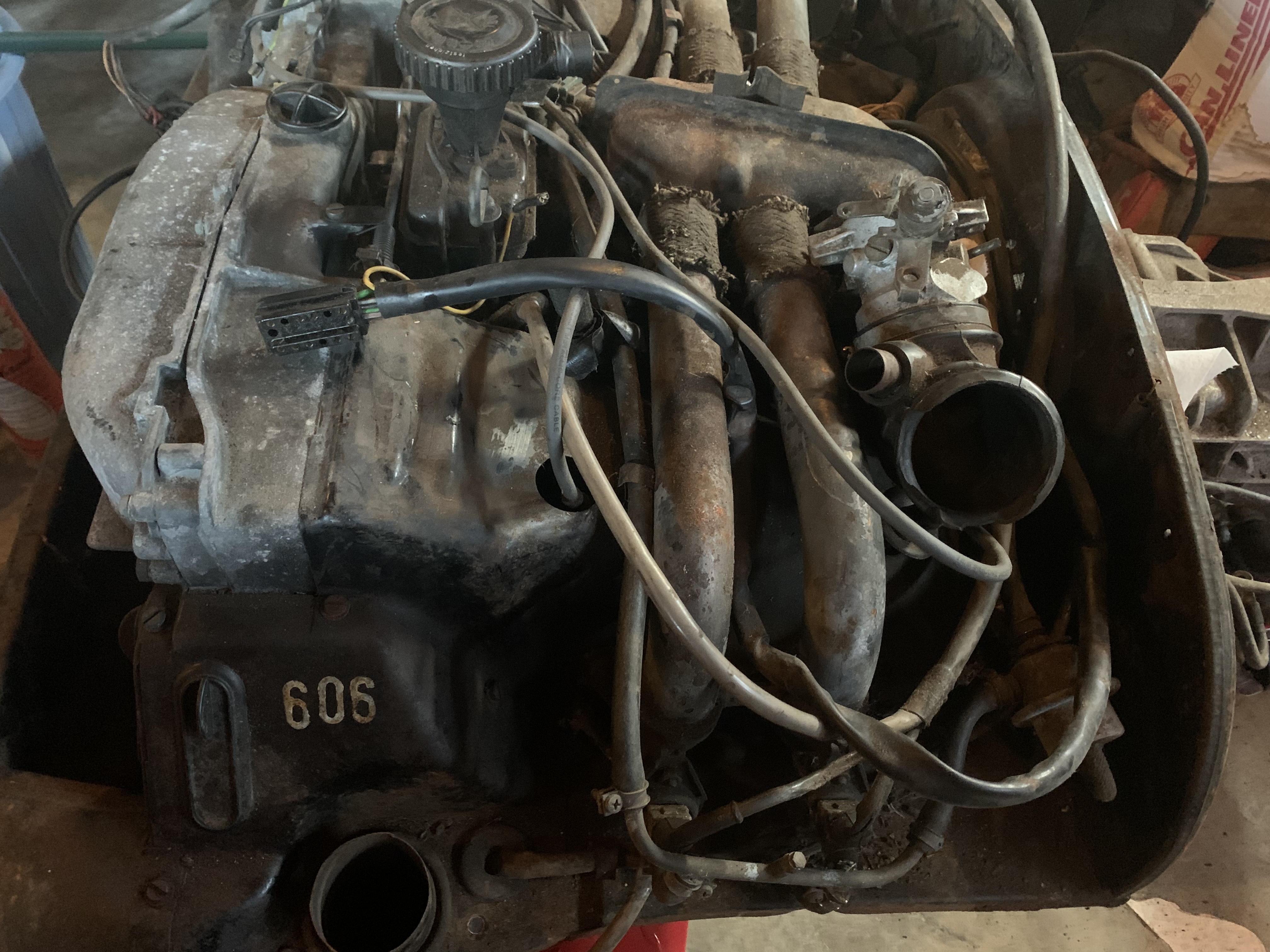

I have a ‘74 1.8L barn find - sitting 10-ish years due to FI issues. The flapper box is definitely tango uniform and literally in 4+ pieces. Other parts have been removed and am sorting through the rats nest of hoses and pieces. The entire system is in question and I really don’t want to try to find hard to find parts.

Also, I don’t recognize the stamp on your engine tin… @wonkipop
If you decide to press, I’d like a shot at your L-Jet parts please.
well spotted Van B
some of them got that engine stamp EA370
@JeffBowlsby has documented a few.
they seem to appear on the early cars in production runs.
i did come across one on a early 74 and also one on an early 75.
it will have the other number as well.
@CSoso
can you have a look at your engine and tell us what the stamped painted number on it is.
maybe take a photo and post.
will be a 604, or 605, or 606 or 607. (IMG:style_emoticons/default/beerchug.gif)

I did find a “606” on the driver’s side engine tin and a “I.0” on the passenger side front. (I have pics but can only load one due to size). That makes sense as this was originally a California car and wandered to Michigan approximately 15-20 years ago, spending the last 12-ish in storage with the FI torn into. Sticker on driver’s side engine compartment shows it being an “A” engine (verses the later “B” version).

Something strange about that intake boot. Doesn’t look the same as a ‘74 or ‘75 9141.8L intake boot.

@CSoso
thanks very much for taking the trouble to record those numbers and post up image.
(IMG:style_emoticons/default/beerchug.gif) (IMG:style_emoticons/default/beerchug.gif) (IMG:style_emoticons/default/beerchug.gif)
according to material we have found you have a california spec 74 1.8
if it still has its original throttle body it will only have one port for vac connection.
low down on front facing side (front of car side).
but it might have a different throttle body on it now.
