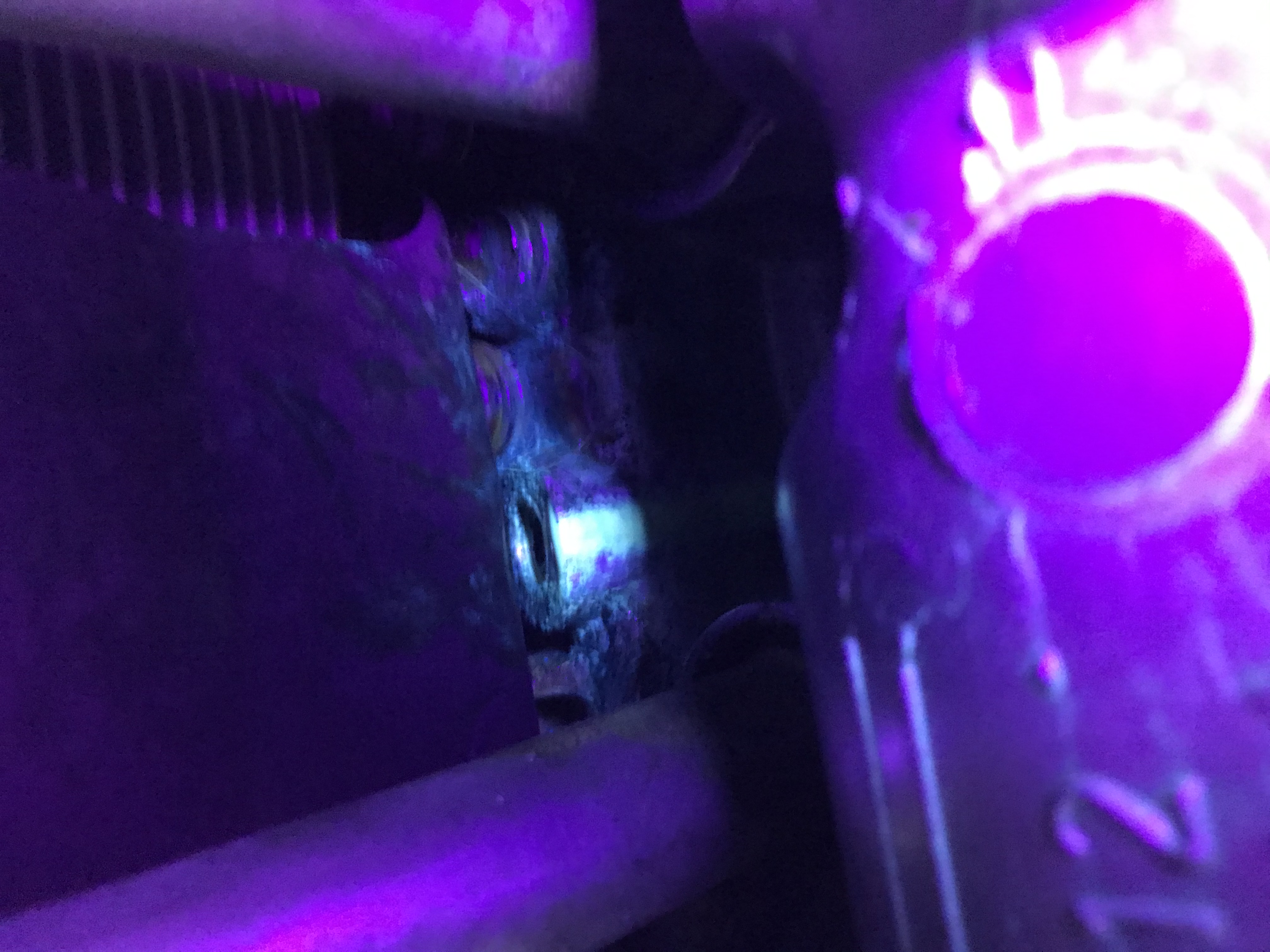

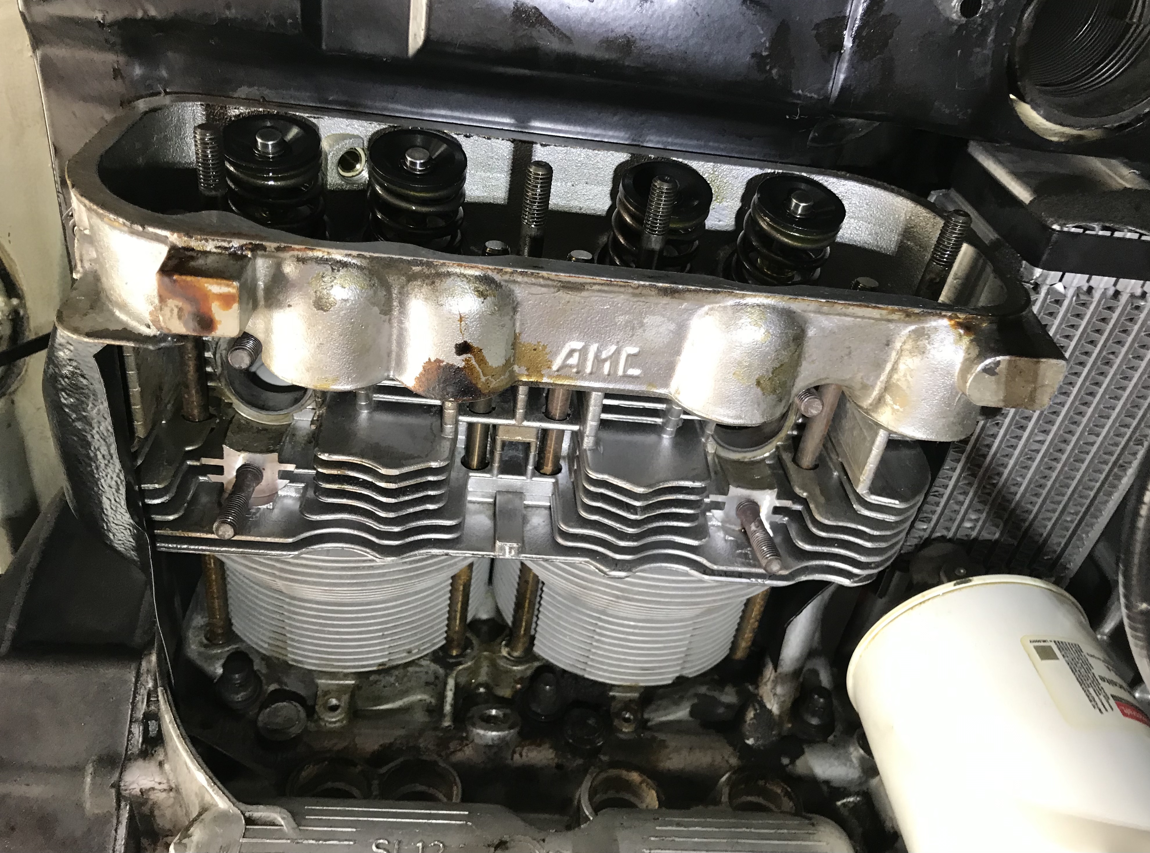

Hello,
I am trying to repair a leak in the oil gallery under cylinders 3-4
As you can nearly see, the air deflection plate is up against the leaking clean out plug.
I would like to know from someone who has done this before, can I remove the rocker arms and pull the push rods and tubes as far as they will go, can I move the deflector enough to get access to the plug?
Thanks for your help.
Mike

You can pull the push rod tube out, you can’t get that piece of tin off without damage

Don’t need to pull the engine, push rod tubes and push rods come out, plenty of room for an Allen key.
Dave_Darling
post May 22 2022, 12:02 AM
914 Idiot
Posts: 15,338
Joined: 9-January 03
Member No.: 121
Pull the pushrod tubes halfway out, then swing the inboard end down and pull them that way. Some won't slide straight out due to the suspension console being in the way, but they can all slide partway out.
