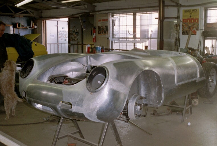

Here's a direct link to a thread with some pictures of the car in question..
mighty spyder 550

Will the car have the "drum" brakes shown in the pics?

Those pics on't show the "New" chassis... Its all 944 brakes and based on a space frame.. (IMG:http://www.914world.com/bbs2/html/emoticons/smilie_pokal.gif)
