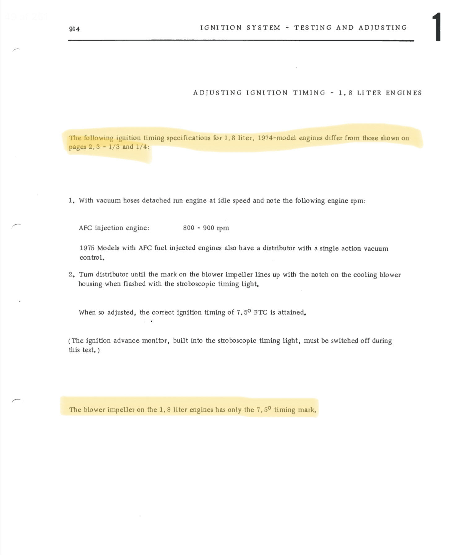

from factory manual on timing marks.
(interesting note i had never bothered to read before about new/replacement fans only being supplied with TDC mark - and is from manual dated XI 1974 (nov 1974) well after the 1.8s were introduced.)
esoteric point but looks like the way factory did it was to mark up a universal fan part two different ways depending on which car it was going in after 1974 MY. if a dealer had to install a new replacement looks like they had to notch it up themselves before installing (IMG:style_emoticons/default/biggrin.gif) (IMG:style_emoticons/default/biggrin.gif) more useless historical information.
anyway. Van & mr perrine are right. ignore all other marks other than TDC and 7.5
