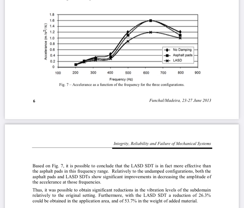

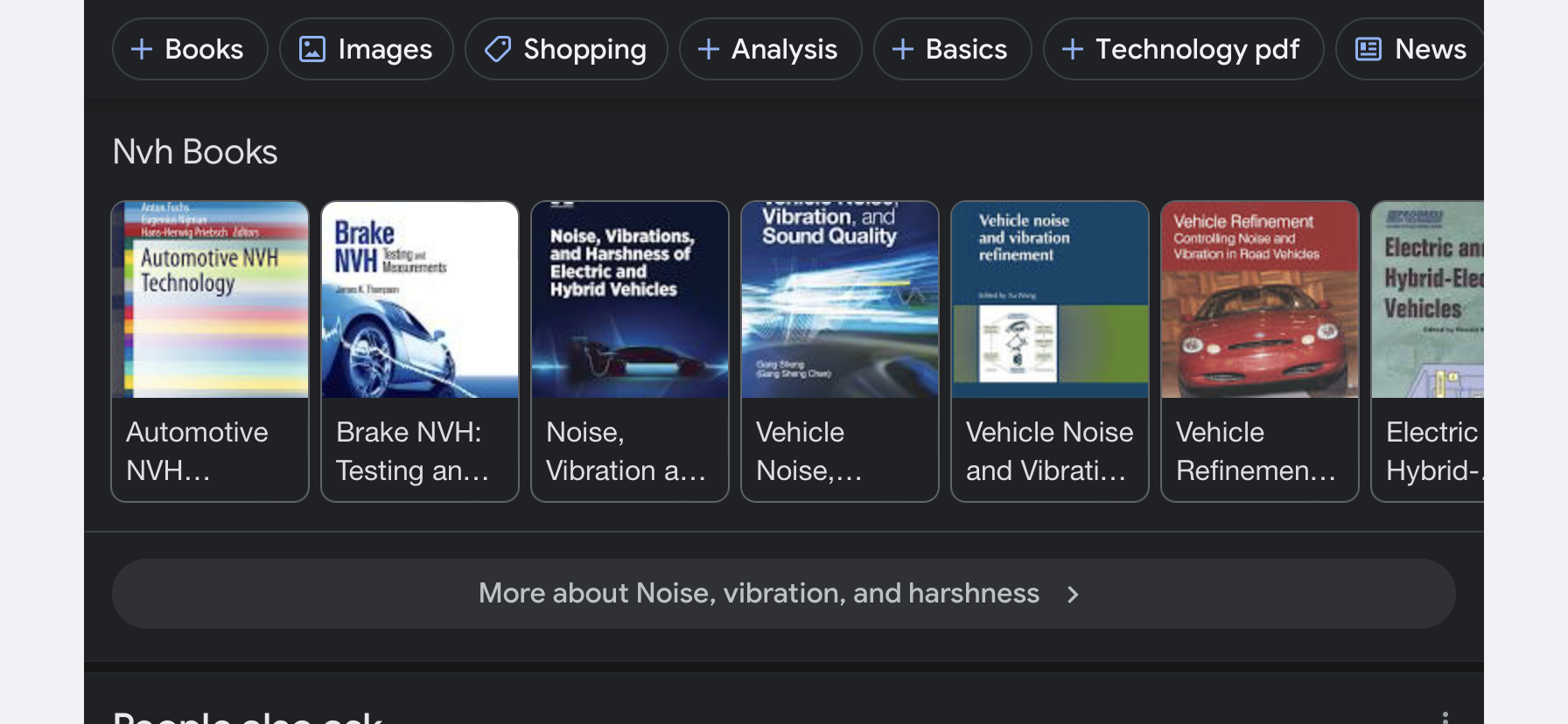

I’ve posted on this in the past so not going to do the whole thing here. Many books have been written on the subject of automotive NVH. Can’t do it justice in a short post.
What I can share is my experience having worked in that world for many years.
The OEM asphalt is the oldest and least effective solution. Liquid Applied Sound Damping (LASD) has largely replaced Bitumen sheeting. It is lighter, and more effective.

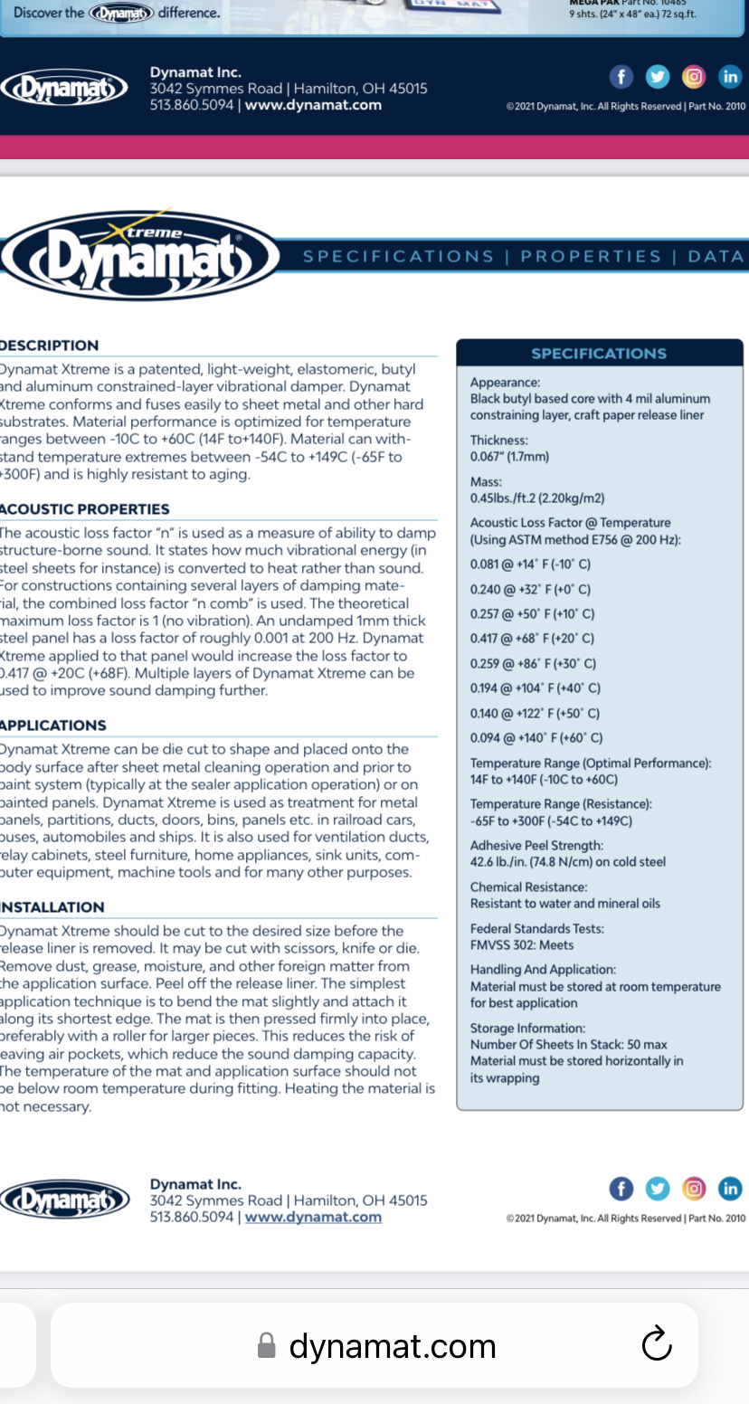

Constrained layer damping (CLD) like Dynamat is generally more effective than LASD but is costly. In OEM use it is more selectively targeted due to cost. Dynamat has sound reduction data on their website (unlike others). Unfortunately I’m not quickly finding a chart comparison of LASD VS CLD.
If you don’t believe CLD damping is very effective you are mistaken.
Here is a quick video. Notice how little butyl was applied and how big the difference is.
https://www.youtube.com/watch?v=fK2GAce4vCw
Data on Dynamat - hard to find comparable data for the Amazon competitors
All OEMs have entire departments that are focused on NVH and reducing noise. The field has progressed immensely since 914s were in production. Better NVH can be obtained with modern materials vs the heavy mass damping that was used in 1969.
