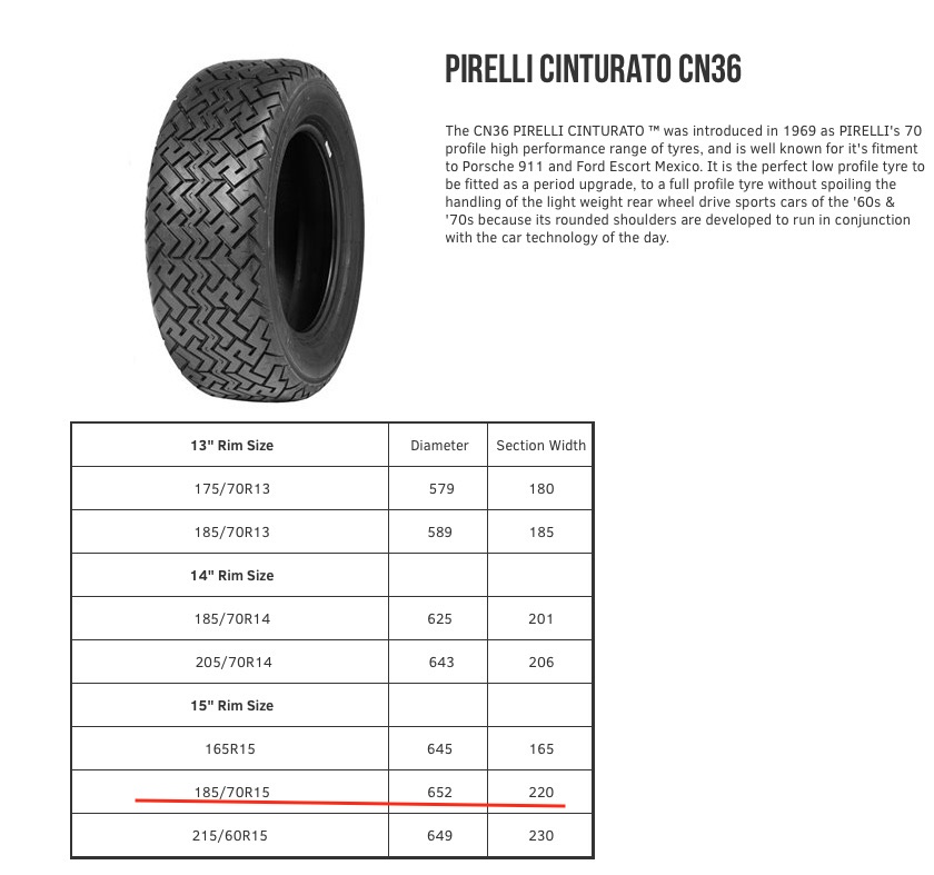

@Van B
this is the one the 911 guys use down here.
they will have a knife fight outside the tyre shop to take a set and then the tyre guy takes the winner's wallet, empties it and sets it on fire with a blow torch.
pandemic aftermath means they trickle in.
25.67 inch diameter fitted if you convert the table.

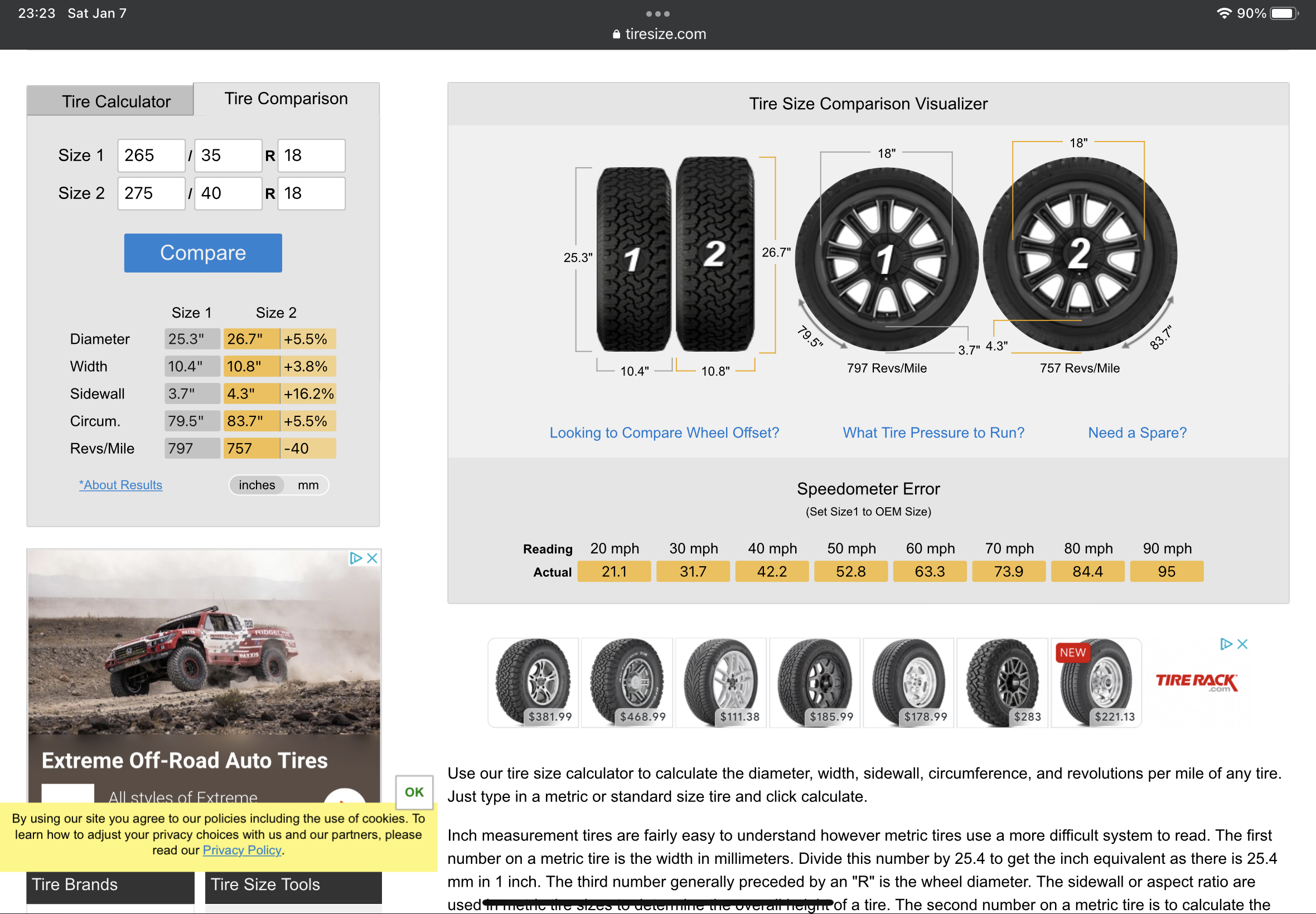

None of that is relevant until you asses your current speedometer error via GPS.
Ex: OE tire size for my 996 C2 is 265/35R18. But a 275/40R18 gives me an exact match to GPS on my speedometer.

don't understand your reasoning, in your example what you say is exact shows 1.5 inch difference in height and 5 mph more at 90mph. (IMG:style_emoticons/default/confused24.gif)
