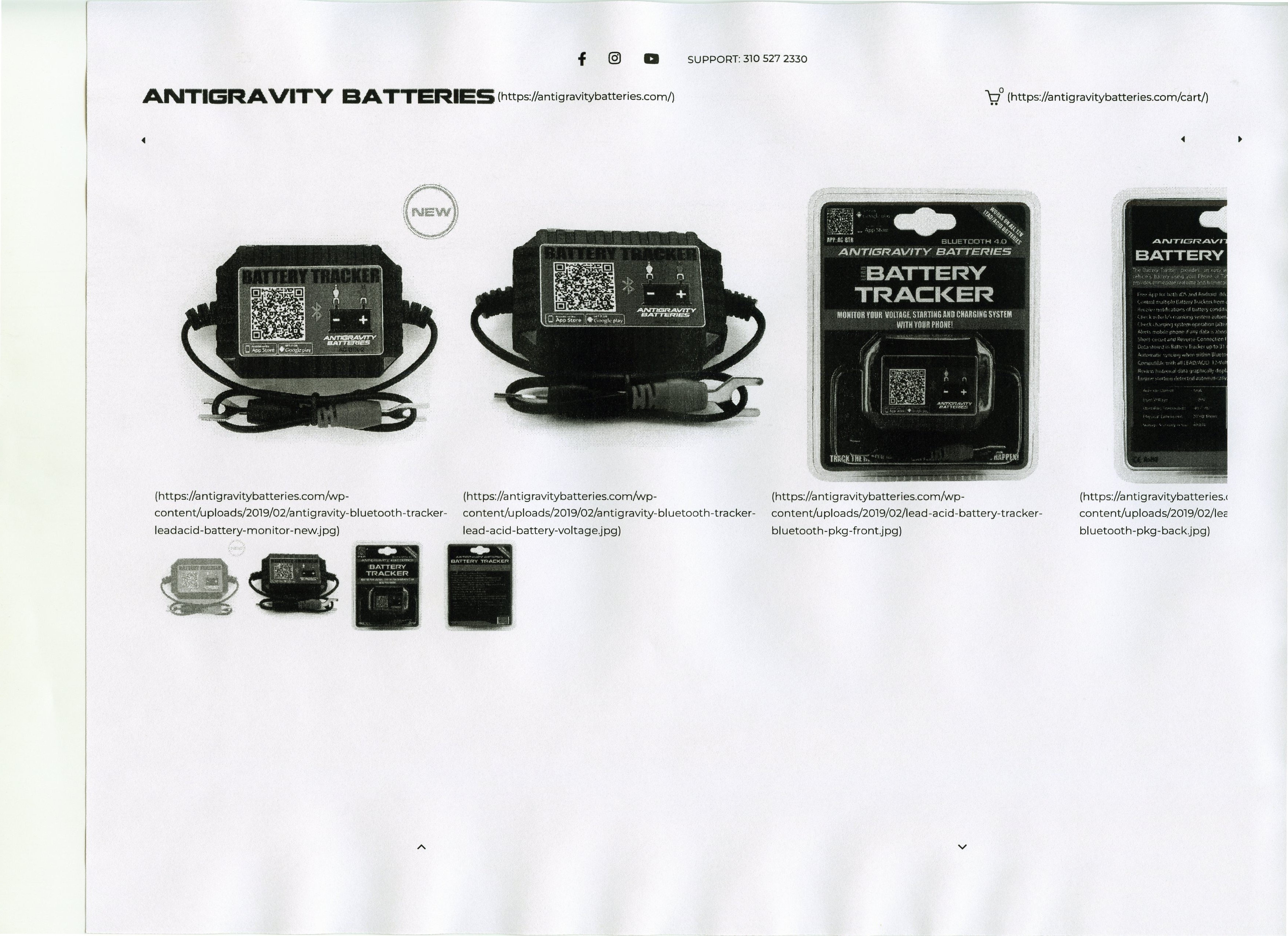

My 914 doesn't get driven much and I do keep a battery maintainer connected but I bought one of these last year and now have three of them on my vehicles. They connect to an app on your smart phone via Bluetooth and give a charging system health check. $36.
